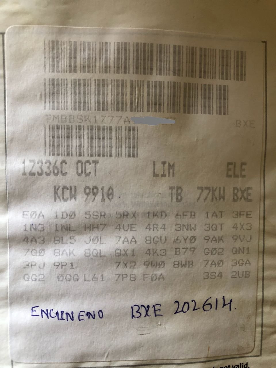

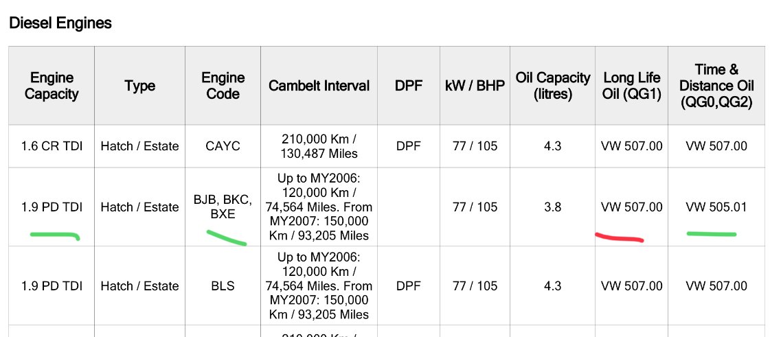

Hello Experts,
Skoda Laura (Octavia mk ii) 2007 L&K PD 1.9
Namaste from India:

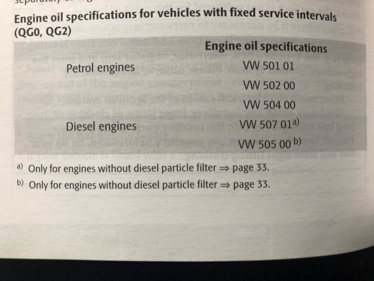

In need of desperate help, my car has fixed interval of 15k -QG2 and has 0GG(Emission standard EU4), that mean no DPF(Diesel Particle Filter).
When I refer my manual, it states Engine oil specification for diesel engine is VW 507 01 or VW 505 00
I searched the universe and couldn't find anything regarding VW 507 01, all I could get is VW 507 00.
Closest match to my search was found under(https://www.oilspecifications.org/articles/vw_motor_oil_specifications_explained.php), at the bottom of the article there is very informative logical chart and according to that, my oil specification is VW 505 01 or VW 507 00. I also read 507 00 has backward compatibility and it can be used. Agrehhh so confused!
So there is a great lever of ambiguity in the information. I checked with a local mech and he told VW 507 00 oil is best in market for PD without DPF.
I'm planning for Mobil 1 ESP 5W-30 or Shell Helix Ultra 5W-40 or AGIP EPI I-SINT 5W-40.
Please let me know the best oil grade and viscosity. I will be forever in your dept :P
Relevant images attached:
Option code in my car: ( courtesy : http://igorweb.org/equidec.aspx )
E0A = No special edition
1D0 = Without trailer hitch
5SR = Left exterior mirror: convex (AGCC)
5RX = Right exterior mirror: non- spherical (AGCC)
1KD = Disc brakes, rear
6FB = Body-colored exterior mirror housings
1AT = Electronic stabilization program (ESP)
3FE = Electric slide/tilt sunroof with sun screen/sunblind
1N3 = Speed-related variable steering assist (Servotronic)
1NL = Covers for alloy wheels
HH7 = Tires 205/55 R16 91V
4UE = Air bag for driver and front seat passenger
4R4 = Power windows with comfort operation andcircuit breaker
3NW = Rear seat bench/backrest, split folding with center armrest
3QT = 3-point seat belts with tensioner and height adjustment, front
4X3 = Side air bag front with curtain air bag
4A3 = Seat heater for front seats separately controlled
8L5 = Roof antenna and "diversity" window antenna
J0L = Battery 340 A (70 Ah)
7AA = Electronic vehicle immobilization device
8GU = Alternator 140 A
6Y0 = Without cruise control warning system
9AK = Climatronic with impact pressure control free of cfc
9VJ = Sound package
7Q0 = Without navigation device
8AK = Radio
8QL = Key for locking system with remote control
8X1 = Headlight washer system
4K3 = Radio remote controlled central locking operated from inside and safe securing
B79 = Type approval India
G02 = Front shock absorption
QN1 = Drawer under left front seat
3PJ = Electric seat adjustment with memory system right, left seat mechanically height-adjustable
9P1 = Seat belt reminder, electric contact in buckle
7X2 = Park distance control, front and rear
9W0 = W/o car phone preparation/installation
8WB = Front fog lights
7A0 = Without CD changer/CD player
3GA = Without cargo area
QG2 = No possibility of activating service interval prolongation
0GG = Emission standard EU4
L61 = Suspension range 61 installation control only, no requirement forecast
7P8 = Electrically adjustable lumbar support for right front seat
F0A = No special purpose vehicle, standard equipment
3S4 = Preparation for roof load rack
2UB = Rough-road design

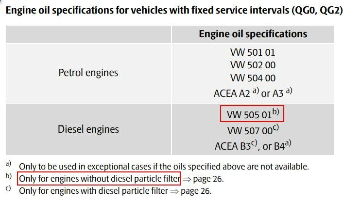

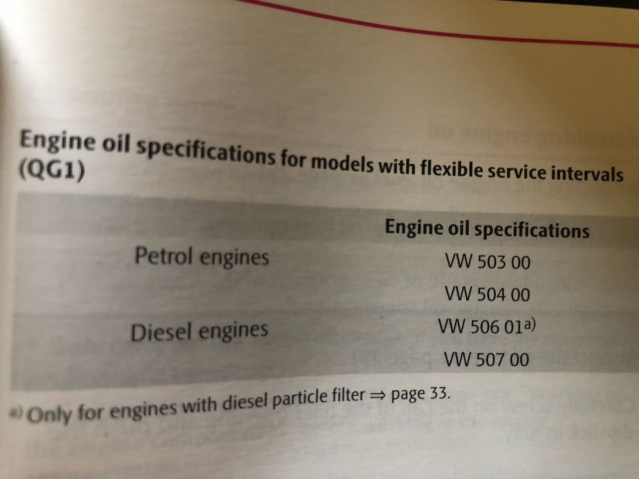

That's just a misprint in your manual. Top line with note a) should say 505 01; lower one with note b should say 507 00.
Otherwise the notes about DPFs would also be the wrong way round.
Ahh such a relief. Thank you so much.
That misprint cost me a headache.
So I'm all good to use VW 507 00?
From the specs, 507 00 looks better than 505 01.
What happens when I use long life oil (507 00) in my engine instead of QG2(505 01 Hard to source).
I read somewhere that 507 00 is backward compatible with 505 01.
TIA
If all you can source is 507.00 you are good to use with either fixed or variable servicing.
507.00 is not necessarily a better lubricant however it will have additives which help with longevity and cleanliness of combustion, necessary with regard to a DPF.
  • Sponsor
Just noticed on a bigger screen; those two notes can't be the wrong way round because they are the same. Another misprint.
The note a) in the QG1 info is against the wrong line as well.
Don't rely on that manual, check everything!
Thank You MicMac, Just so that you know my car is Indian version with no DPF in it.
So for engines without DPF, should be careful in choosing the oil.
  • Sponsor
Without DPF use either 505.01 or 507.00 for fixed interval servicing.
If the car did have a DPF, you would have to use the 507.00.
After realizing my car manual provided has many typo's, I was able to get them online in Skoda website.
My car is 2007 make, so in the 2007 manual it's given that I should ONLY use VW 505 01(without DPF), it also states VM 507 00 is ONLY for engines with DPF.
However the 2008 manual states that both VW 505 01 and 507 00 cab be used.
Just one clarification here, since mine is a 2007 make, is it safe to assume specification(VW 507 00) from a manul of 2008.
P.S I'm assuming my car is EU4, as per the code 0GG = Emission standard EU4!
TAI.
As you are in a hot climate and on a fixed service schedule I would use the higher viscosity 5W-40 oil, either 505.01 or 507.00.
The lower viscosity -30 oil may make the engine sound noisey with a slight drop in torque due to piston ring blowby.
  • Sponsor
There aren't any approved 507 00 oils with 40 viscosity at working temperature, they're all 30.  It may be an idea for the OP to register with erWin Skoda. Then he could view a list of oils approved to 505.01; which might help with finding one available locally.
Just use 507.00 and change every 10,000Kilometres (yes, early) or 12 months - whichever you hit first
