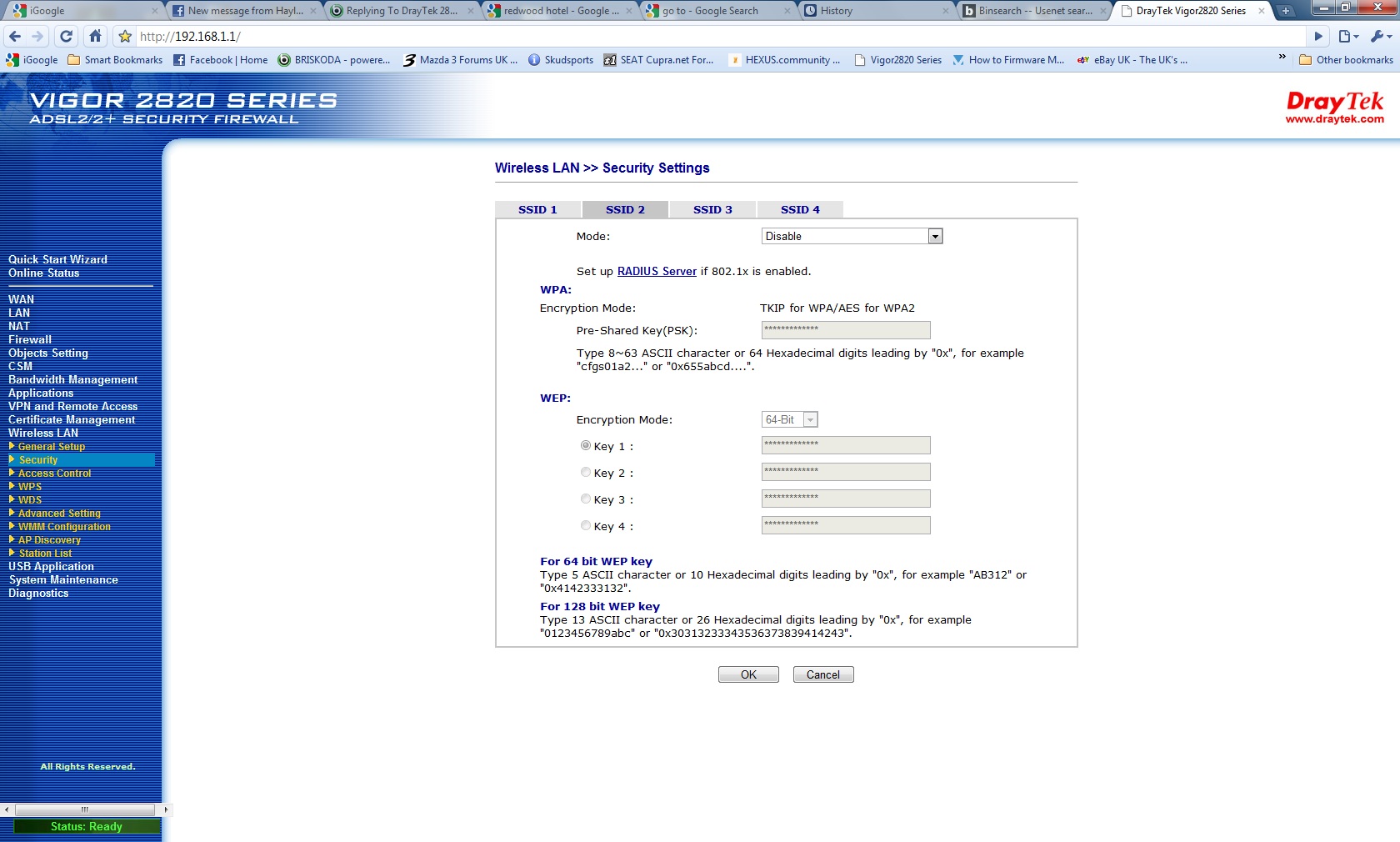

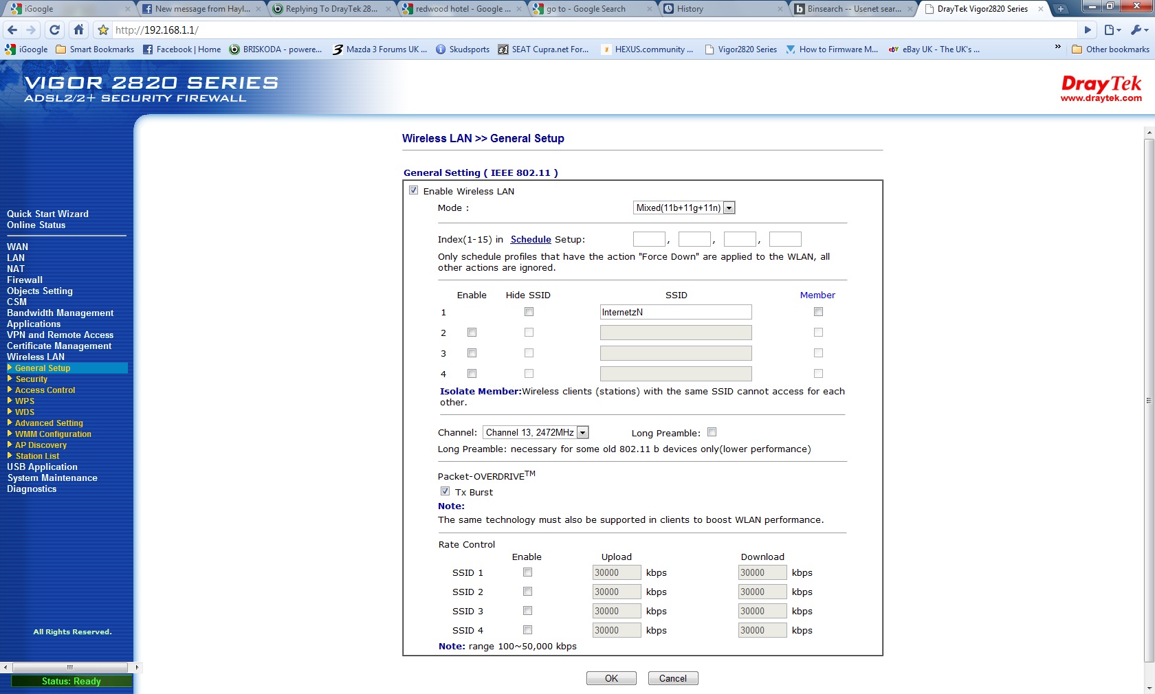

Can you confirm that the 2820n can run two seperate WLan SSID's one with WPA2 and one on a seperate VLAN and locked down on WEP?
That would solve an issue I have with phones etc.

Just to confirm the 2820 will do multi SSIDs with separate security, scheduling, rate limiting per ssid, QaS and mac filtering and lots of other stuff ive not looked at..
Couple of screenshots... let me know if theres anything specific you want to see
Cheers Col.
