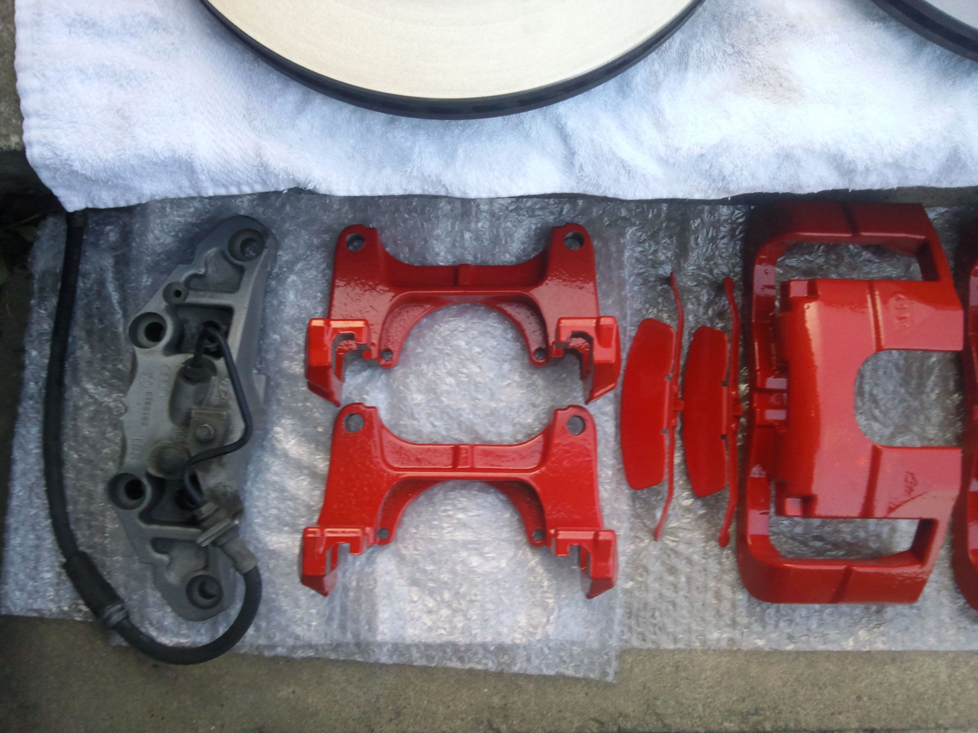

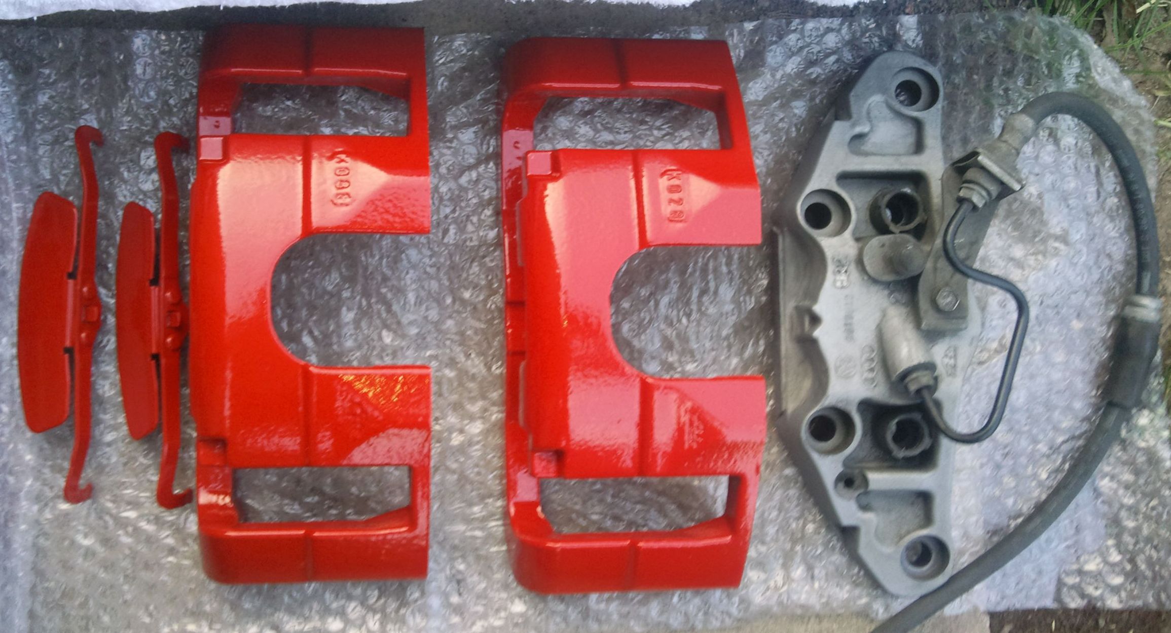

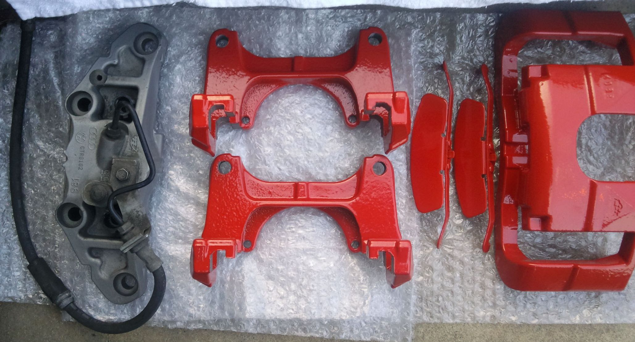

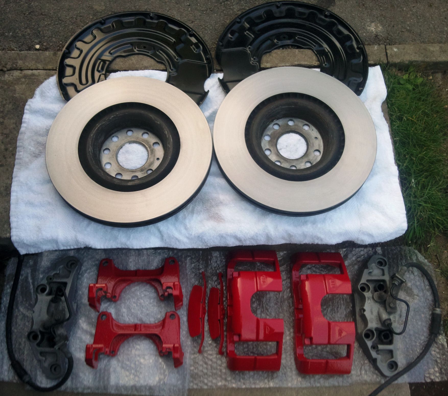

As promised some pics.Fingers crossed should be on the car tommorow. :thumbup:
