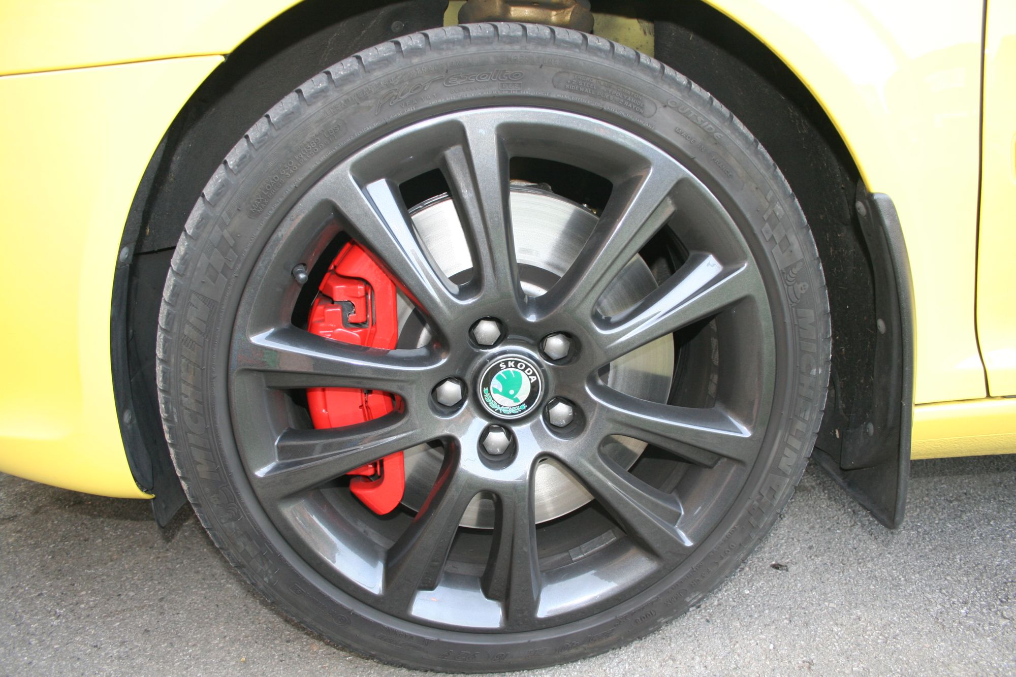

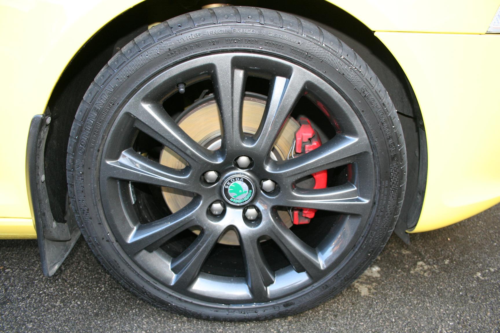

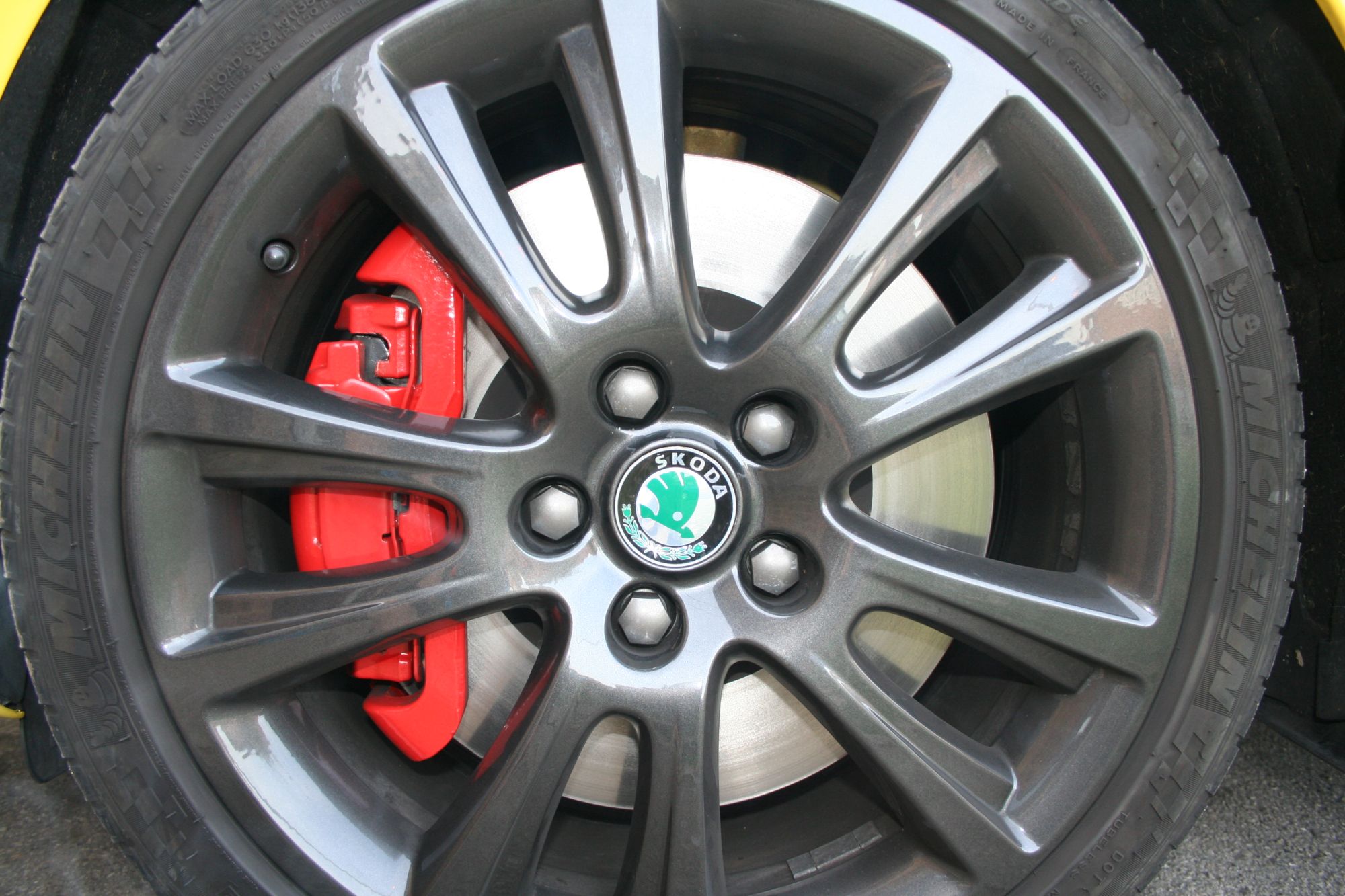

Finally got round to having these fitted Leon cupra r Discs and Calipers 345mm Dia.Thank you to a fellow briskodian for selling them to me. :thumbup: (Mr Hedge).They where a little dirty for my liking so had them re powder coated and i skimmed the discs,Still loads of meat left on them yet.All i can say is christ what a difference wish i had done it sooner. :wonder: .Also changed the brake fluid to AP 550 so touch wood no more brake fade.

The rear upgrade involves only vented discs on the R32/S3 and also a bigger pistoned caliper which can take away some of the initial snatchiness.

You need the Cupra R calipers and brake lines, carriers, pads, the whole shebang.
