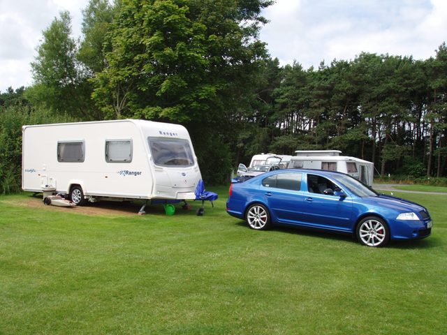

Myself and family are currently on hols in northumbria after traveling 200 miles mostly on the A1, We returned 23mpg which doesnt sound a lot but when you consider the vrs in question is producing over 260hp i dont think it is bad as i am only getting around 30mpg normaly. the vrs sat on the A1 in 5th gear all the way with no probs could have put her in 6th but it droped the rev band down just out of the nice power band ive found for towing (hills NOT a problem for her just tickled the throttle and she pulled like a train even suprised some cars as we overtook them and they say caravaners slow trafic up not us! lol)The caravan in question is a 2009 bailey ranger 510/4 weighing in at 1023kg unladen and 1250 fully laden giving us a calculated 87% towing weight. i run a nose weight just over what they say at 80kg its only 5kg over but its balanced perfectly with no swaying or pitching. Bring on more hols!
