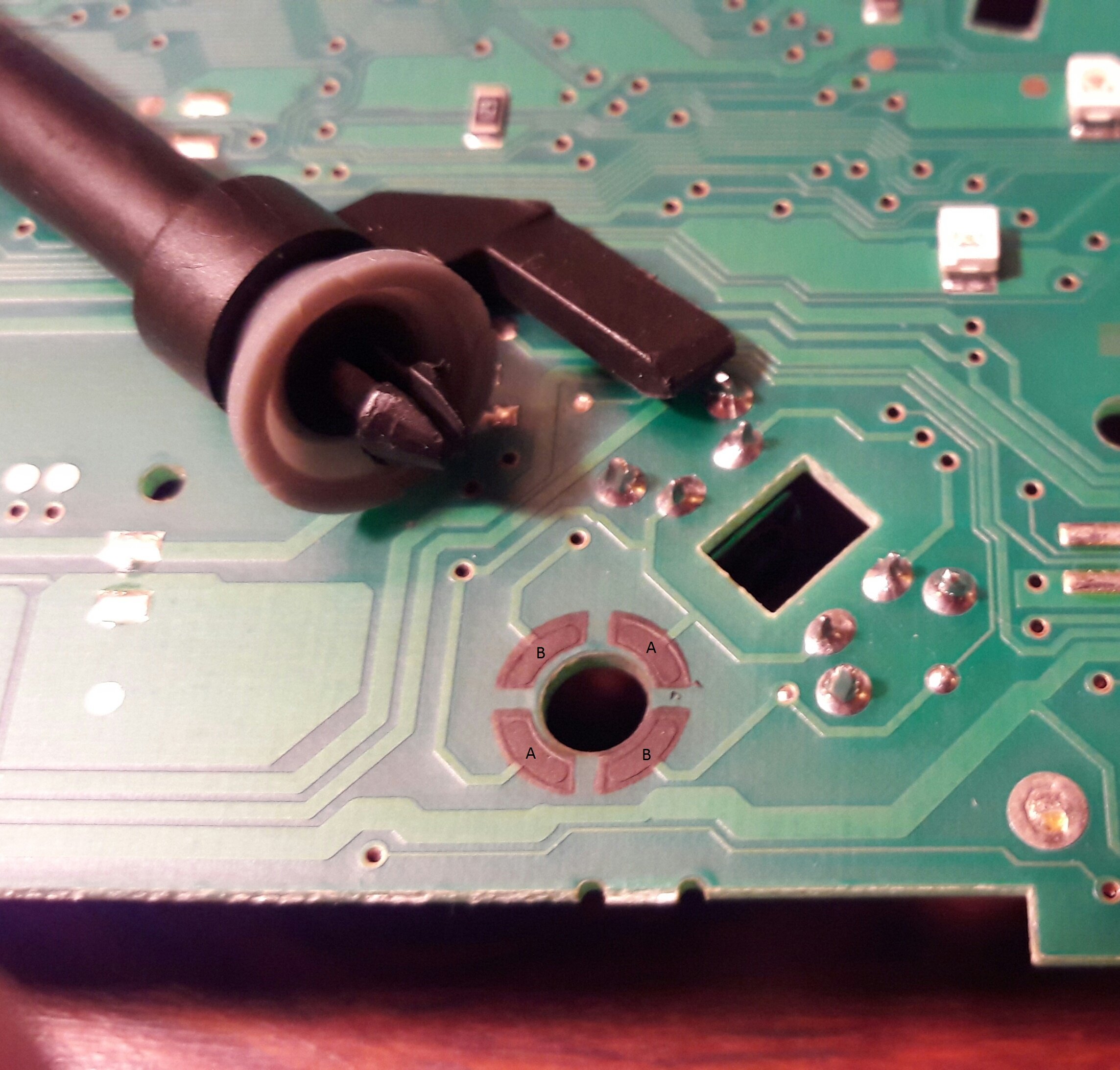

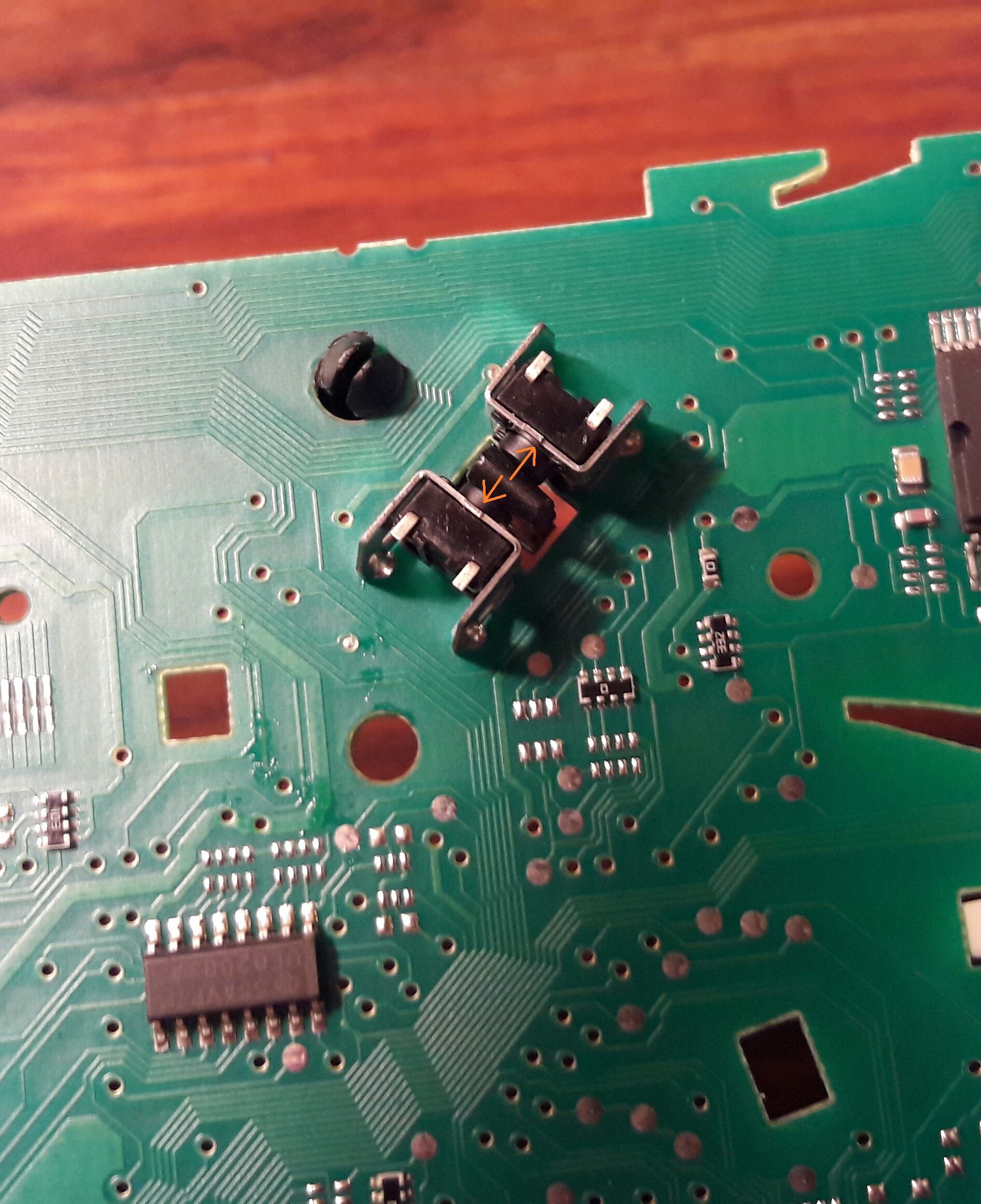

Here's how it seems to work.  First the twisty, clicky, time-setting action.  The peg that you twist has a leg that sticks out sideways a bit at the bottom, and passes through the PCB and rotates to hit one or other of a pair of little click switches:
The push-in, trip zeroing action depends on two pairs of coated pads on the PCB being contacted by a coated ring on the rubber gaiter at the bottom of the peg. Apologies for the blurry photo of the peg.  So each of the 'A' pads are linked together by tracks on the board, as are both of the 'B' pads, so to get a push registered by the micro, an A pad has to be linked to a B pad by the conductive bit (inside the red ring) of the peg's gaiter.  You can see on this one how some of the conductive ring has come away.
Not sure quite what to suggest for repair, ideally you'd clean the black pads on the PCB with some isopropanol and replace the peg with one off a less-used set of clocks.  I've got some 'spray on carbon' at work that I could have a play with, but I have my doubts it would stick to flexible rubber very well?

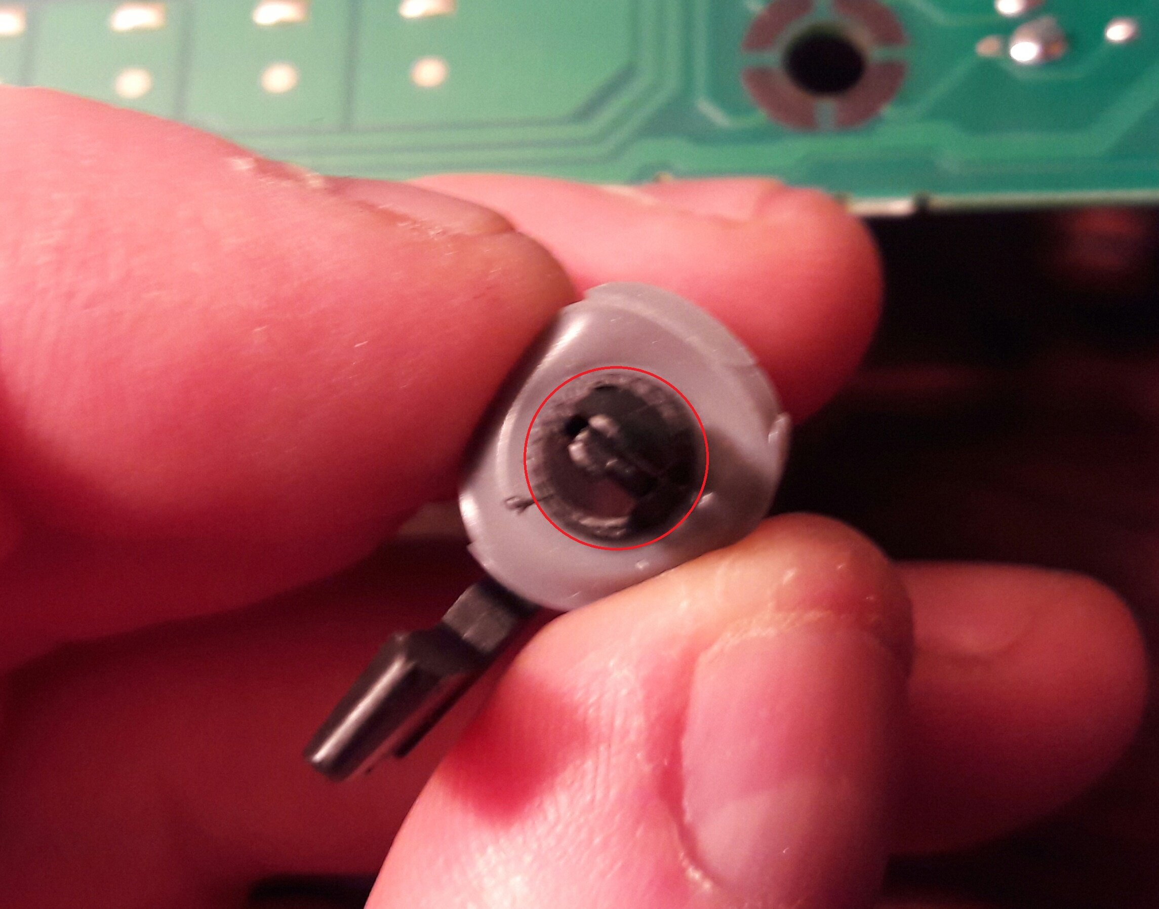

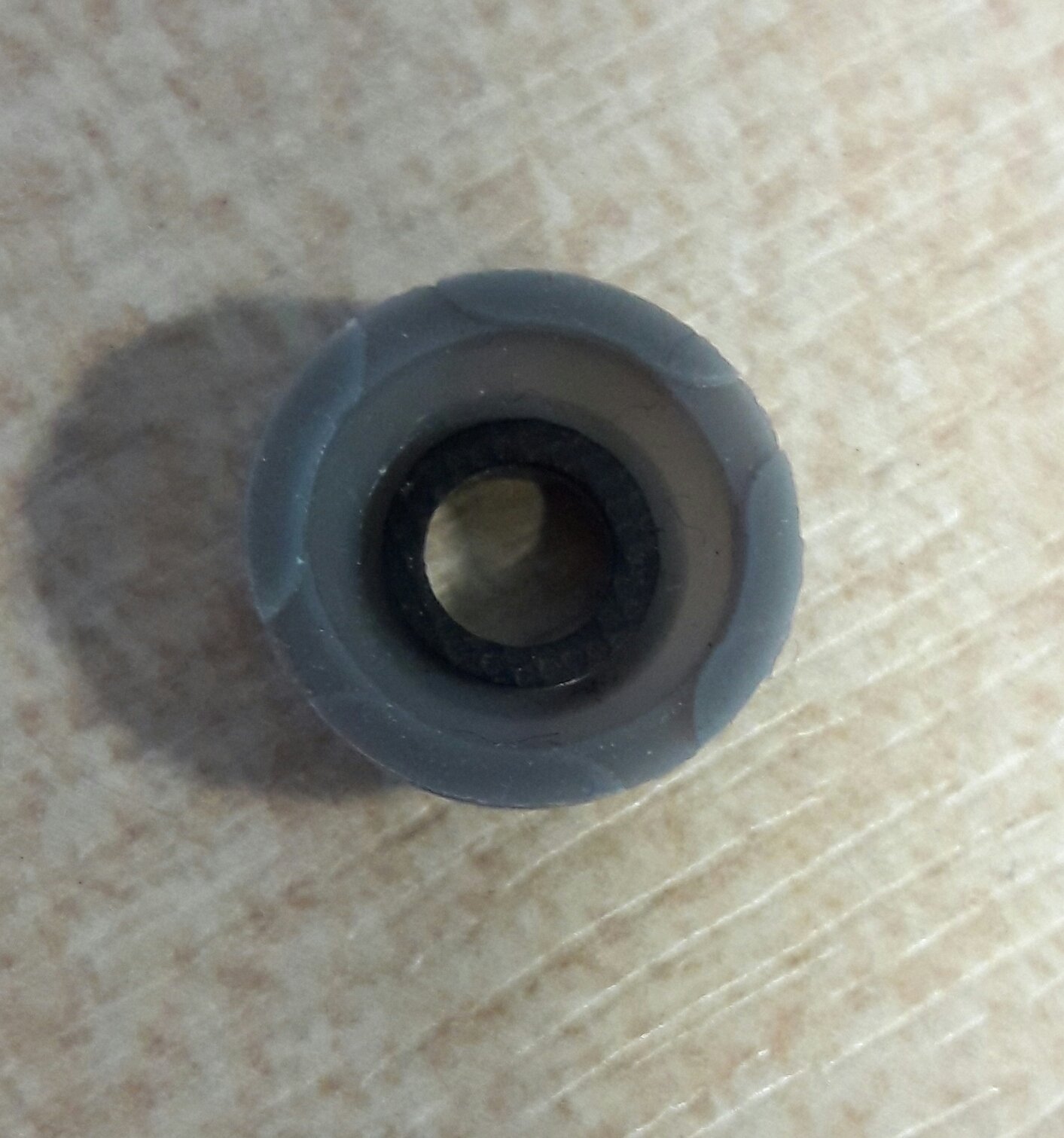

On looking closer (microscope!) at the little grey rubber gaiter at the bottom of the peg, the conductive-coated ring looks completely intact.  So I think it must just be a dirt issue that stops these working when pressed in, which a clean of PCB surface and this bit ought to resolve. Easier to photograph (and clean) when removed from the peg:

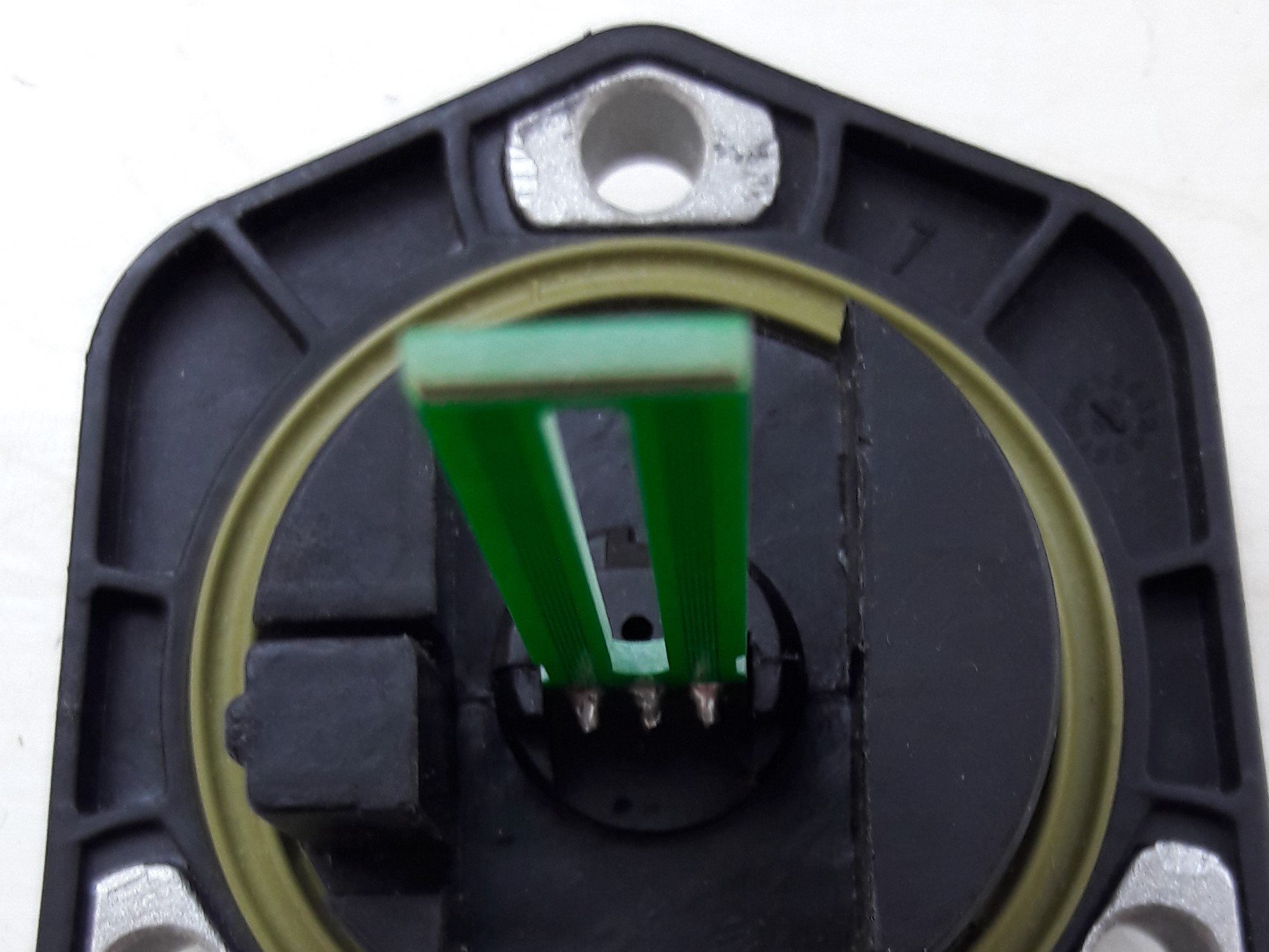

The innards (under a plastic cover with some in and out holes at top and bottom) look like this:
^ That's as oriented inside the sump.
The crap blurry photo doesn't really show that on each side of the circuit board there is a super-thin track, buried within the layers, in a Ziggy-zaggy pattern like this:
Is this not just what I used to describe years ago, ie a low oil warning unit?  Current gets passed through two areas, when the current is equal in both circuits, the oil level is okay, if the top one is in air (oil level low) the currents will not be the same as there is nothing to cool the strip?  Now if that is true, how these systems do provide varying oil level measurements in mm of oil, I just don't know!
The forum software rotated my second pic.
The ziggy-zaggy tracks are vertical, either side of the cut-out (indicated by the dotted lines in my diagram).
So whatever is going on, is going on the same to the left and right halves of the sensor.
Gonna take it into work tomorrow and see what a 'scope might see at the outer pins when the thing is powered up.
You can see the buried tracks slightly better in this image:
