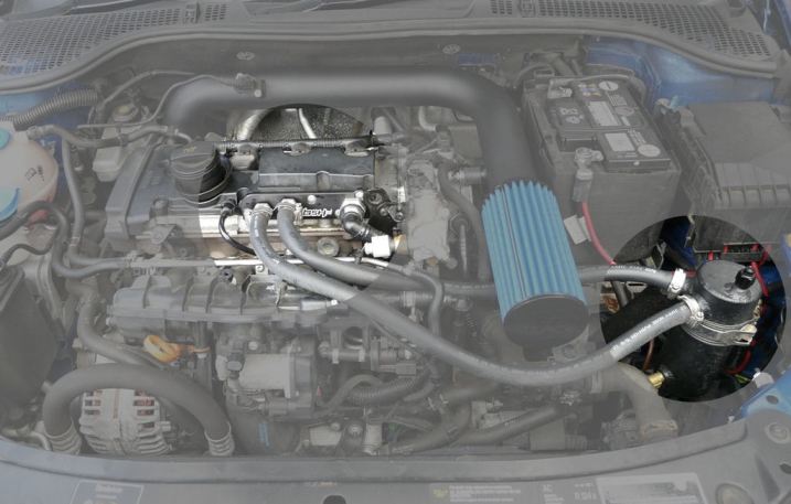

Here is the Jetex/JR filter fitted:
I haven't got VAGCOM so no logs I'm afraid, but the Jetex one sounds fantastic, shame I didn't get chance to drive with the pipercross on.

What are the bits I've highlighted mate?
Edited by Pagey1255
Standard engine cover and uprated filter FTW :peek: :giggle:
Pagey1255,
It's a BSH High capacity catch can, I got it from a group buy on mk5golfgti.co.uk. It supposedly stops the intake valves from getting gunked up, which can be a problem on direct injection engines.
Edited by Bogwoppit
Thats the large capacity BSH stage 2 catch can PCV revamp.
