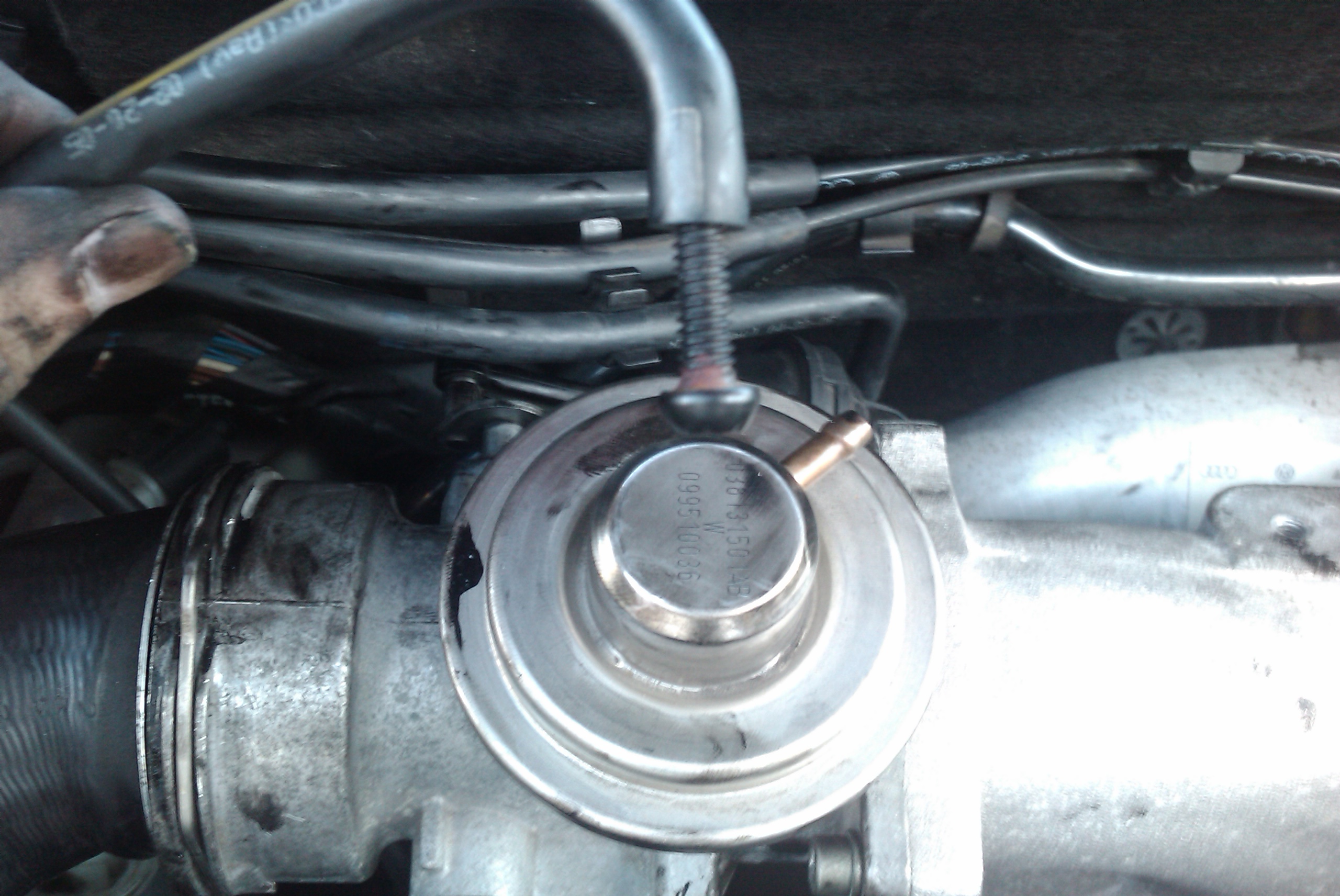

ok done this but just to ease my mind what does the rubber pipe thats connected to the side at the back of the EGR(plunger) do?
is this right?
is this right?
yes but..
use sumthin smooth to blank it as air can escape round the spirals...and there is no other rubber pipe connected to the egr...theres a metal pipe connected underneath it that carrys the exhaust gases...(how it is on my 2006 blt engined model).

on asz engines iirc theres two vacuum hoses ;)
:wonder:
what does the other one do?..cant carry exhaust gases..
ones on the top and one goes to a plunger valve on the side at the back ;)

but doesnt the one on top open the plunger?
+1 :yes: :yes:
thats where im confused cos the one on the top dunt seem to do much when u excuse my wording 'suck on it' bit when u suck on the rubber connected to the plunger the plunger moves
argh which one do i remove haha, i think we need to solve this and get some descent fotos up for everyones sake
Egr delete ftw
Done it on two asz engines now ;)
i only know bout the one on my car which has the BLT engine...you cannot see the plunger move on mine as its inside the egr....
The ASZ engine has two vacuum lines to the EGR, as one controls the EGR, the other controls the anti shudder valve which on the ASZ engine is part of the EGR assembly.
On BLT engines, the anti shudder valve is an electrically controlled unit that sits in between the EGR and the top boost pipe.
So is it possible for the anti shudder to fail on an ASZ and not throw up any lights, whilst the EGR keeps working fine?
How bad is said "shudder" and when would it occur.. Low and high revs perhaps?
Is the anti shudder and anti stall the same thing?
