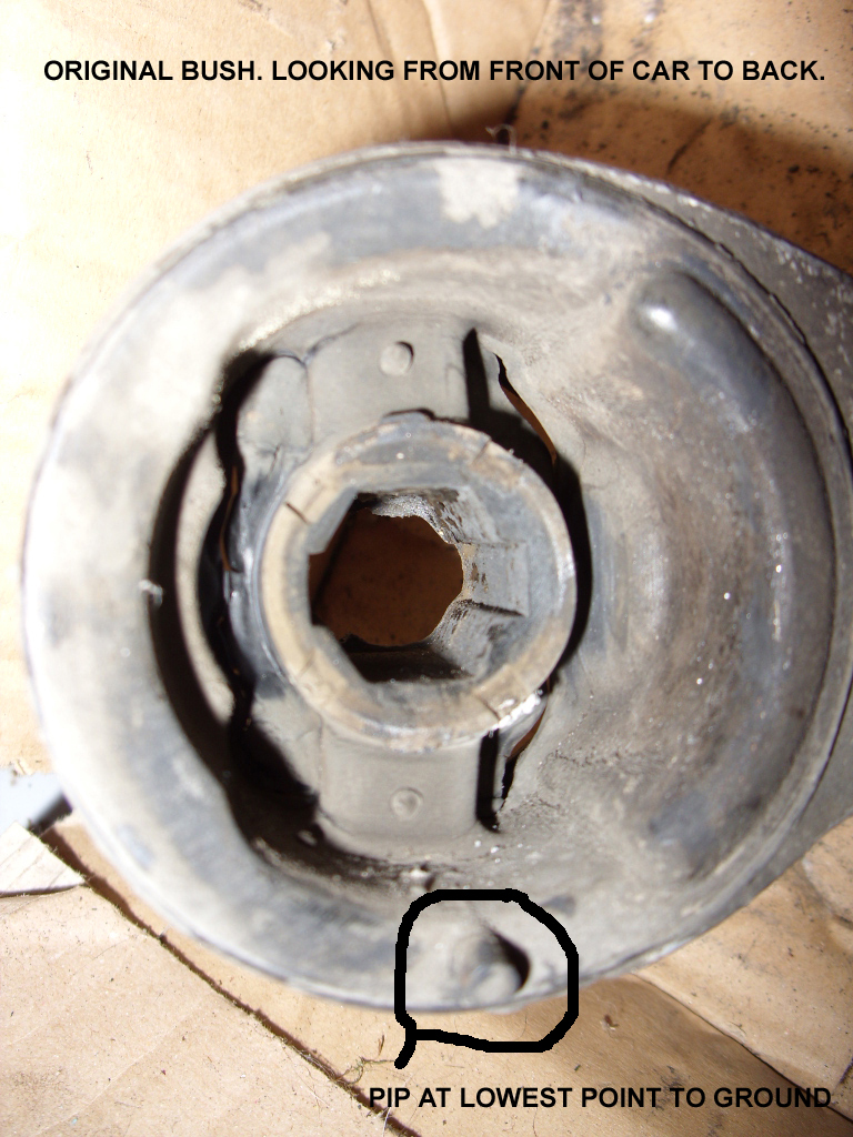

Old type Skoda bush attached (photo).

ye ok but the cupra ones i have, have pips in four oppersite points to the outer of the bush it also has a solid metal hexagon collet with 2 pips which line up with two of the outer ones (these 2 pips i think indicate the old wider part of the hex in the old bushes).
there is no wider parts to the hex like your picture has. (oh and it should say "looking from back to front") :giggle:

These "wider" bits are just where the rubber has been relieved to make pressing the spigot end of the TCA a bit easier. The Cupra one being a lot heavier duty will not have these relieved areas - and that is one reason why the spigot is a bit harder to fit into the bush. (on second thoughts - can't remember - it could be that I'm wrong and the hex section of the spigot might have horizontal flats at these points)
No, that view is definately looking "front to back" that is the recessed end that you are looking at - not the rear "flat" end.

oh ye lol i forgot its at the back of the console sorry :rofl:
but im guessing im right with lining up the 2 pips on the inner on left and right of wishbone pinion.
