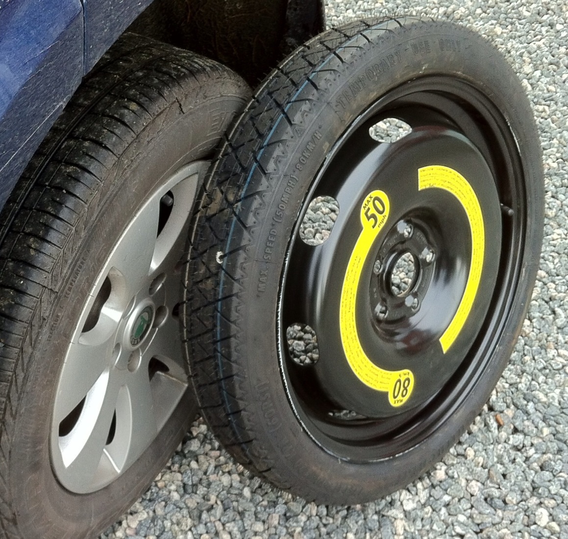

I went to a large Skoda dealer today and argued a bit. To make a long story short, the parts department suddenly said that they had a thin space saver from a Supberb (he thought) from years back, and told me I could try it on my Yeti. Then I took it to a tyre shop and got him to put it on. It turned out to fit 100%. Didn't touch the brake calliper, just turned nice and easy.

The rim is coded: 8 1/2 J x18 H2post-95814-0-06951600-1349358564_thumb.jpg
Not Type Approved for a Yeti, so in the UK it could not be used.
And I would be very worried about the load rating of that tyre/wheel combination.
I guess it's not approved here either. But it fits, and it takes up minimal of space in my boot. And, if I get a flat, it will be used for a few miles only. Finally, if it's good enough for a Suberb, it's good enough for my Yeti :-)
