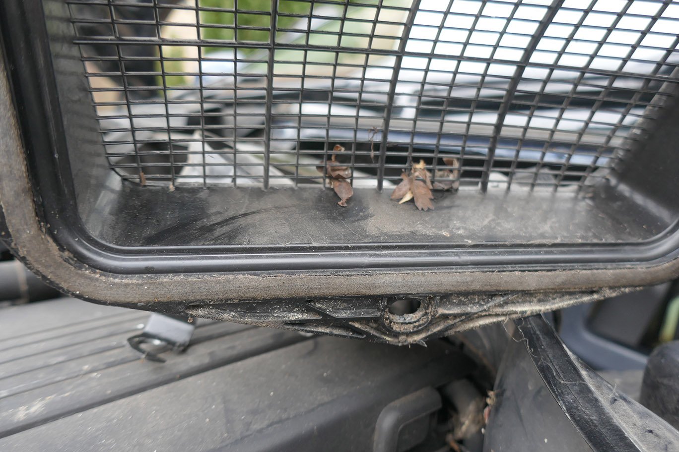

I just used this stuff...black so if any squeezes out it's not instantly visible like white silicon sealant...either should be satisfactory to provide a seal though. I just covered the existing seal (which was visibly wet at the bottom when I initially removed it to inspect) with a line of the sealant and replaced the cover.
Make sure you clean the two surfaces well first to ensure it seals nicely.

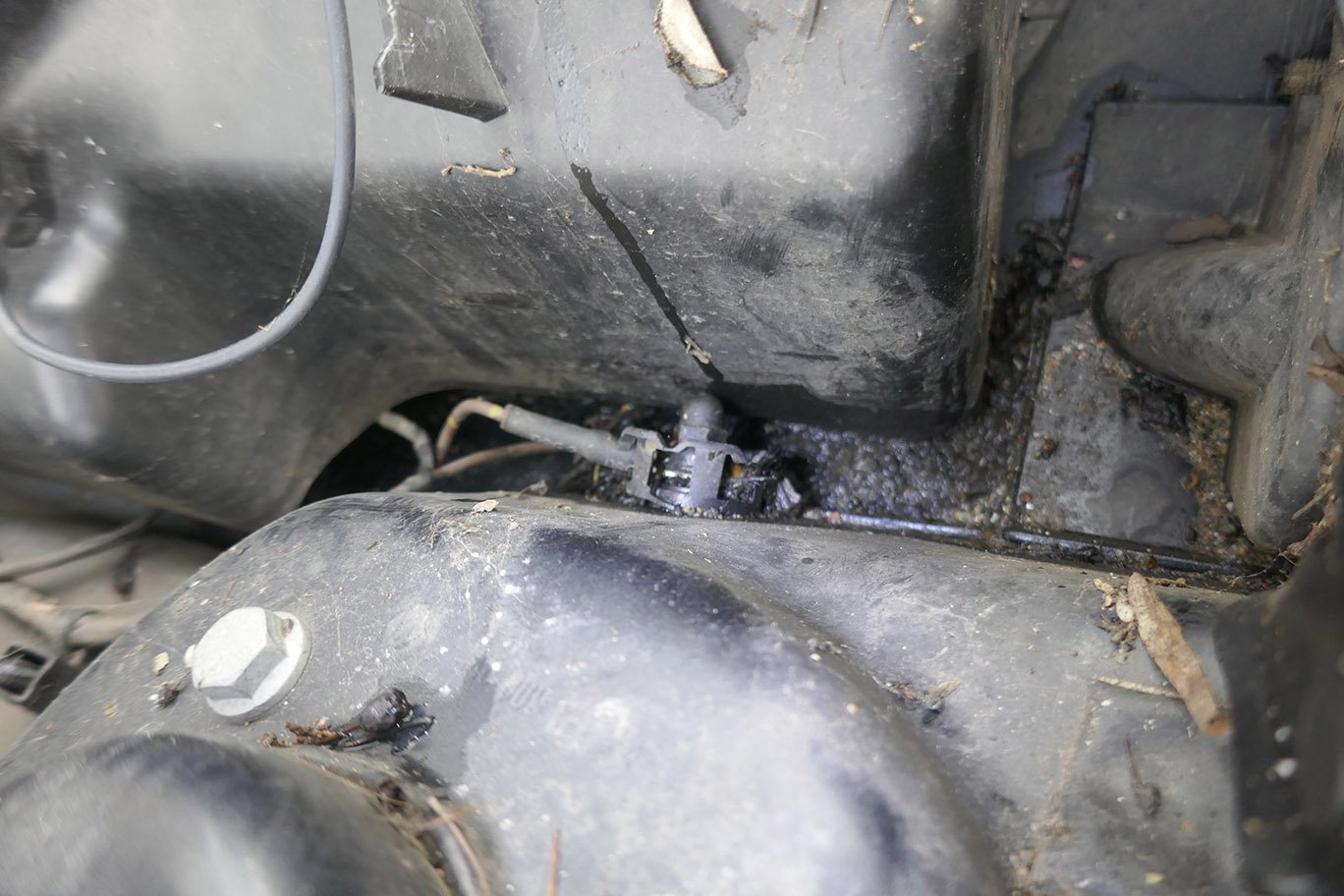

Inspected - filthy, lots of gunk.
Spent a good hour clenaing. Degreaser, wd40, more degreaser.
Tested drainage hole by tipping in 1/2pint of water and watched it all drain away nicely and exit by mudflap.
Dried the whole area. Sealant applied to plastic cover (which was also thoroughly cleaned) and then refitted.

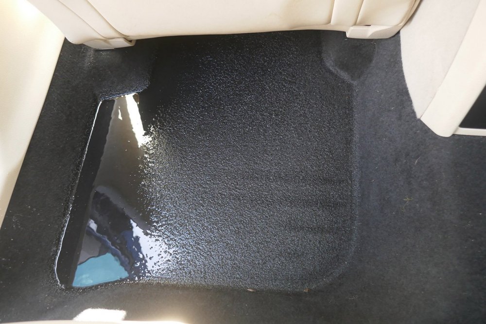

When I initially removed the plastic mesh cover, the lower part of the seal was visibly wet and obviously not doing it's job properly.
Explains why the passenger and rear footwell were saturated. Never had any problem up until last week when I noticed some wetness on the mat...I put it down to water from my mates boots as we'd just been out in the rain all afternoon. Didn't use car for a couple of days and then when I got in to go to the supermarket, noticed a puddle in the rear footwell. (Horrified as you'd expect!)

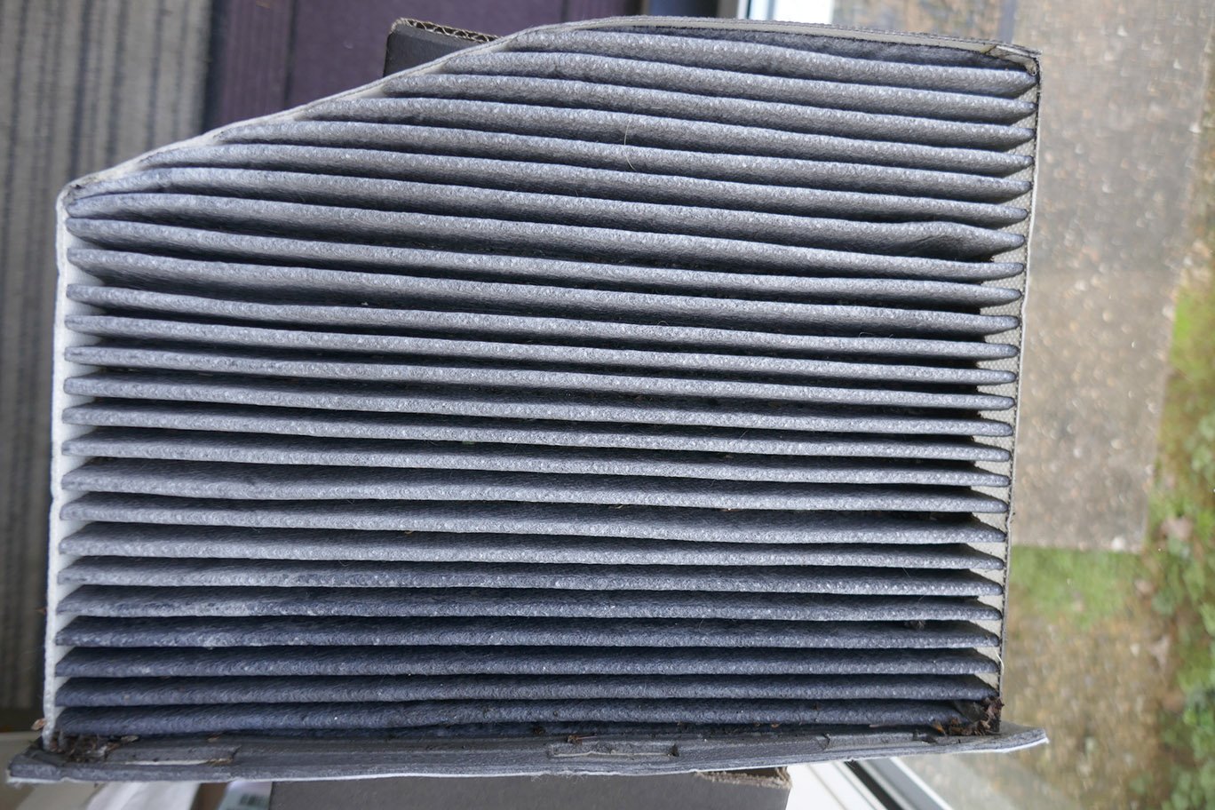

Noticed water droplets on the carpet by the footwell lamp/bonnet release (tell-tale sign it seems). Removed cover beneath golvebox and saw droplets hanging from wiring coming from heater/ventilation fan. Fan removed and dirty water spilled out. Pollen/cabin filter removed and lower 1/4 dark and damp. It wasn't in bad shape and was date stamped which matched date of my last service. I know from reading threads on this topic that some have moaned that their service techs have skimped on replacing this cheap part (£8.24 carbon jobby from ECP with regular discount code), so thanks Truscotts Skoda/Helston.
Fan has been doused in wd40, new pollen filter fitted and the carpets cleaned and sucked dry with a new VAX platinum carpet cleaner...back to dry and fresh in the cabin again.
