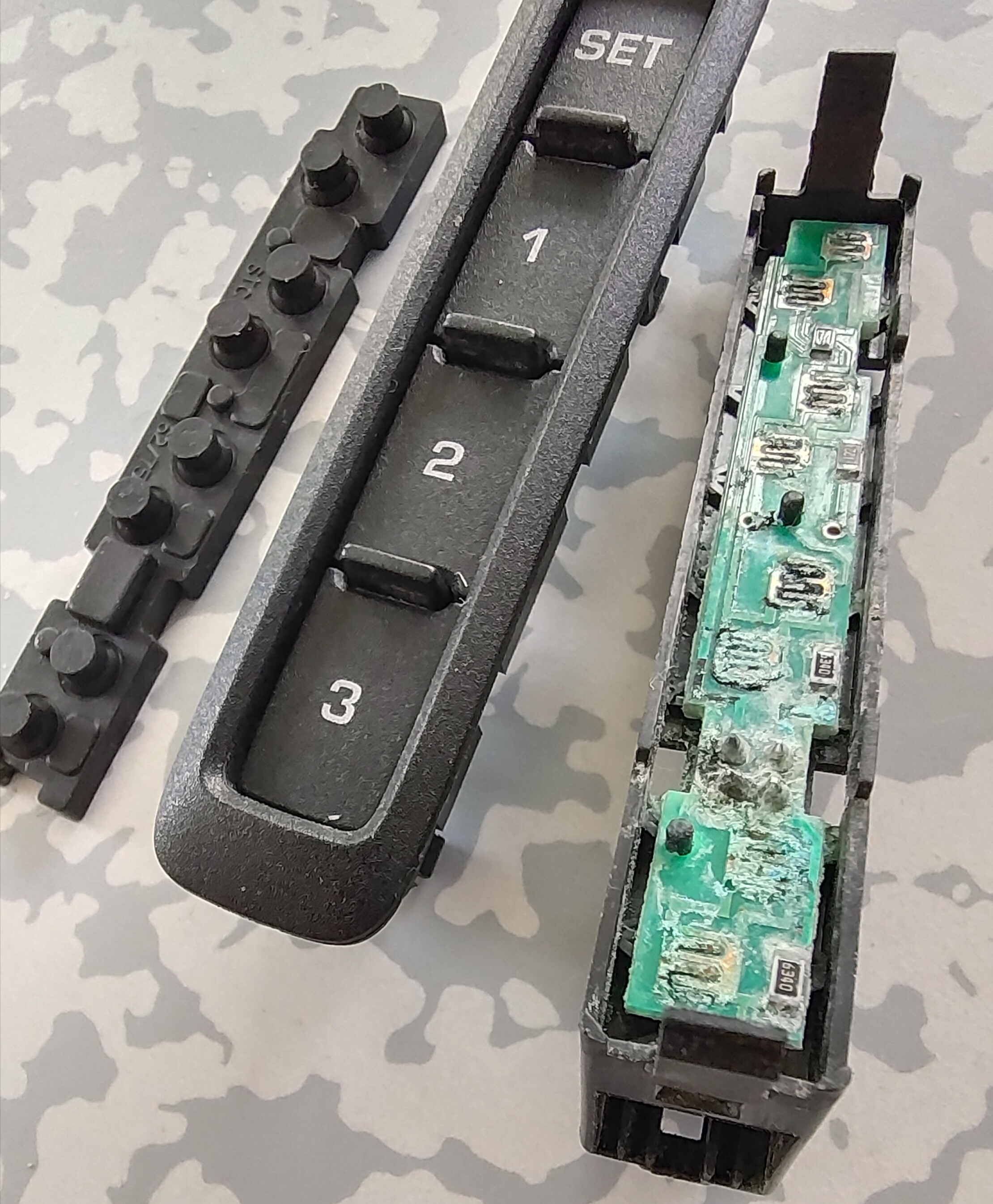

drivers seat moves on its own while driving
Salad_Fingers replied to sagaer's topic in Skoda Octavia Mk II (2004 - 2013)

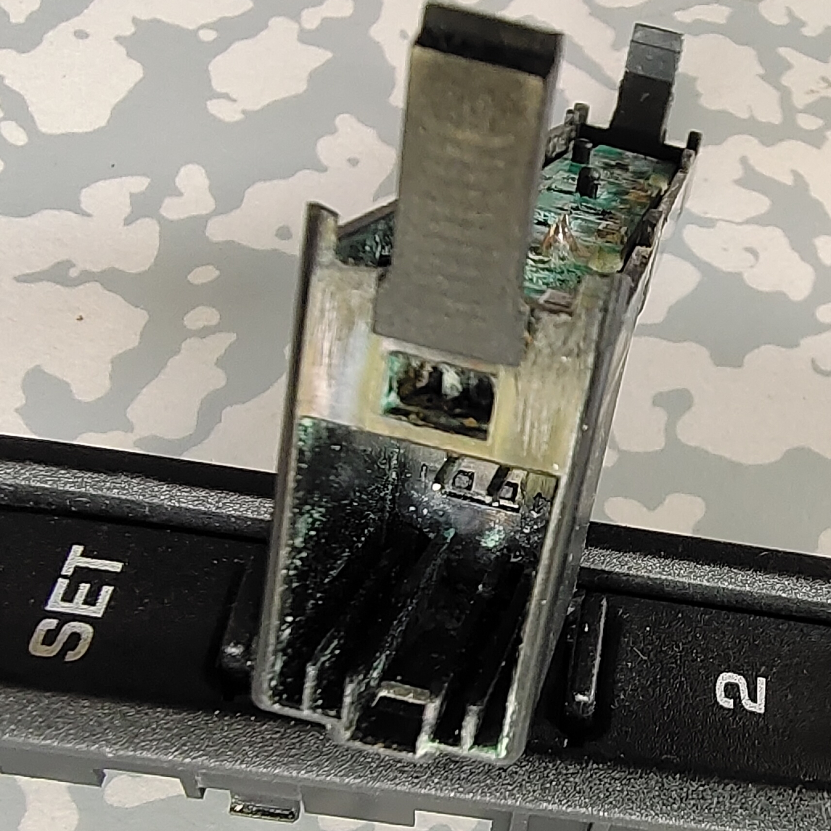

Had this issue the other day after I'd left the windows open 1 inch overnight... of course after a fine day it turned out to be the wettest night of the year and I woke up to find that some rain had got it on the seats and doors. The following day my driver's seat started playing silly buggers as I was driving down the road. Next day, flat battery. Followed wiilydog's advice and popped the seat memory switch out... sure enough, signs of green oxidisation on the circuit board. Obviously not something that's happened overnight, more the straw that broke the camel's back. Battery recharged and 24hrs since the switch has been disconnected and thankfully the seat has stayed put. Electrical contact cleaner and a good clean-up will hopefully sort the seat memory switch... will post results later. Before I had disconnected the switch I tried resetting the memory buttons but was unable to. When pressing 1/2/3 only #2 worked. -

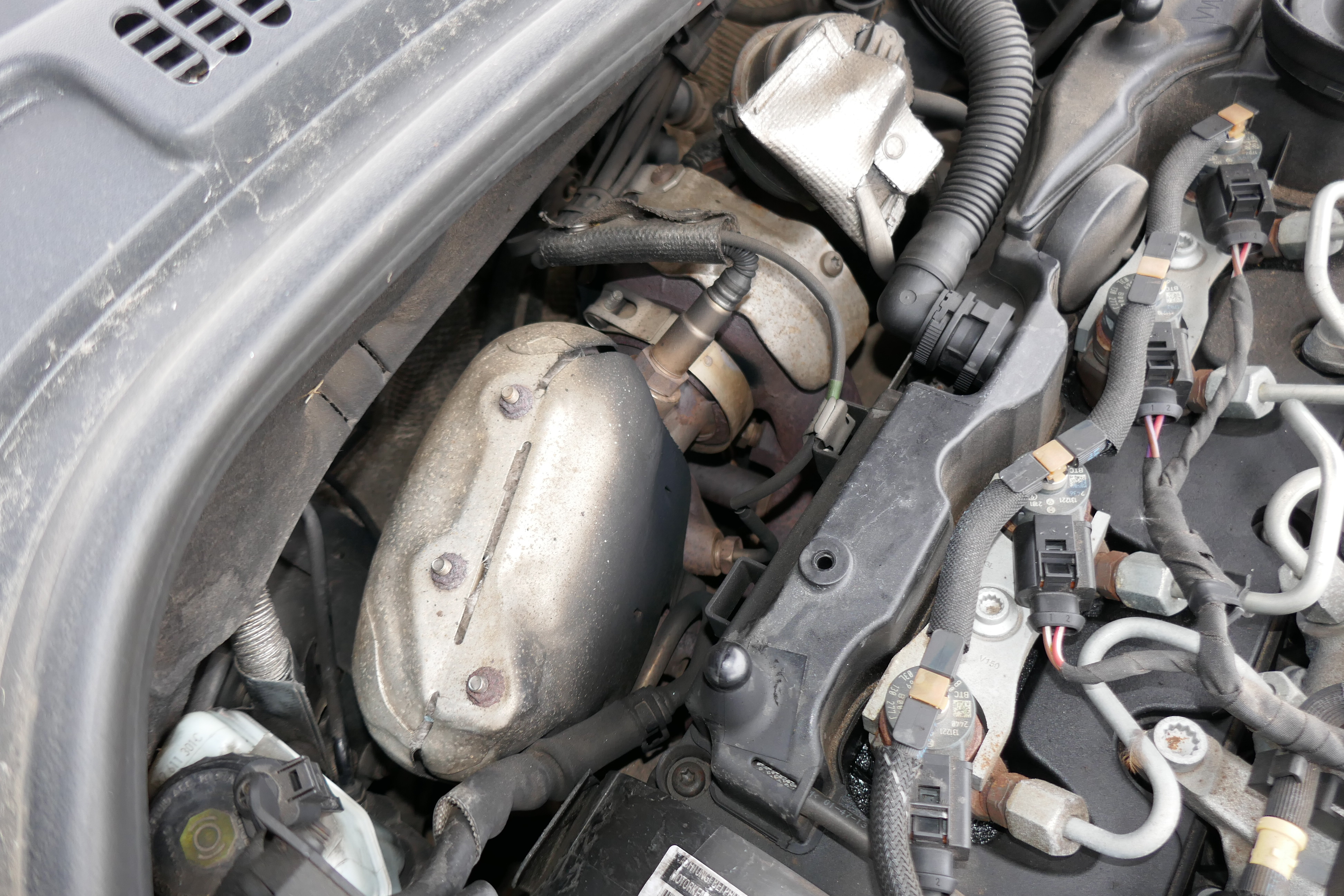

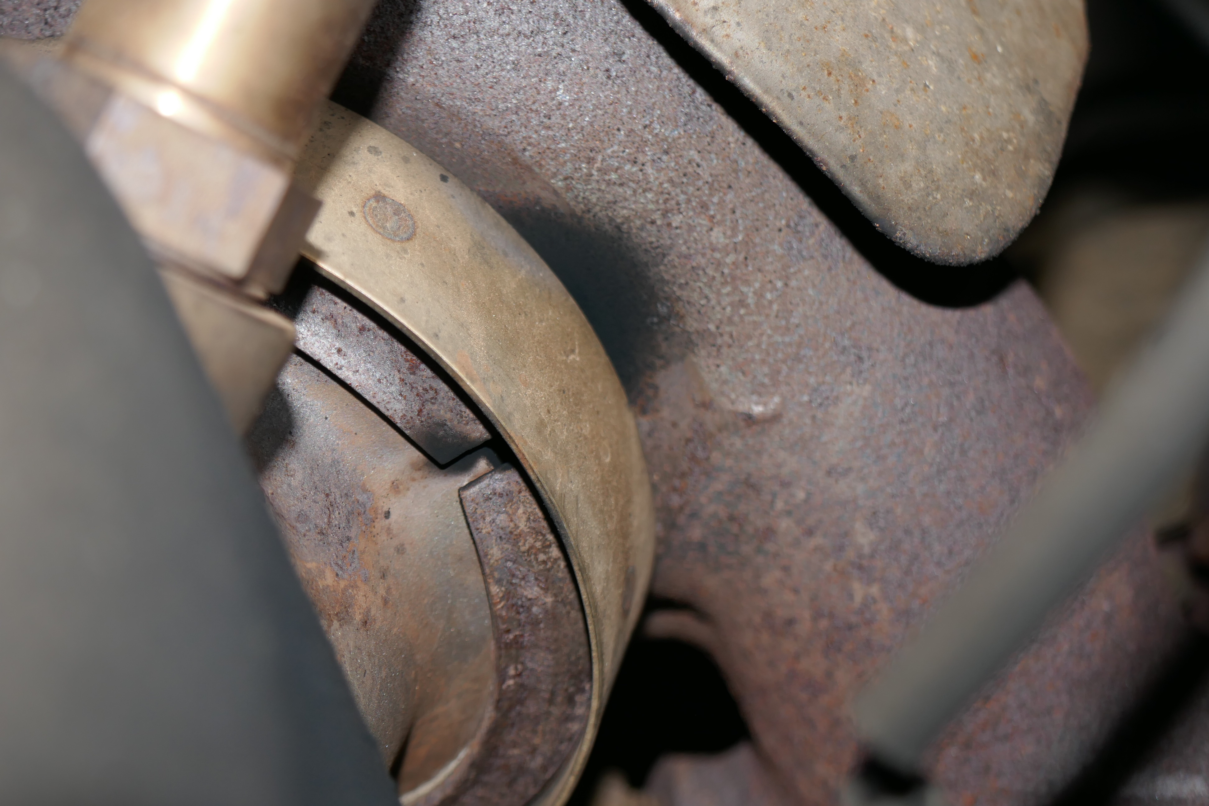

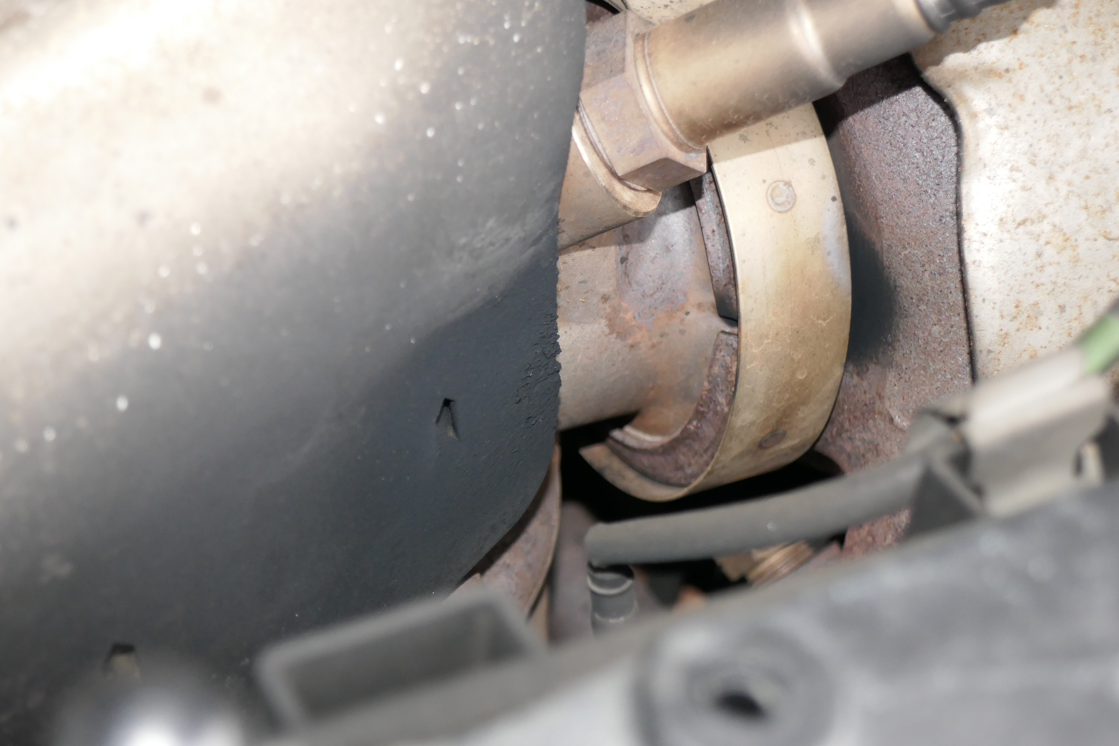

@FLAPPERJACK7 After smelling strong exhaust fumes in the cabin on a few occasions I popped the bonnet and spotted some tell-tale sooty signs in my engine bay...now hoping it's nothing more serious than that gasket & clamp issue you mentioned...

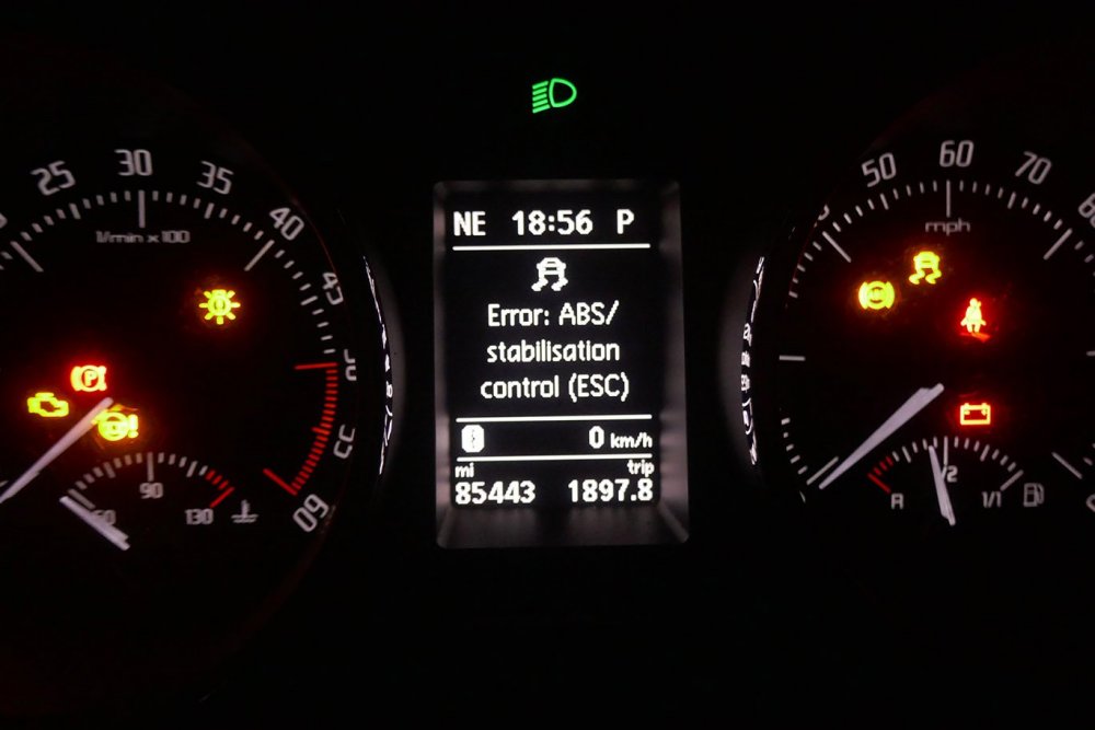

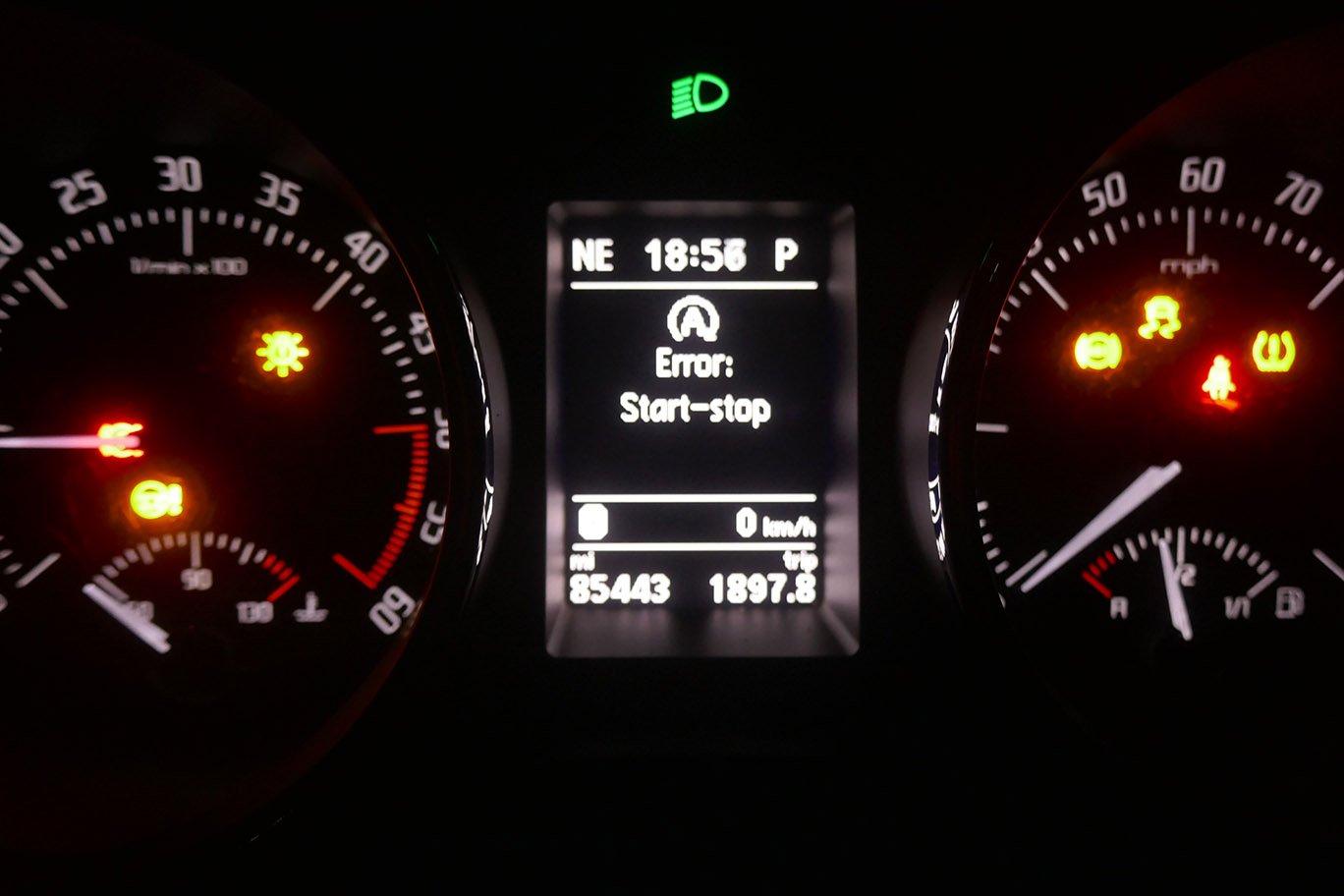

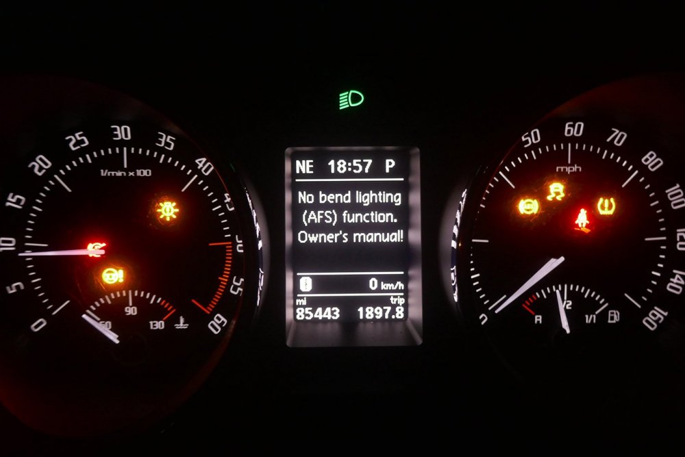

Lots of faults on the OBDeleven scan...looks like all but one (dodgy number plate light) are because the battery went flat after water got into the electrics, so lots of implausible signal/ lower voltage limit/ no signal or communication fault codes, listed a few below. Gave connector block another spray with WD40 and left it overnight. Change in the weather today and it's bright and sunny and hey presto, my front wipers are operational again. Phew 00153 - Driver windshield wiper motor Lower limit not reached Intermittent Priority: 2 Frequency counter: 14 Driving cycle: 192 Mileage: 138637 km 00154 - Front passenger windshield wiper motor Lower limit not reached Intermittent Priority: 2 Frequency counter: 14 Driving cycle: 192 Mileage: 138637 km 00446 - Function limitation due to insufficient voltage Lower limit not reached Intermittent Priority: 6 Frequency counter: 10 Driving cycle: 192 Mileage: 138637 km 01520 - Rain/light recognition sensor Lower limit not reached Intermittent Priority: 2 Frequency counter: 4 Driving cycle: 192 Mileage: 138637 km 00532 - Supply voltage Lower limit not reached Intermittent Priority: 4 Frequency counter: 3 Driving cycle: 192 Mileage: 138637 km -
