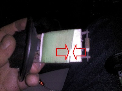

Hey, great guide :thumbup: . Just did mine. Bought the new resistor on eBay for about £37 posted and took just over half an hour to fit. The job is very easy to do apart from getting the resistor out. I managed to remove the connector first and then after turning it to left it just lifts out, but as you say, you do need small hands and you need to lift it out with the tips of your fingers as it is in an awkward position.
As it turns out, it was only the thermal fuse that has failed so I might replace the fuse and keep the old part as a spare. The fuse is brazed onto the connectors and marked TOD 240C. If it is a 240 degree fuse that might need some high temperature solder to fit it though, and wrap the fuse wires around the lugs for a mechanical joint as well just in case. I found some thermal fuses marked similarly on eBay here: Thermal Fuse Microtemp 240 DEGREES
Does anyone know if that is the correct rating? Seems pretty hot.
I also checked for leaves whilst doing this, using the details in the other guide, but found none and the fan still vibrates quite a lot on the high setting so maybe that helped to increase the load on the high setting and overheat it. If it pops again I guess that i will be looking for a replacement fan, assuming that you can't just replace the bearings.

I had this issue in my 03 VRS and bought a replacement resistor from ebay for £15. I installed the unit and tested my switch which resolved the problem meaning my fan now worked on the lower settings. Alarmingly after a few minutes of the fan running on setting 2, the resistor started to smell and smoke began emanating from it. It was very hot to touch so as soon as i could removed it from the car.
I contacted the seller who has offered a full refund, which was good of them, however feel i should share this experience with the community.
2 lessons learned...You get what you pay for and if you do buy cheap, make sure you test it properly before fitting it in the housing!
Edited by Bloitus
I was under the impression that the resistor needed to be in its housing as the fan directs cooling air over it, using it outside the housing could quite easily burn it out.
Hi fordfan, I agree having airflow over the resistor would help cool it a little however on fan setting 1 there is such low airflow when the resistor is at it's warmest, i can't imagine it being too effective when compared with it being in an open environment.
Even so, I wouldn't expect the resistor to start to produce a rather nasty acrid burning smell within 30 seconds and start to produce smoke within 2 minutes.
Using a small hand held fan would be a suitable substitute to having it in the housing while testing in my opinion if you were worried about it being cooled during testing.
As you can understand i just wanted to share my experience incase anyone else runs into the same issue.
