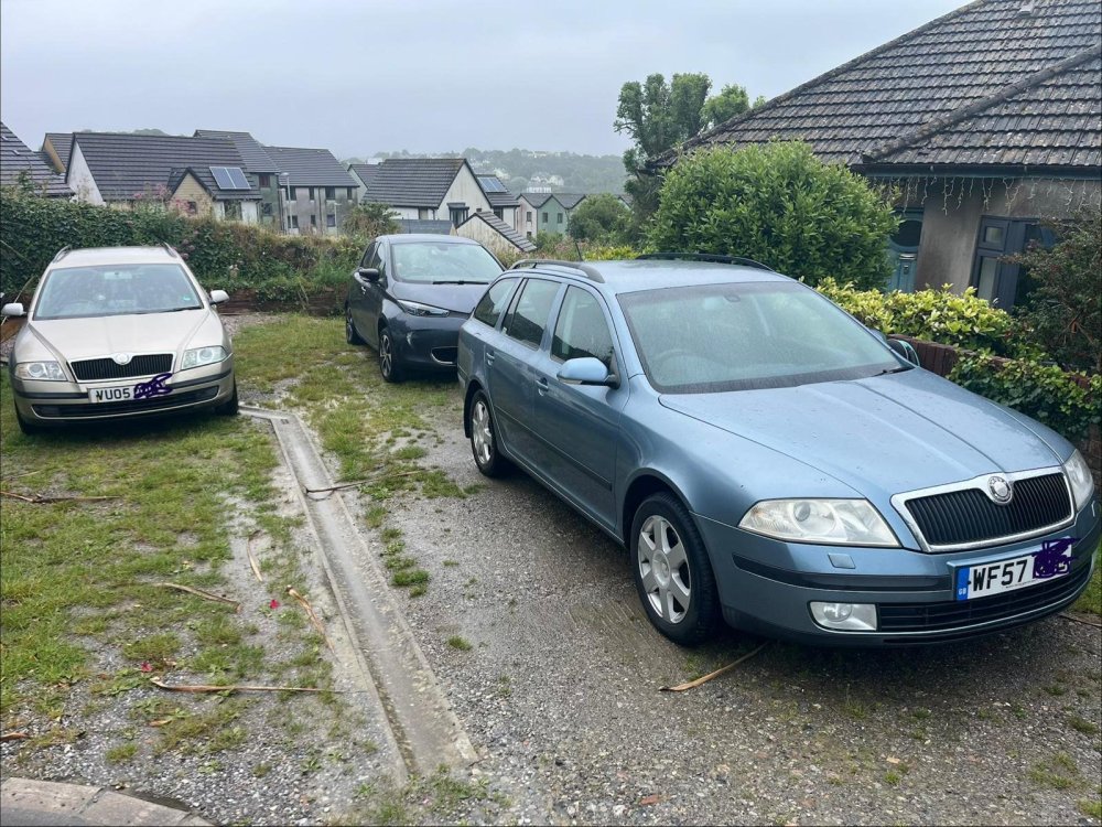

Recently a friend of a friend mentioned that she wants to sell her 2007 Octavia II. It's for genuine reasons (she bought a small car to teach kids to drive and doesn't need both). It's better spec than ours (Elegance, which excitingly for me includes cruise control!), has 119k miles with FSH (independent not dealer) and apart from a couple of scrapes is in pretty good condition. I assumed it would be the same engine but have since established that it's the 2.0TDI PD, engine code BKD (140bhp?). It's a bit lumpy starting from cold, with a bit of smoke, but seems pretty smooth and smoke free once warmed up. It's not that expensive, but it will mean swapping from 'the devil I know'. Obviously I'm tempted.
