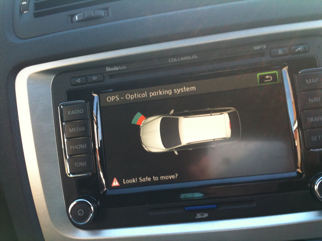

Mine have the odd gremlin, all the front will light up red on the screen or a corner one will. Each time there is nothing near the sensor. I've found giving them a wipe usually stops it.
Picked mine up early September and for the first 6 weeks or so after driving in the rain one of the front corner sensors would stay on 'red'. Once the car had dried out, it would be back to normal. Touch wood though, everything seems to have settled down and it's all been fine with the rain we've had recently.

Pic attached...
