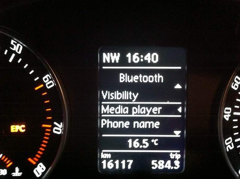

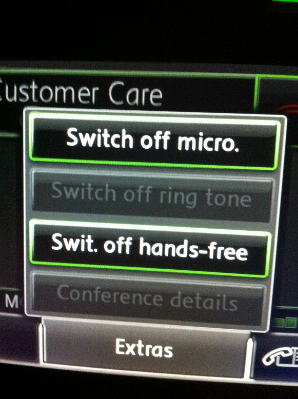

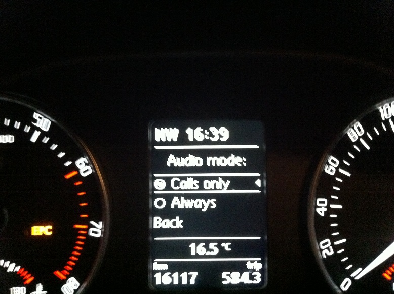

Hi all,
Just installed the 3C8035730A module to replace the rSap only 5N0035730C.
Simple plug and play, no recoding was needed.

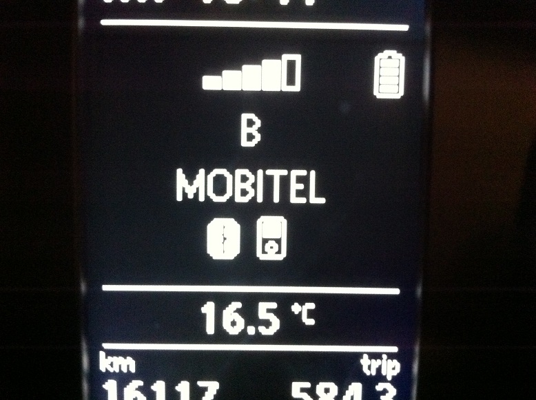

Iphone 4 works fine, address book downloaded and all that. Also media player plays Iphone songs working.
No SMS on Maxidot compared to rSap HTC Touch HD that i have.

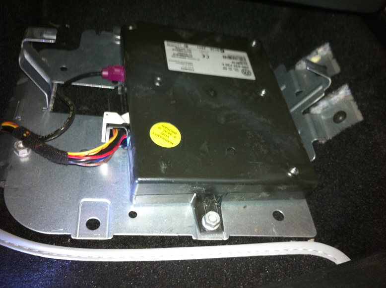

Module arrived today. 10 minutes to swap out and everything works again with my iPhone 3GS.

Got mines today and also took me a few minutes to swap out.

Best thing is to remove the covering trim under the seat (slides out) and note the module number.

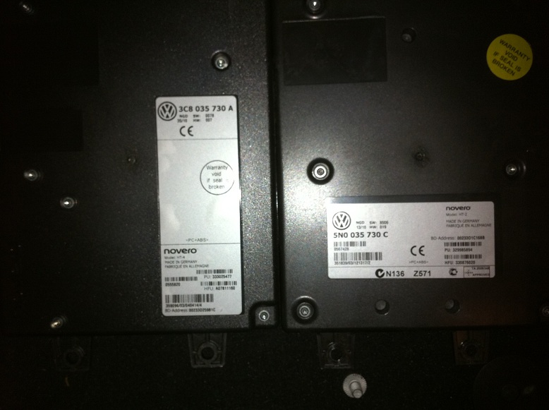

In my Superb I have 5N0 035 730C. I got the car April 2010. I also have Columbus navigation system.
For now I'm using an HTC touch HD which is connected with no promlems with car's pre instalation.
I had a look on the ebay (http://cgi.ebay.co.uk/VW-RNS510-MODULE-3C8035730A-rSAP-US-BLUETOOTH-/280597915034) for the new 3C8035730A.
They say that it's the same with 5N0035730D and if you order it you may get either of the two.Anyone knows if they are the same?
If I replace it will I have the same functionality as now? i.e. will I have the same Columbus screen and also maxi dot informatio? Do i need to change anything in the coding of the car as they do at http://www.myturbodiesel.com/1000q/a5/VW-bluetooth-FAQ.htm
No you should not need any coding, the units that you mention, the 3C8 Rev A and the 5NO Rev D are identical, the 5NO is just a part number change to the 3C8 unit so either do the job very nicely. have a look at a seller called ukmegaseller he also does the units from what I recall he was slightly cheaper than pickmanuk as well. :thumbup:
