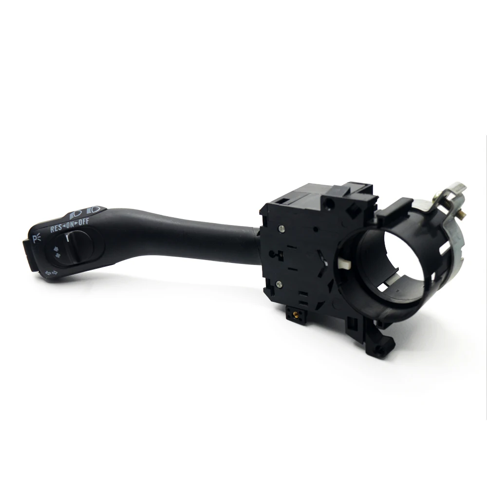

I've 2004 Fabia MK1, i wanted to activate cc and went to the service, they've set the wires and ordered genuine cruise control stalk (waited 1 week to get that stalk,they ordered from skoda factory), they've tried for 2 week(they made the cables,connections and necessary vagcom coding) but couldn't be able to activated. When you open the cruise control and push to set button it returns "17977 Implausible Signal" error, they said the BCM comfort unit is is not working well and it causing the problem(part code is  6Q1937 049D),so it needs to change,their price was so expensive and honestly they lost my trust, so i went to second hand part dealers and found the part, when i asked the dealer is it ok to test before buy they said sure, we have changed my BCM unit with new one but it didn't fixed, we thought that maybe second hand part is faulty too and changed with another one but the result was the same, also tried 3 stalk to be sure it's not causing by stalk but result was the same.
So i went to another service (they are not original skoda service, they are providing service to all type of cars), they have checked and said "we are not sure about it but it seems like they (service) only managed connected cables to BCM only,it seems like there is no connection between BCM and clutch pedal and brake pedal,as we said every car is different maybe this car gets signal from pedals from this port but as far as we know for cruise control you need the get signal from pedals and it seems like they haven't made any connection(bridge) from pedal sensors." it makes sense to me.

What i am doing for test is :  starting the car, reaching >60km speed(manual says cc not working under 40km), switching cc to left (a click sound hears) pushing set button for 2 secs and nothing happens. my stalk is this : https://ae01.alicdn.com/kf/HTB1iSaGLpXXXXX2XFXXq6xXFXXXK/Cruise-Control-d-n-sinyali-anahtar-Sap-Audi-A2-A6-C5-TT-Skoda-Octavia-Fabia-Seat.jpg
Before we install the loom (one i bought from germany) it was returning implausable signal when you open the cc switch immediately, now it's not returning any error. Also checked the clutch and brake and works just fine.
My mechanic said he can provide a brand new stalk for testing to be sure my stalk is not faulty but he also said if stalk is faulty it should return error, we gonna try it anyway.

it worked!!!! :) turns out that my stalk is faulty, somehow film cable of the stalk is damaged, replaced with new one and works like a charm, thanks for your time and kindness.
