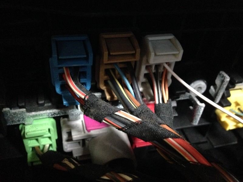

  • I have it somewhere. When I started retrofitting MK1 Fabia with cruise control around 18 years ago I used to make my own looms as the kit wasn't available at the time.

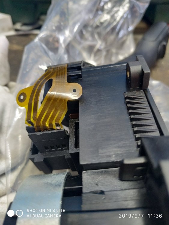

  • it worked!!!! :) turns out that my stalk is faulty, somehow film cable of the stalk is damaged, replaced with new one and works like a charm, thanks for your time and kindness.

T11a pin 10 for your car, built 31/03/2004. It ends up on pin 14 of the 81-way connector at the engine ECU, if you fancy taking a different way through.
Same T11a connection for any car built before May 2004 by the looks of it. T11b pin 6 from May 2004.
Thanks very much for that! Mega useful.    Although now back to changing the pins around 🤦🏼‍♂️
Team - bit of gen to summarise how I got mine working (probably obvious).
T11a pin 10 ONLY (for my pre may 2004 car)
DONT try and piggy back or an ignition wire from the fuse box, this caused a P1689 code for me - use the brake T4d pedal plug, pin 2 as the wiring diagram says and it works!…. Obvious stuff I know.
Ensure you cycle the ignition having activated it via the OBD.
  Very many thanks to Breezy_Pete for his time and wealth of knowledge.
