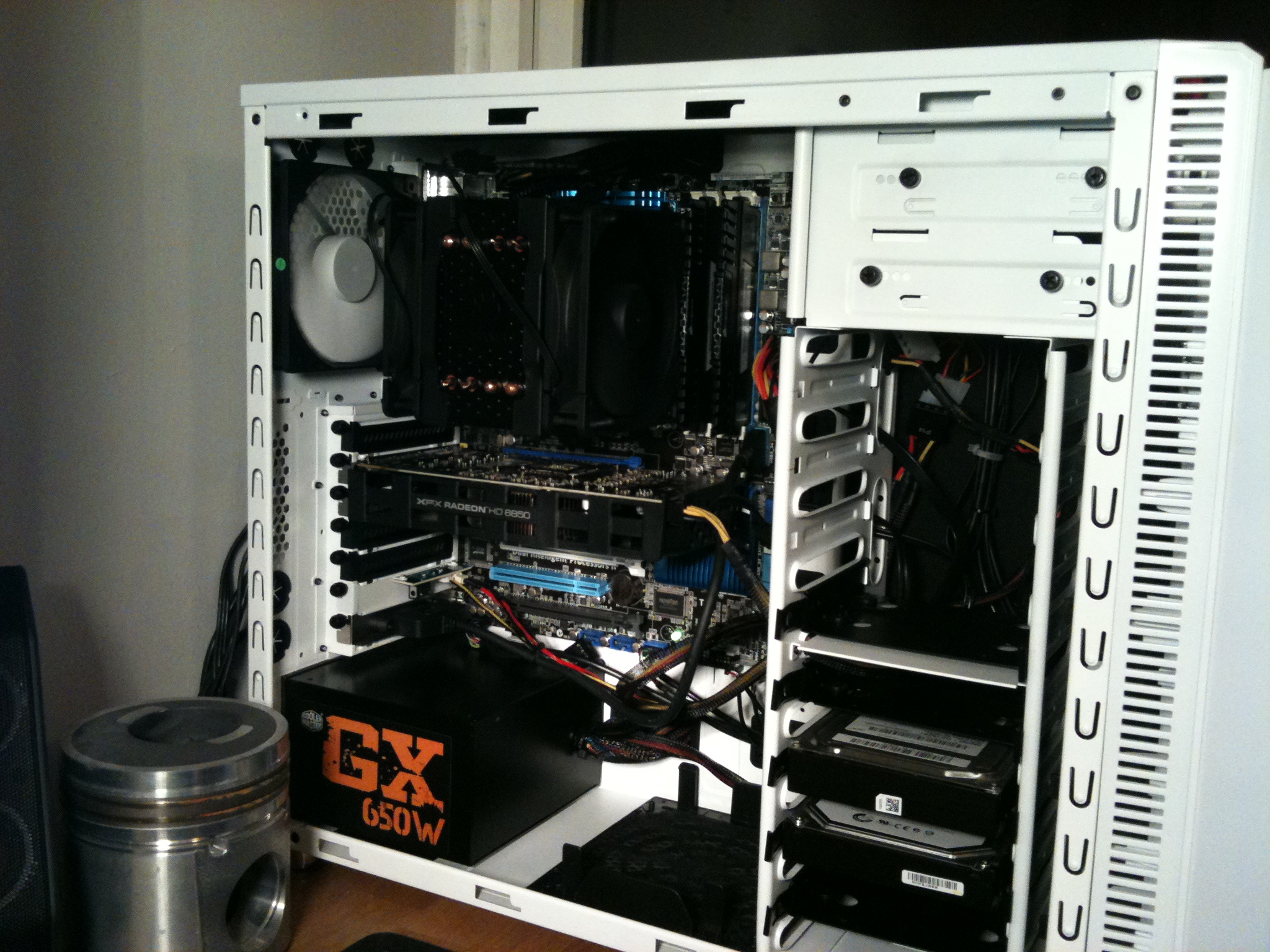

The beast is built!

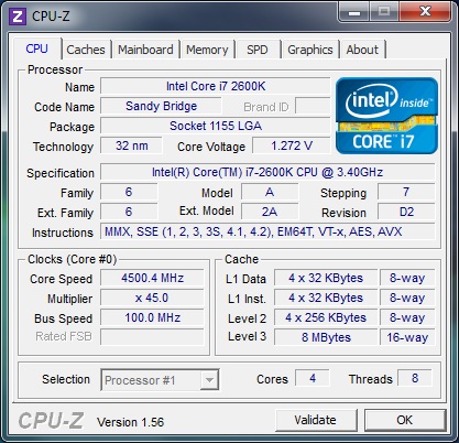

Overclocking is super super easy! There are about 3 settings to change to achieve a 4.5Ghz OC, which is easily achievable on air cooling with a decent heatsink. The corsair A70 i have is maaaahoosive so thanks to speedstep i have an idle temp of around 24c and a full load temp of about 68c. Interestingly someone has managed to OC the sandybridge to 5.7Ghz on just air cooling, so it really is an astonishing cpu.

The case i bought was a bit of a dissapointment. I was expecting a better finish and build quality for the money. The antec and coolermaster cases i have used in the past are in a different league. However, it houses everything nicely and keeps everything running nice and cool.

Ah, i even have a rather boring photo of the finished product!
