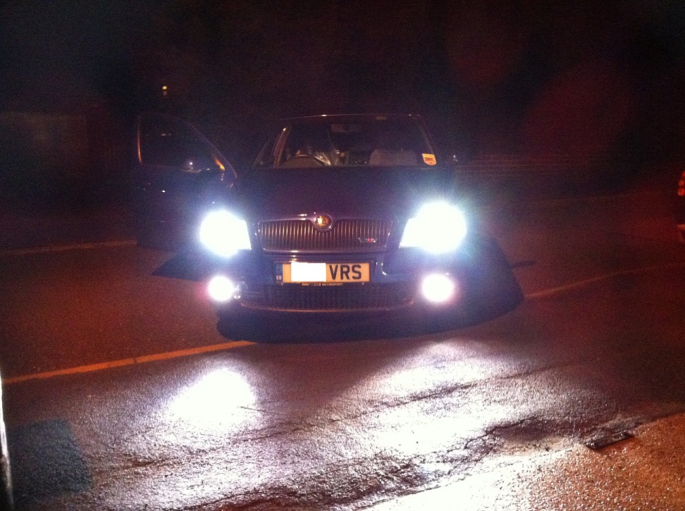

Here´s a couple pictures of mine.
As you can see it´s only the Can-Bus ballast I have , no cable cancellors between ballast and the bulb.( ballast + cable cancellors + bulb)
Since the back is rubber, I did this to pass the cables
Can see here all inside. The bulb is metal plated that goes agaist the housing. If they are plastic you must scrape off just a tiny bit ( usually the 3 position bits , just clean them)
If the rubber back piece pops off, just make a small cut towards the middle ( 1cm), always put cut to the bottom for the water not to enter.
