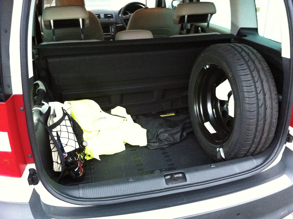

I am wondering, I notice Agerbundsen has spare wheel fitted, and rockhopper, do you have spare wheel fitted?
I was just revisiting TP's thread on sparewheels, it seems that options provide a wooden board (and the wheel may actually eliminate some sound off the road) where as mine, only provides some thin carpets. http://briskoda.net/forums/topic/156798-spare-wheel-assembly/
As far as I am concern sound proofing is the same between all Yeti's be it E model or Elegance.
I was just revisiting TP's thread on sparewheels, it seems that options provide a wooden board (and the wheel may actually eliminate some sound off the road) where as mine, only provides some thin carpets. http://briskoda.net/...wheel-assembly/
I have the spare wheel fitted, but not where it left the factory and I also have the polystyrene filler and the boot carpet like you and a rubber mat. I wanted more boot space and a spare wheel.......
I bought the spare wheel after taking delivery of the car, maybe two months later. I did not notice any difference in the noise level after installing the spare and the new boot floor.
Your concern is the tyre roar, which probably comes mostly from the front, so no real change withor without the spare.
