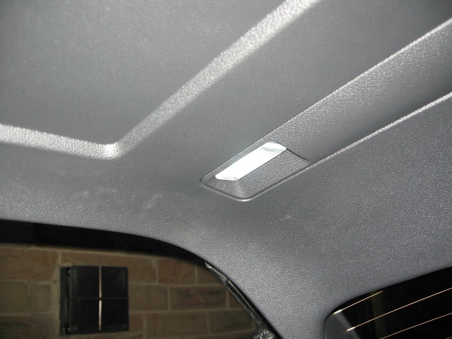

I've done the tailgate downlighters and have now done all the interior lights.
BTW, the footwell light need to be the same as the tailgate ones. i.e. ones that fire sideways ;)
I used these Leds below for the 5 on the roof (they dont need to be anti-Canbus either)they do fire the light straight down, but they sure look good with a good bright spread. Cheap too.
http://cgi.ebay.co.uk/ws/eBayISAPI.dll?ViewItem&item=260779061475&ssPageName=STRK:MEWNX:IT
