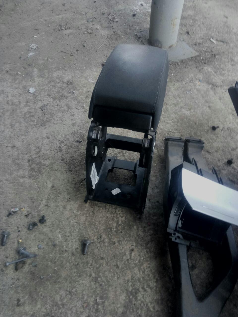

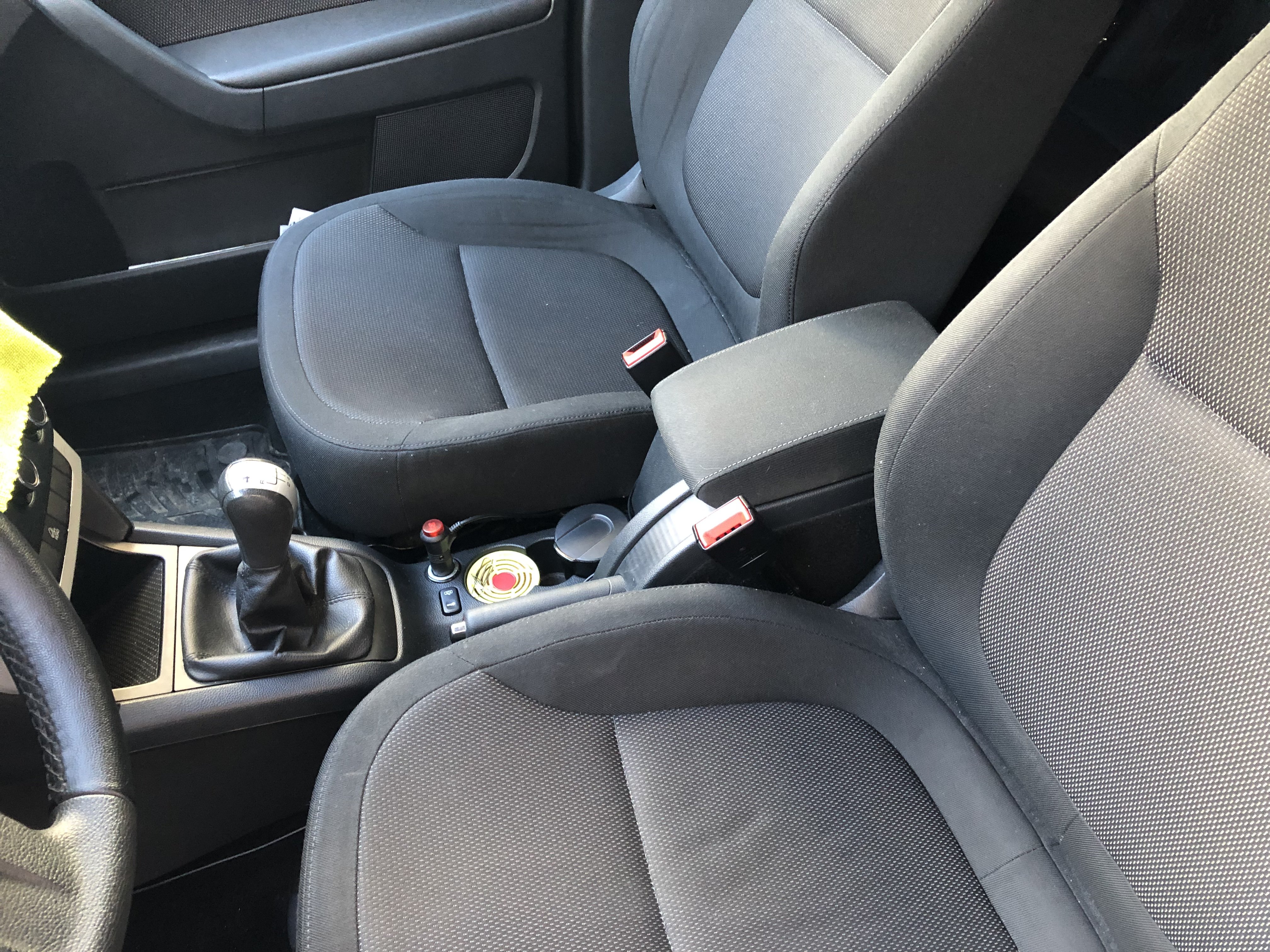

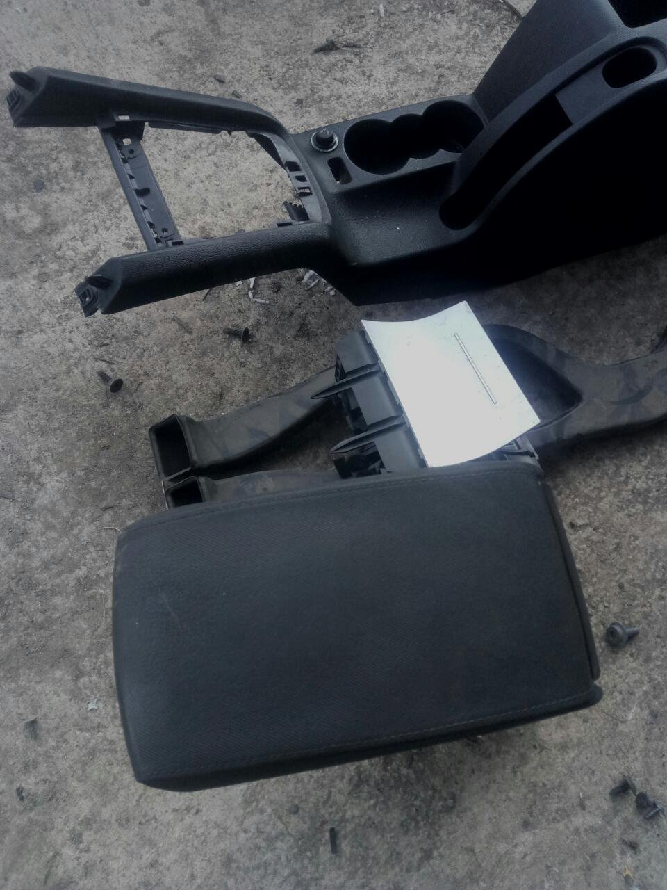

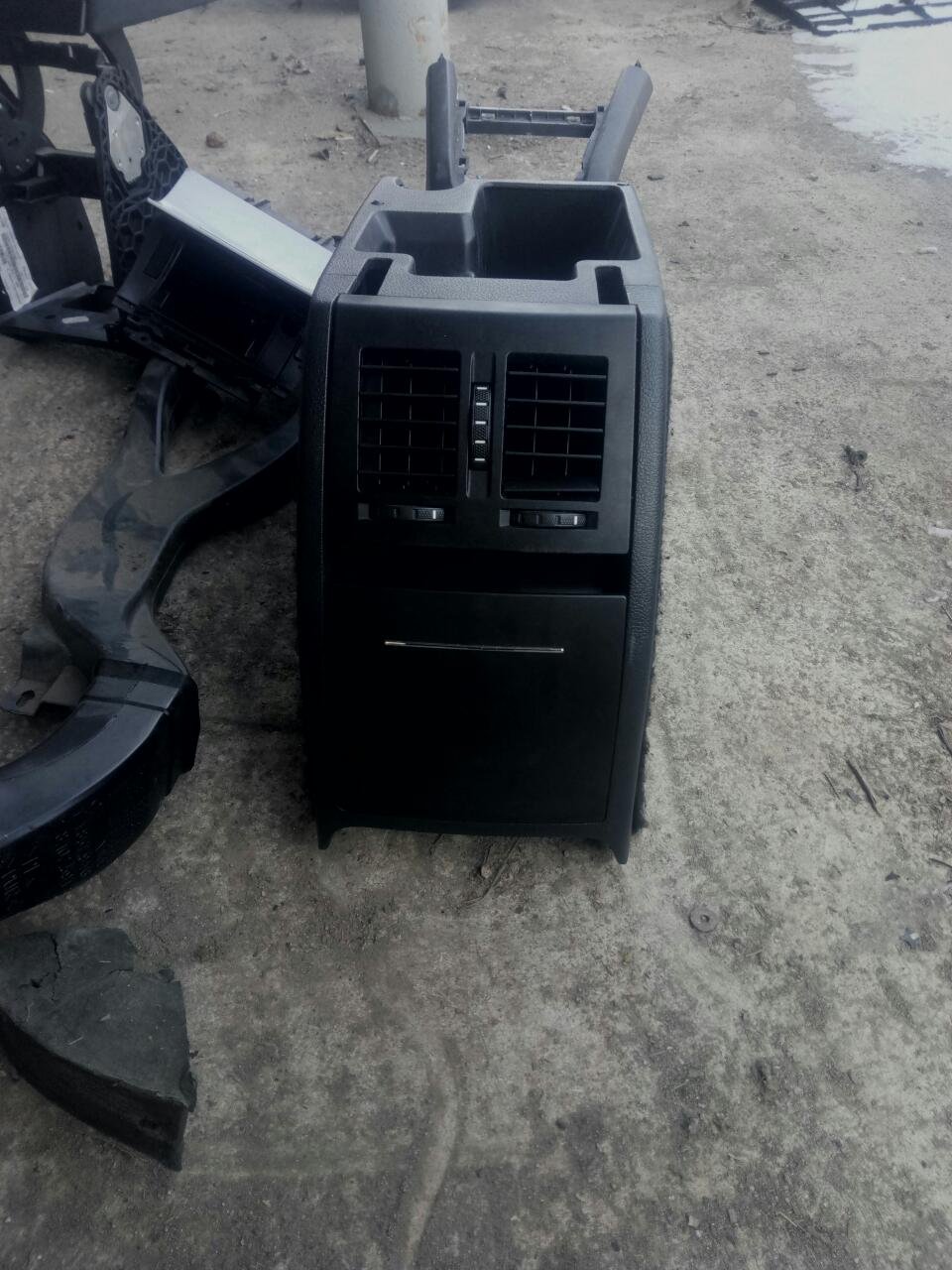

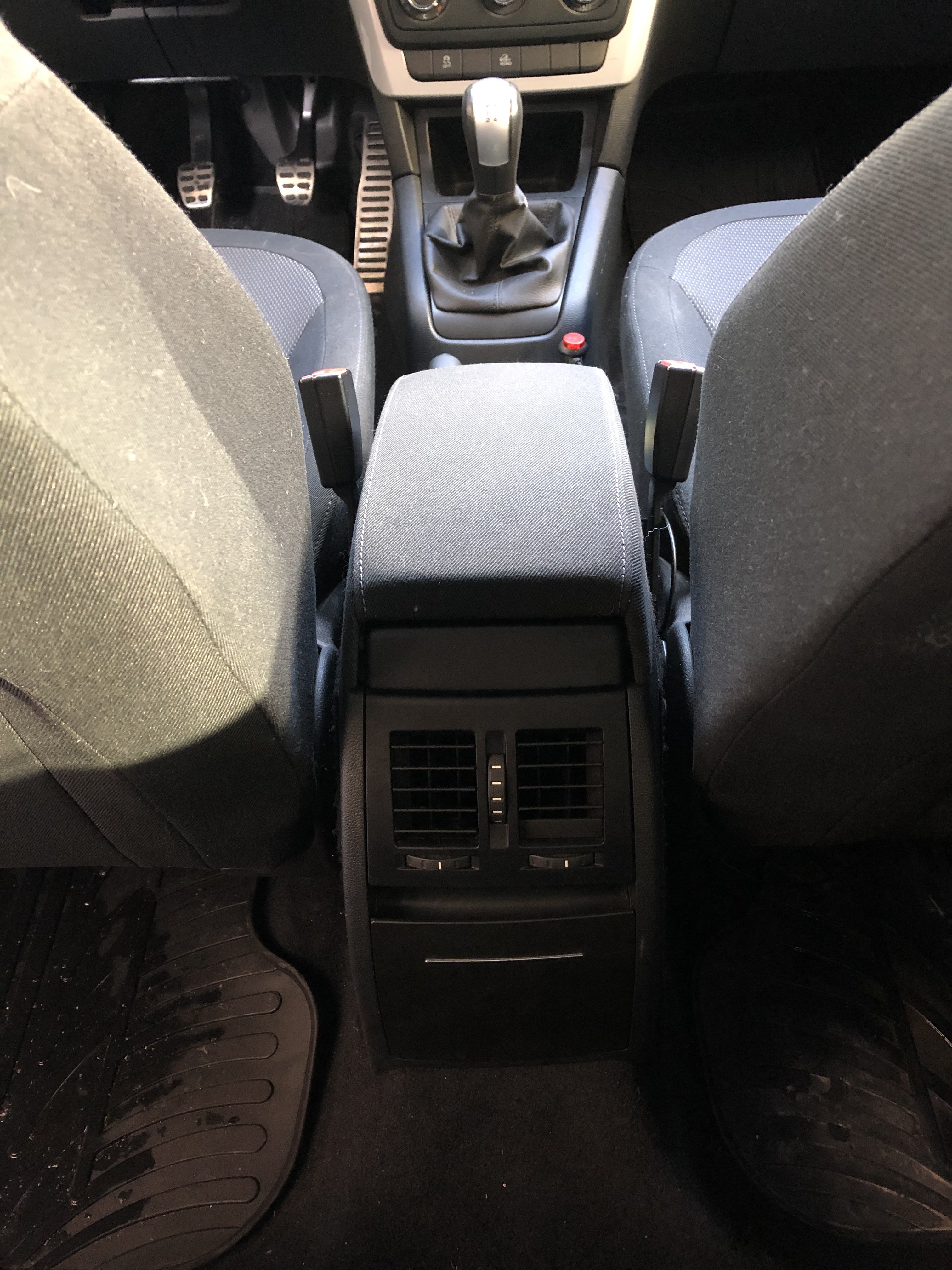

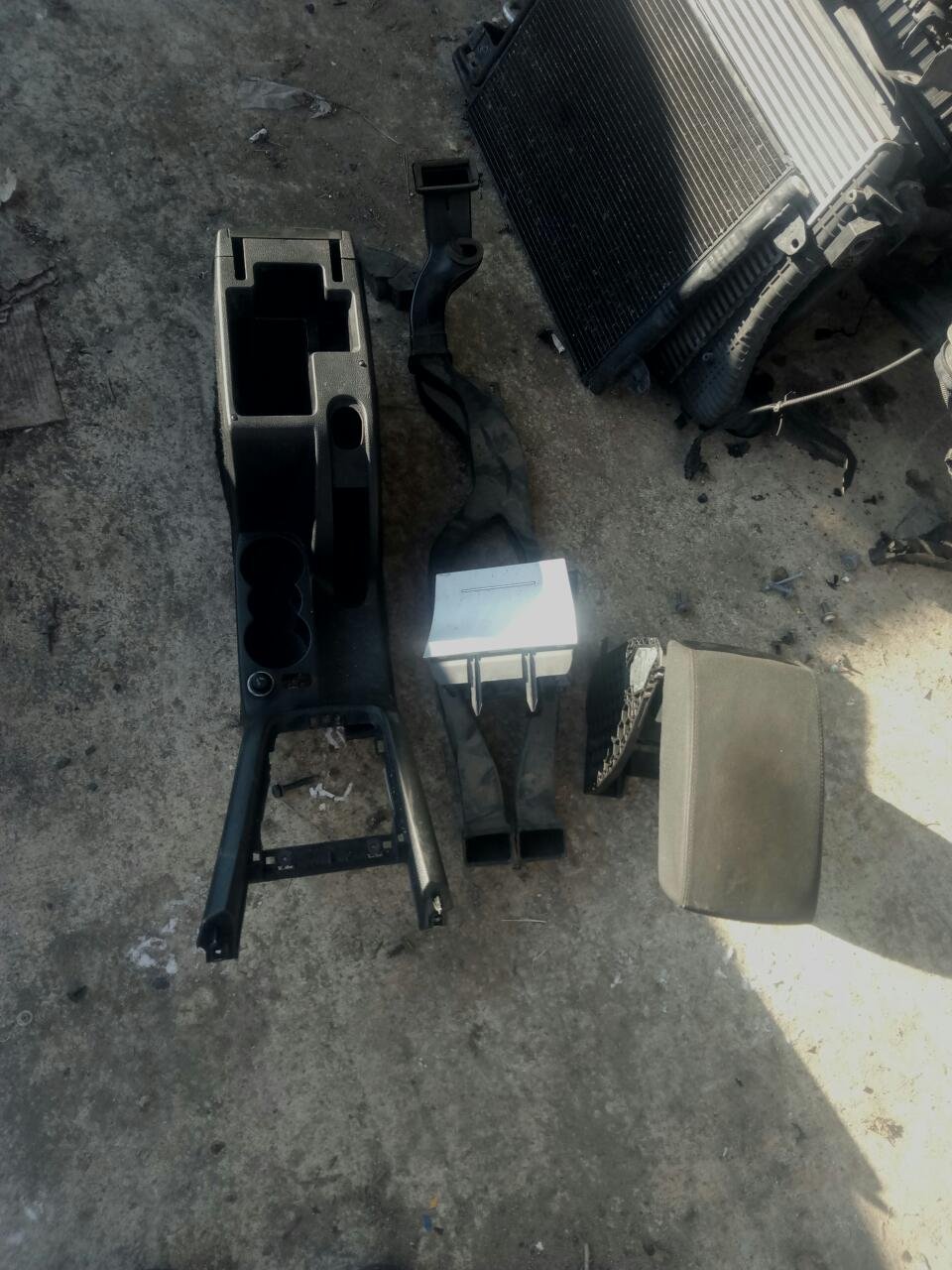

Hello from Bulgaria. I have a Yeti without armrest. Recently discovored that the armrest and center console are same with Octavia 2. So bought evereything consolre, armrest, front ashtray, vents tubes and back and all bolts for 70 euros. I don't think that the front ashtray will fit there because all Yetis are witouth ashtray will see. Can you give me some pointers that to be carefull.
P90108-101821.thumb.jpg.6b77532de79281e426ada568eeba1bd3.jpgolx_image_2019-01-08_13-32-26.thumb.jpg.d90c709c11f9f7af3fe4e3d8958a8f00.jpgolx_image_2019-01-08_13-32-43.thumb.jpg.8af8a81e332c7131bd77cf937e1c3f50.jpgolx_image_2019-01-08_13-32-57.thumb.jpg.e3d7e8e48b2be71e37bf1cc52a46869f.jpg
@Yeti-Bulgaria - some parts are shared between the Octavia and Yeti centre consoles but not all.
For instance, the Yeti armrest is 5L0864207C and the Octavia's are 1Z0864207C/D/E so there may be different mounting points. You can find more info on the difference by comparing these two diagrams:
- https://skoda.7zap.com/en/cz/yeti/yet/2012-666/8/863-863060/
- https://skoda.7zap.com/en/cz/octavia/oct/2012-663/8/863-863060/
You might need to tweak the model year to get the correct parts for your Yeti.
Good luck...
@langers2k i've checked diagarms. The donor car is Octavia 2 FL 2010 wagon but my Yeti is 2009 pre-fl. So аccording to the diagram mouting points are same only front ashtray is not comptable.
Edited by Yeti-Bulgaria
Fited perfectly without front ashtray.
