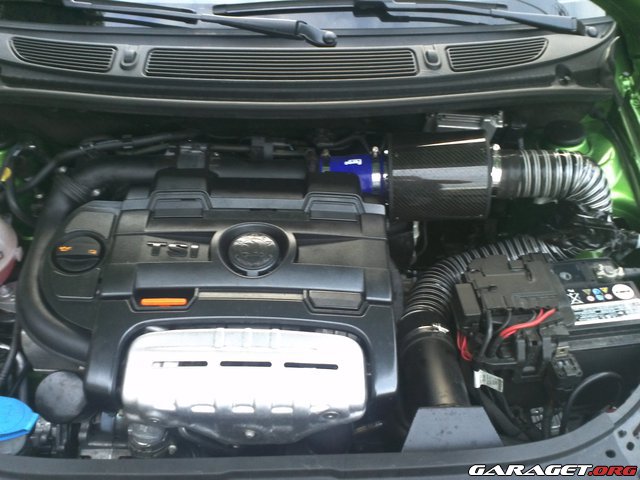

Hi just fitted my forge intake just thought id put a few pics up for those who are interested in it.
Throttle does seem a little sharper, noise is improved but not over the top.
And performance wise i wouldnt say its mind blowing although i did not drive it for long il have a better idea after my commute tomorow.
However the wheels did spin in second on a dry road quite a bit easier and it does seem punchier.
Also ive lent my car to forge for the intercooler development so some time soon maybe august/september there will be a kit available. it will be rolling roaded before and after so i will let you all know how it goes. as for price look at around the £500+ mark for the cooler.

I also have the engine-cover mounted, problem for us who drives on the right side is that the kit don't fit properly =/.
It blocks the brake-fluid and vibrates... + that the metal-part is too long... that or the hose needs to be shorter.

Here it is with the cover fitted its only black for now ill put some more colour on it when its cured and ive flatted it back a bit.

i was talking with the forge development about the vibrating / brake fluid tank problem on lhs cars and i got this one
Hello, yes this is an issue on LHD cars. I believe you spoke to John about this
last week as well ? The airbox cannot go any higher as it will rub on the
bonnet. We do have a smaller filter that may work for you but it may be too
small. We do the flexible ducting in two different lengths and it sounds like
you have the longer of the two, where you need the shorter one.
I have no other solution for the airbox however. There should have been a note
on the website saying that it will only fit RHD cars, but somehow this had been
erased. It is now back on the website.
The only thing i can offer you is a refund.
Thanks
Chris Lloyd
Research and Development Manager
i got the option to order a 130mm diameter airbox instead the original 160mm .
sidenote : i almost lost the brakefluid filler cap after about 30 miles , so i went back to the oem airbox
pic
Thank you for adding the pic, saving me the job to do it :p!
EDIT: Okay, got offered to either replace the 160mm-filter with a 130mm or getting a refund for it.
I'm leaning towards the later one, but I'm thinking off what my options are.
Either it's going with the smaller filter or getting an K&N filter for the standard filterbox...
What are your suggestions guys?

This is the enginebay, I'm pretty sure it looks the same as yours... except for the brakefluid-canister.
did you tape the canister to not loose the cap ? .
+ it looks like you got the same to long hose .

I taped a bit off dampening on it to cover it from vibrations.
I'm already fed up with it and will be returning it, problem is tho... Replace it with what?
K&N / AEM / Green i suppose...

Would the iTG maxogen fit
Or keep the forge filter, fabricate a bend and do this
Sent from my MZ601 using Tapatalk
Edited by janner_Sy
the ITG got the same diameter . well the second one should work with the batterie in the boot ...
If you could turn the battery by 90degrees so its side on so it could fit then

EDIT: I've figured that I'm skipping the intake and going for a K&N replacementfilter aswell, should work sufficiently...
