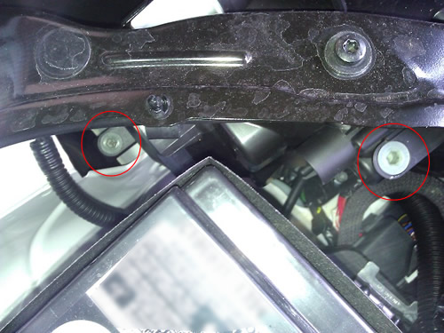

Went an investigated the grey screws you mentioned, a phillips screwdriver or allen key would work.
There's two, the lower one seems to adjust the vertical tilt, the higher one the horizontal tilt.
Indeed there are two white plastic screws which can be seen from the top. One works for horizontal adjustment of the lens and the other screw closer to the bumper is for vertcial adjustment. Use an allen key no.6
