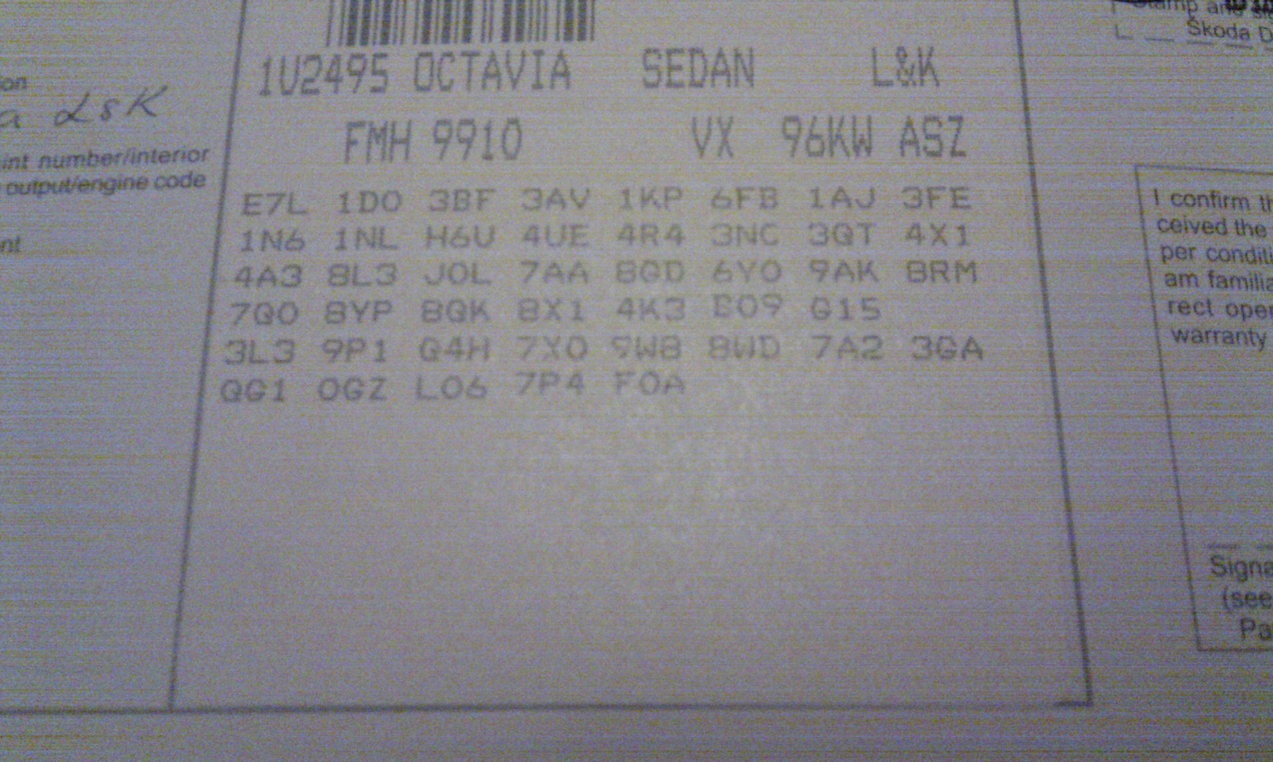

Looking at the wiki, I assume that if my current coding is QG0 then it can't go to variable, but otherwise it's a simple change from QG1 to QG2?
Looks like it to me. If it's QG0 in the options sticker in your manual then it won't have a combined oil temp/level sensor so can't be switched to variable.
If you don't have the sensor it might be possible to retrofit one though, I'm guessing it's in the sandwich plate between the filter and the block so you could possibly fit a sandwich plate from a QG1 or QG2 car then switch it from QG0 to QG2.
This is my sticker inside the service book. I assume that this means it was originally on Variable?
Yep looks like it was originally on variable (bottom left option code in the pic)
This ties up with the coding of the instrument cluster. The coding number was 31414, with the last 1 meaning that it was already coded for variable.
So this meant that I only had to change the service type in the SRI reset section. Job done I hope! I'll be doing best part of 800 miles this weekend so I'll have another look at that section next week to see what it's come up with.
