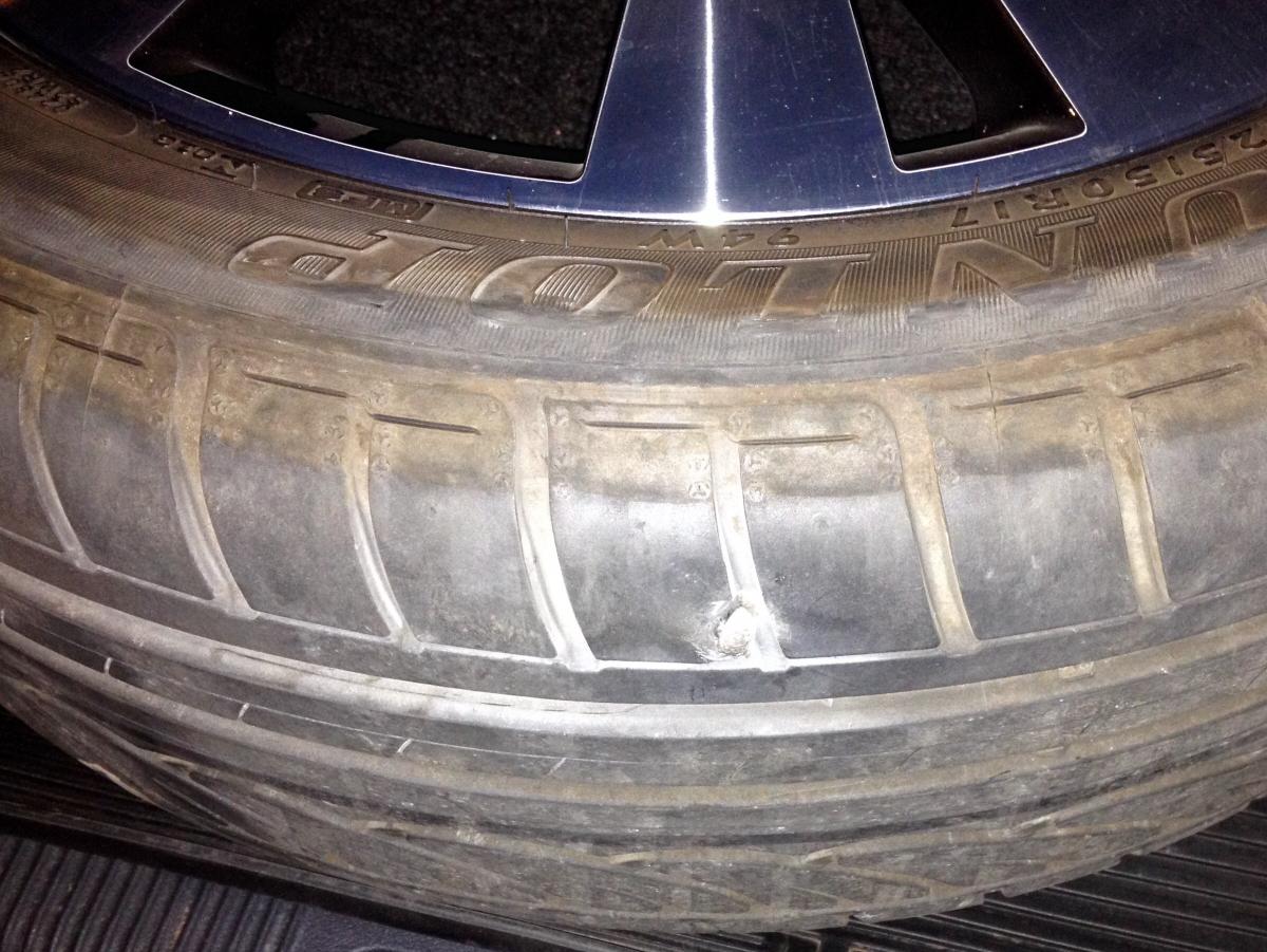

After picking up a large stud in the rear tyre yesterday driving on the M5 ,getting the AA to recover the car on a low loader to a service area a couple of miles away,dropping the car off and then calling another AA mechanic to change the wheel.?any way after fitting the spare and checking the pressure on their system found it should be 38psi which sounds about right for a standard tyre,even if not the same size as the others,and by the size of the damage glad I was carrying a spare and not gunk.
