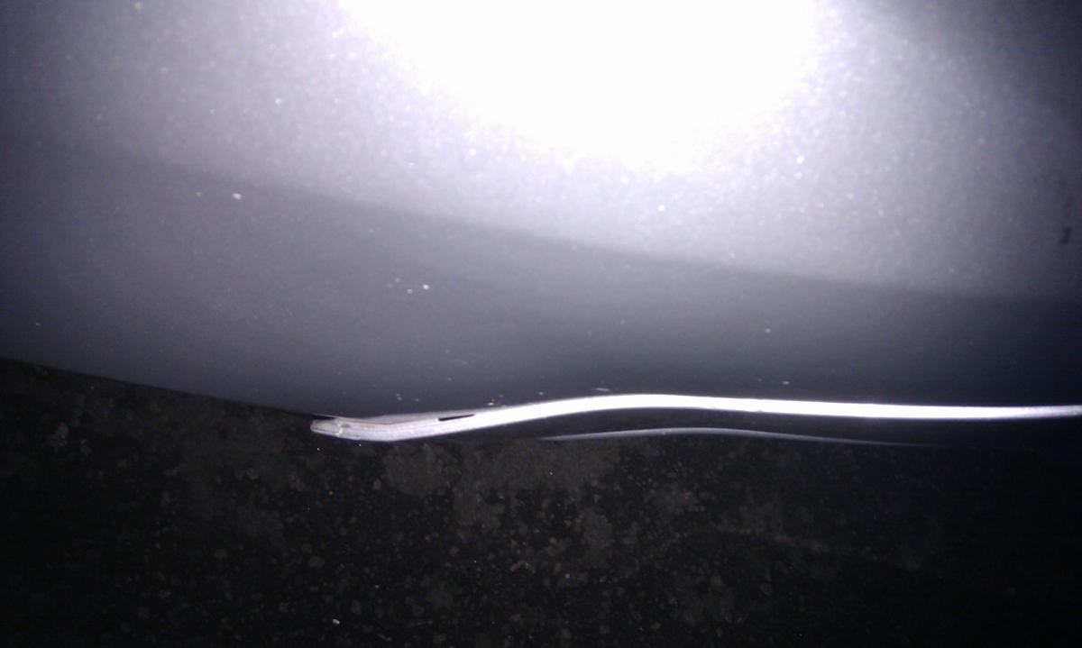

I got the same problem with my front bumper mate (see pic), a small imperfection and yet it annoys the **** out of me!
Where did you buy the bumper clips from??

loosen the screw in the arch and push the bumper and hold it there while you tighten it.
thanks mate. But I'm completely new to working on cars (my first challenge is to change my interior bulbs with LEDs :whew: )
Anyway, how would you do this then? I assume you have to take of the wheel first, and then which screw do you mean?
Won't have to take the wheel off mate, just turn the wheel to full lock so the wheel points inwards then that will give you enough room. Then you will see I can't remember if it's 4 or 5 screws which look as though they screw to the bumper, remove the top one, push the bumper in then re-tighten :)
Its the arch liner that isnt in the correct place, it was the same with mine and couldnt do it for the life of me then my brother whos a panel beater put it right in two seconds. Messing with the screws wont do anything unless the liner is in the correct slot in the bumper but they will have to be removed to pull it out enough to locate it correctly.

No prob! It's good info to know as I'm struggling with mine, ill give the above a go!

If you dont succeed and your around the pontypool way stop by and my brother could take a look but yours doesnt look to bad now so could be the screws need adjusting like said but Bruce's is defiantly the arch liner like mine was.
Awesome, cheers Tim,
Bit confused now. But I will give DanHam's suggestion a go...otherwise I might take you up on your offer!
I was on about tims doesnt look to bad and if he was around pontypool as he lives about 20 minutes away. But your bumper is the liner isnt sat in the correct slot, as soon as its sat correctly it should clip straight in.
