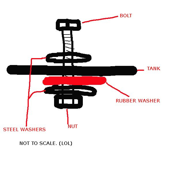

I don't think you can use patches or sealer on plastic fuel takes, none will last. The best solution is what Auric Goldfinger suggests, although the rubber will rot in wet petrol over a period of time. A self tapper sealed with Nitrile rubber will work a lot longer though. Best fix is a new tank of course.
Many years ago I did a similar repair job which lasted 5 years plus, and admit it were on a metal fuel tank.
Can't see it not working as well on a plastic tank.
Attached a very crude drawing.
With a bolt running through a steel washer from inside the fuel tank through the tank itself.
On the outside is a thick rubber washer and a steel washer below it, with a nut screwed up the bolt length to tighten.
The bolt must be long enough to be gripped from below whilst tightening nut up.
You could add some epoxy fuel resistant resin around hole to ensure a better seal?
Good luck.
