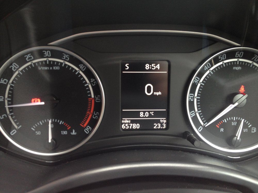

Here is a walk through I compiled
You can remove the small KPH display and replace it with a large MPH display:
However you will need both maxidot fitted to the car (as shown above) and someone with VCDS to change the country setting to Australia:
To set the country to Australia:
To change the country go to 17- Instruments and click on "Coding - 07"
Then click on "Long Coding Helper"
Finally under Bit 4 select "70 Country: Australia (AUS)"
Exit this screen and you will return to the previous screen (with the current & new coding displayed) you see that the long coding has changed, click on "Do it!" all will then be saved.
Once you have made the changes with VCDS you then need to go into the maxi-dot menu:
SETTINGS
Units,
"Consu/distance" change this back to mpg (GB), mi (as it defaults to 1/100km, km),
then
SETTINGS
"MFD data" and make sure the box for Digit.speed is ticked
You can also remove the KPH display and replace it with the outside temperature:
SETTINGS
and unticked the "ALT.speed dis." box (this will remove the KPH speed and replace it with the outside temp display)

Apologies for reviving an old thread, but I'm trying to do what the original poster is. As in set up the digital speed.
I've changed the cluster region to Australia and set the fuel consumptions figures back to mpg. The outside temp is now where the km/h reading used to be. However, when I go through the MFD settings screen, I have no digit.speed box to tick. Only the Alt.speed box, which I've both checked and unchecked, but I can't get the big zero on the main MFD screen.
Am I missing something out ?
I've done all this via Carista and with the OBD dongle, would this be the problem possibly ?
Possibly the problem, When using VCDS, it actually changing the software in the car's Gateway box, from what i know  Carista and an obd dongle will do basic diagnostics. The equipment we use at work will only do diagnostics, it can't change anything to do with software and a top of the range BOSCH system.
Edited by Ju1ian1001
All sorted now.
Just to confirm a facelift non-maxidot can be configured to show live mph using Carista.
