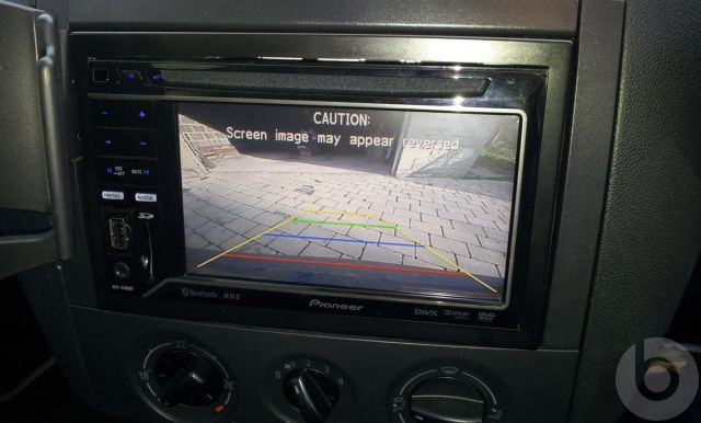

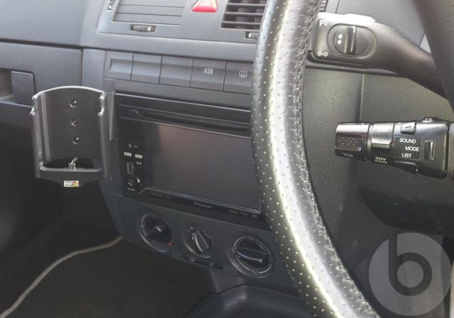

Fitted a Pioneer AVH-3300BT over the last couple of days, all went OK. Am well pleased wit the result.
The double din cage was a very tight fit but no real problems. I would recommend to anyone fitting a similar headunit that they route the Fabia loom to the rear, bottom left corner of the headunit aperture before trying to fit the headunit in, then there is loads of space. I popped the centre vents out, it was then easy to see what was going on.
As seen in the photo above, I also fitted a "Sony RM-X2S Remote Commander" as a wired remote that I had it the loft. I miss stalk/steering wheel controls in the Fabia so thought I'd try it and it works very well. The "sound" and "list" buttons don't seem to do anything and the "off" button is redundant too (just hold "source" for a couple of seconds to turn off). But navigating and volume works great, no more fumbling about at arms length trying to adjust the radio!
The 3300BT has a reversing camera input, so I set this up too with a £12.99 ebay reversing camera (now gone up to £33.99) that replaces one of the number plate lights:
A small issue now is that the LED number plate light in the camera looks rather blue in comparison to the other one which looks yellow. I hope to find a replacement for the yellow one that is a better match.
The image is surprisingly clear, even in low light. Having twin reversing lights helps (is this standard?)

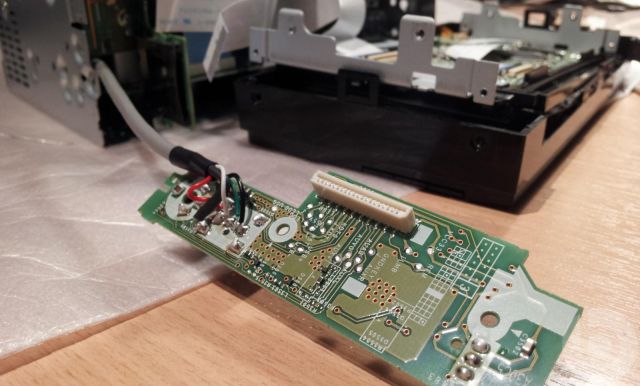

I did a mod to the headunit to provide a rear USB input, wired in parallel to the front socket (only one can be used at any time). Still waiting for a panel mount USB adaptor in the post, but will be mounting it in the glove box for a memory stick.
