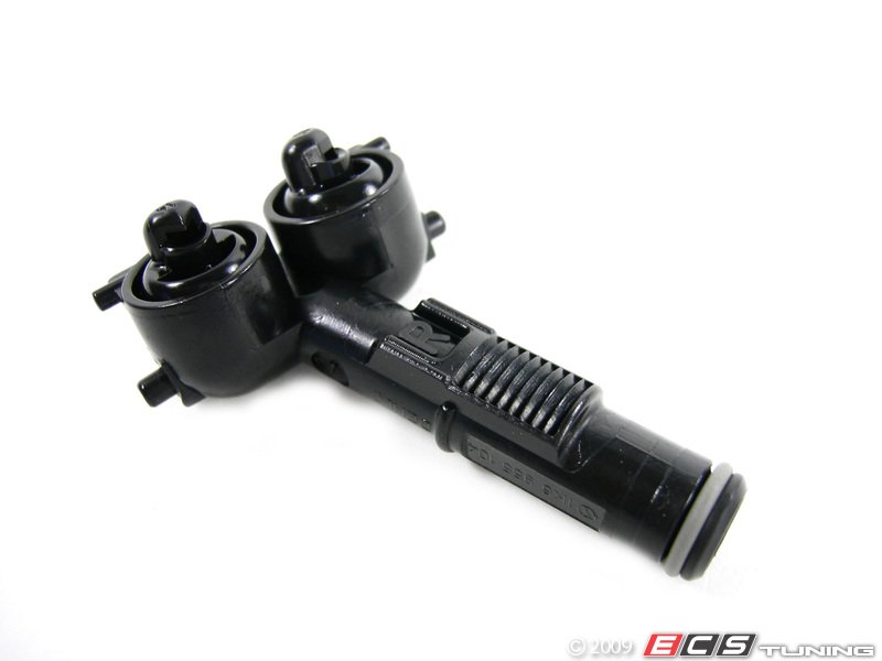

With cold weather here in some places and coming to other areas soon I thought I'd warn owners of cars fitted with headlamp washers to make sure that when they de-ice their windows before moving off also de-ice the washer covers that fit flush to the front bumper just below the headlights. A neighbour of mine with a BMW failed to do this and when they operated their washers the device pushed forward as normal but the frozen flat bumper cover snapped off leaving a rather unsightly gaping hole in their bumper. Cost to replace... several hundred pounds on their BM due to having to buy the whole device as can't just get a cover to fit on due it all coming as one piece, then add the labour and bumper removal..... !!??**

How do they pop out anyway, anyone know?
Not on the facelift. can't find a way of changing the timings on vcds either.
Water pressure I believe.
I believe they pop out by electric motor driving a toothed track against a toothed wheel which is how the front bit gets forcibly snapped off when frozen.
A liberal smear of Vaseline may stop them from freezing to the bumper?
Ah, maybe my old school style are different then.
It's just that, and it pushes into a cylinder that's then connected to a water pipe - no eletrical wiring. Think my Mazda is the same, as I was washing the windows for ~10seconds, then turned the lights on while doing this and they sprayed for aaaages, as if relieving the pressure?
Same as mine....i thought they were pressure based. So when they are frozen they wont pop out anyway....this is what happened to mine in the big freeze last year, they simply didn't work...
