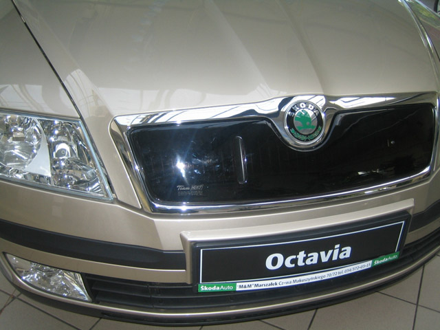

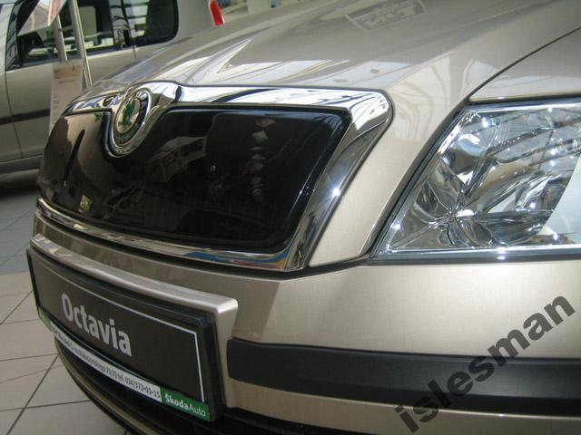

Now we have established this is a fact not a fault, Whats the best method to block the front grill a bit and would it help or do any damage?
There was a huge thread on blocking the grill last winter.
Opinions were divided but a good portion of posts seemed to think that blocking the grill was pointless as the thermostat regulates the engine temperature and simply compensates for the differences in airflow offered by blocking off part or all of the airflow...
Hmmm, not sure that it does, if it did the temp gauge wouldn't plummet with the heaters up or 'coasting' along with no load (ie pulling off a motorway and going down the slip road....last year mine literally went from 90 to about 50). I think an experiment is in order with working out the average time to get to 90 say over a week with no heater on and then block off the grill and do the same. This will only be accurate though if the average temp is the same....but i think this time of year it should be pretty steady... :giggle:
