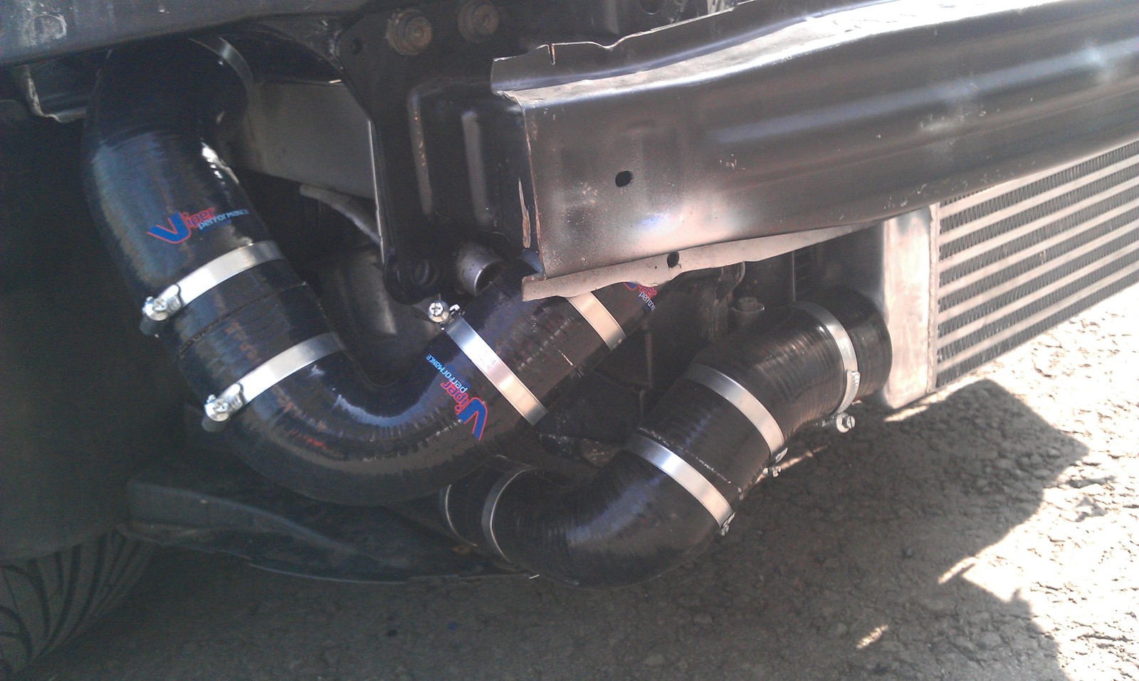

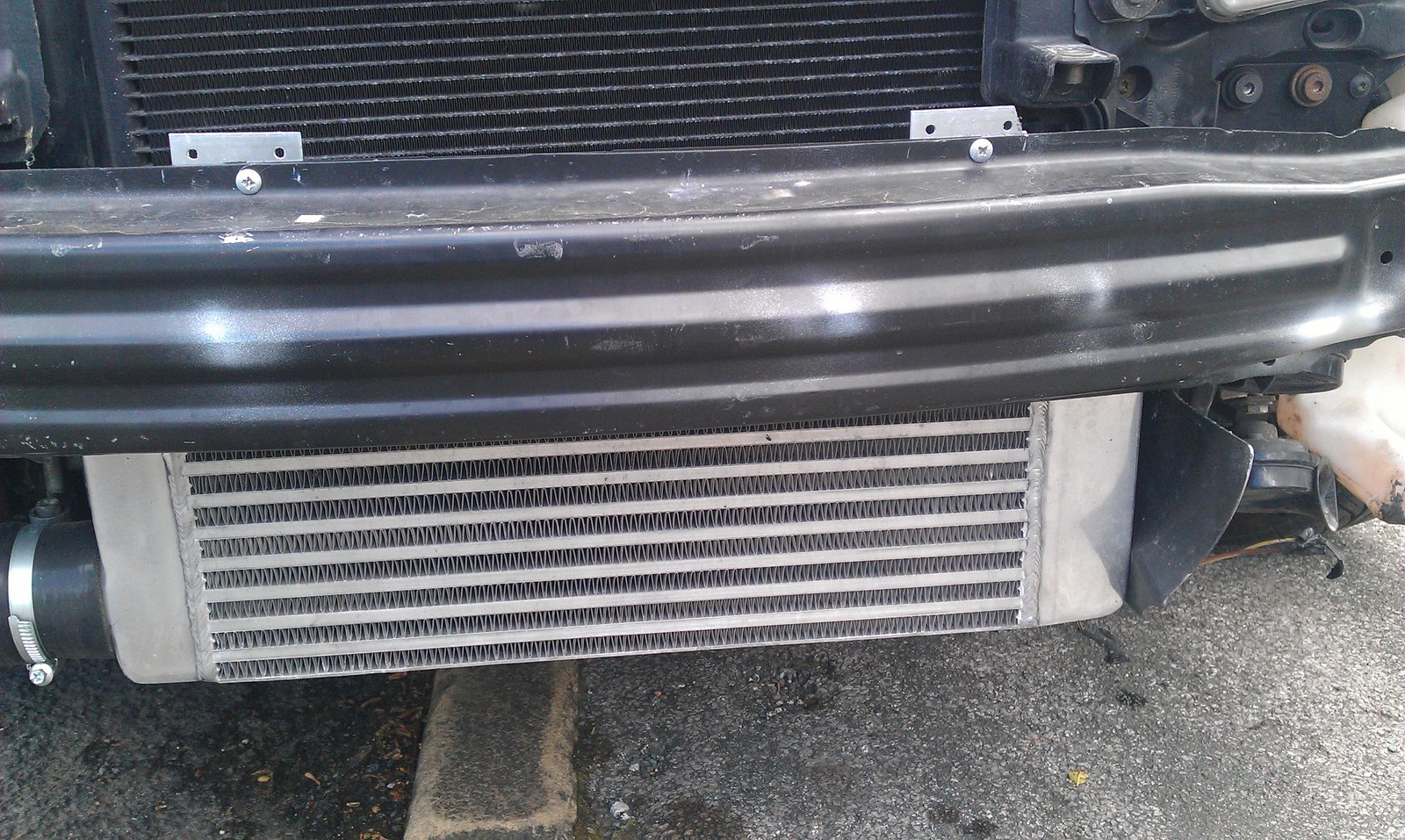

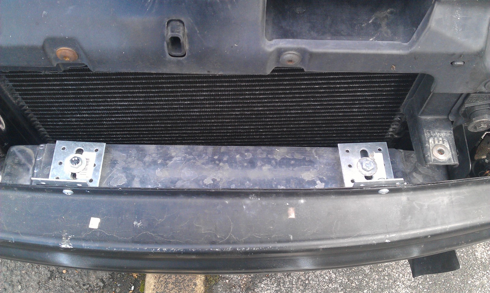

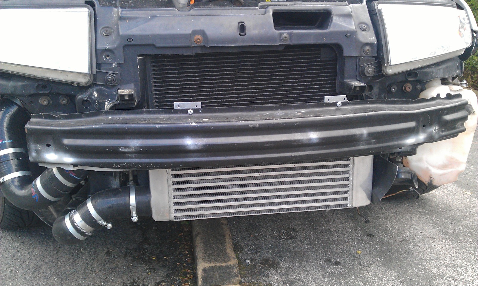

A slightly more involved installation. Thanks to Rick_B for sharing the details of his installation.
This is a big twin pass, dimensions approx. 640x300x75. This will not fit without mods. Maximum space between the aircon condensor and the bumper bar is usually in the region of 45-50mm!
- Bumper bar spaced forward to increase space.
- rad/Aircon condensor pack moved back on the offside to increase space.
- Bottom of bumper trimmed as it was deflected by the bottom i/c hose.
For some reason the bumper bar is missing an end. This is a mystery and "came like that". Other bits might need to be trimmed or re-arranged in the engine bay to accomodate relocating the rad pack - e.g. Alternator and/or fan shrouds.

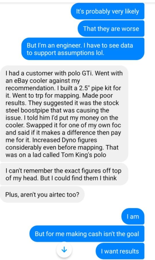

Looks like it will do, but you’ll have to buy the pipes and coupling separately as this is the ‘cooler only?
matt lane at HEX8 Automotive  who did my remap he sed it be no good still have heat soak
i quote
It's up to you. I spoke to another friend who says they still have heat soak issues just yesterday
plus if it doesnt fit right and the garage got to spend hours doing it prob worth me spending the extra £230.00 pounds
money tight
