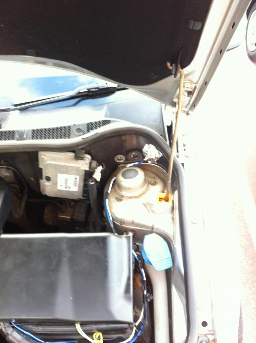

Ok The Gromit Is Located Behind Where The Metal Tape Is On The Right

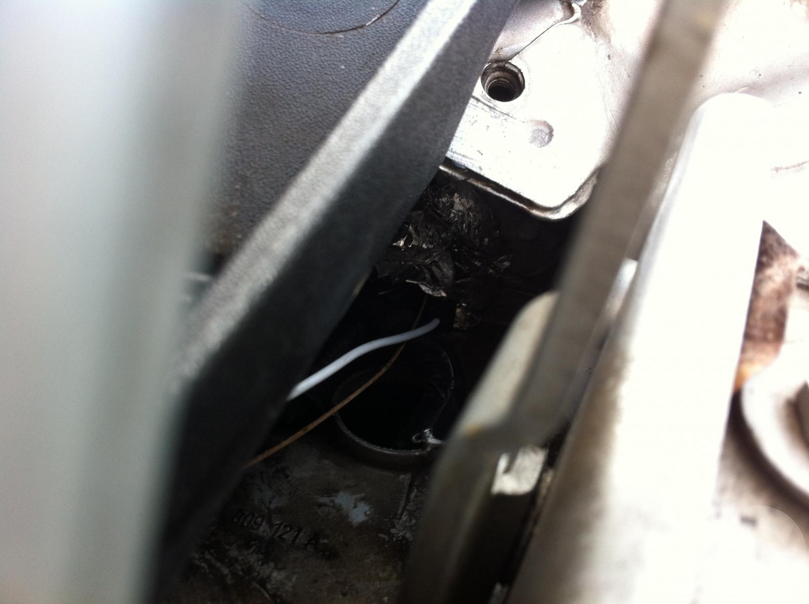

A Close Up
Cheers dude i have replaced tht grommet as cut a hole in it but hole no longer required took scuttle off pollen filter out etc wasn't tht bad pollen filter bone dry puzzled very puzzled
B) The rear washer pipe goes through that side of the bulkhead so it could be damaged on the inside, or the common fault is the leaking door cards on the fabia. cheers - Stuart
