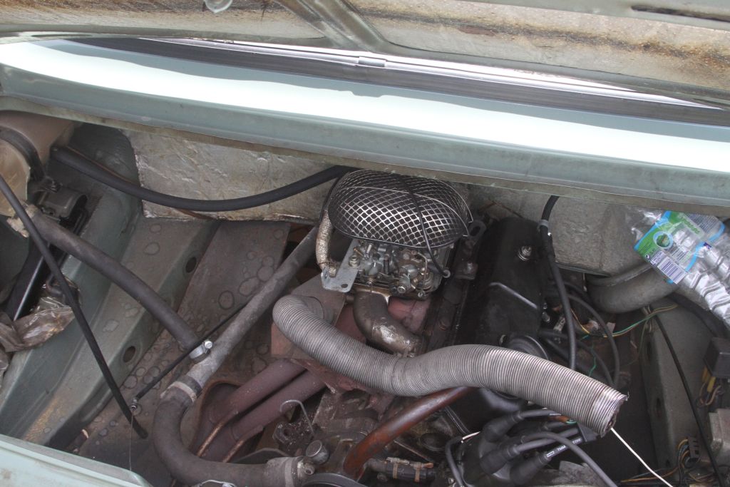

So, it's looking a little better now...
But maybe a stupid question... what do I do with the two air hoses left over?
I'm guessing I can dismount the grey one completely, but the red one?
Edited by buffalox
The grey one's a pre-heater hose that you've done away with by fitting the pancake filter, so yes that can go, but leave the plate on the exhaust manifold, because that acts as a heat shield.
The red one I'm not sure about; I suspect it's a breather hose, in which case best practice would be to redirect it into a catch can, or put a filter on the end of it (or on the stub in the rocker cover).
Yes its the engine breather - it normally recirculates the engine crank case fumes back through the airfilter and into the engine. You need to route it into a catch tank with a longer piece of pipe, it will put out mist or possibly acrid fumes depending on how worn your engine is. On my set up I have it routed into the side part of the engine bay with an oil can to catch what comes out.
