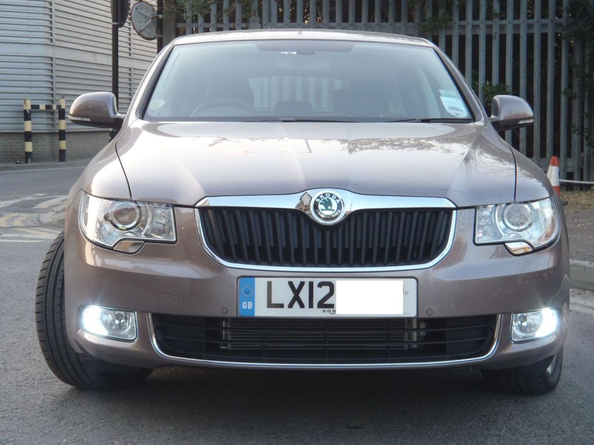

Result, with no lamp errors showing on the dash-
Nearside is the LED! As can be seen it's much whiter than the standard lamp (even makes the fluorescent light in the garage look yellow) :thumbup:

Due to language problems, I need to have this more explained :)
The DRL lights, is that the light to the left, or to the right on this picture?
From your picture, it looks like you have replaced the "bulb" to the right on the picture below? Is that right?
No! The DRL bulbs are the outer most ones (the inner ones are the front fog lights) - see attached photo (stolen from elsewhere on here!)

Done mine yesterday with LED's from the first post. Much better than the ordinary bulbspost-87492-0-74443000-1332962709_thumb.jpg
Edited by jozisko
They look far better :)
