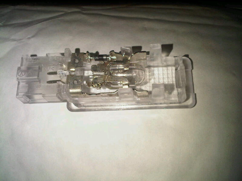

I tried (and failed) to change the filament bulbs for LEDs into the original housing in the boot. It is a w5w bulb in there, but the mechanism to hold the bulb clamps it in using a live circuit. So if you did put an LED in, it will end up shorting out.
Need to find another use for my fancy LEDs now - tried them in the puddle lights but they're just about 0.5cm too long. Bah.
Can you not just unplug the unit from the loom, swap to led and then plug the live connector back in?
I didn't explain it very well. I'll post a pic tomorrow and hopefully you'll be able to see what I mean.

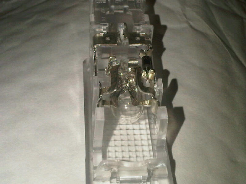

Here you go. These are the innards of the factory bulb holder.
As you can see, the bulb is held in place by an overly elaborate cradle, which itself will form the live circuit once you clip it back into the boot space.
So you are pretty limited to the type of bulb that you can put in there - i.e. a w5w glass bulb, unless you are able to isolate all exposed circuitry on your LED. Otherwise it will just short out over the first speed bump.

I'll have another go with mine. They are 15 5050 SMDs, very similar to NoWaiting's picture of 18 SMDs. It's all the circuitry on the back that I'm worried about shorting out. And they weren't exactly cheap to buy...
I should have been braver. The LEDs fit inside like a glove. The metal clamps onto the bulb contacts and there is no play. Light is white (not blue, not yellow) and much brighter than the standard bulbs. Makes the yellow of the torch look a little out of place.

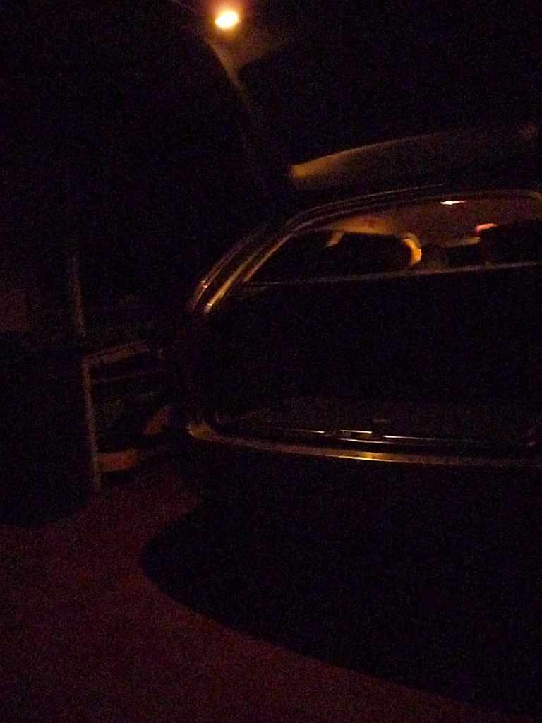

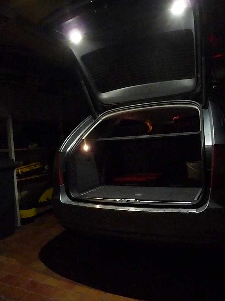

Already two years ago I upgraded my boot light with these LED's:
http://www.hypercolor.de/Kofferraumklappe-LED-Lampe-fuer-Superb-3T-Kombi
And they've worked perfectly since. They give so much light, you can easily read a book (or newspaper) in the boot now. It's really perfect when you're looking for something in the otherwise dark boot.
Only disadvantage: The PCB was a little too big to fit inside the light housing, so I had to grind away some material (of the PCB, the light housing is still original).
Here are some pictures:
And a picture of the stock lights (for comparison):
