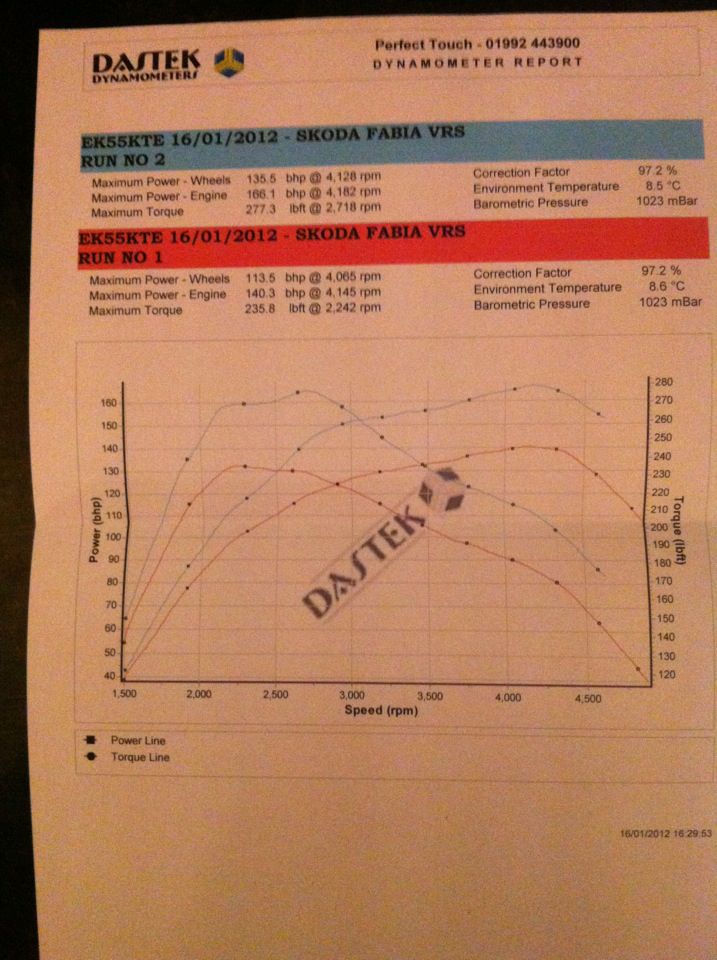

Heres my remap graph for before and after

It made 151bhp before remap,the rollers I used are fairly accurate if anything slightly harsh on the readings.
A stock focus rs made a few bhp less than book figures on it the same day, which was a rather cool november.

Mine is a BLT engine so as you say in it's standard form made more than than what is quoted

As I said on this particular day it was a cold Novembers morning so this will of helped things out. The RS was only around a month old so was still running in so this is why the figures was down.
The rollers however as I stated are fairly accurate, both my before and after figure's was done in similar conditions within a week of each other on the same rolling road, the same rolling road I have always have and will use due to the variations on different one's so that I know the 'true' power increase (and I use the word true loosely as you have stated several factors can influence the results)
I have however been noticing the car lacking power these last few day's due to heat soak, so a FMIC is soon on the cards.
