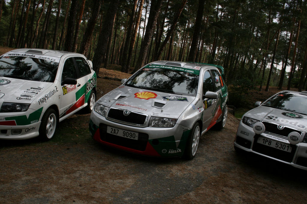

There was a very nice 4x4 Fabia in CZ that we saw at a Dorsky meet,
I belive Jason (Devonutopia) had a go in it, also has some very cool rotating No. plates on it.
Not sure if the guy ever came on here.
Think this was it,
Crazy!
Think this was it,
Yes, that's the one. It's pretty cool.
But for me it's too smokey when used as it should be. Plus I can't realistically get the bhp I want from a 1.9 diesel.
So I'm probably going to need a well tuned 1.8T or a 2.0 TSI/TFSI. (will also keep the nose weight down)
The steering wheel is also on the wrong side, the same issue all the WRC/Rallycross Fabias that come with 4x4 suffer with.
Could be wrong, but I'm not sure there actually is a 4x4 Fabia with RHD. ??
