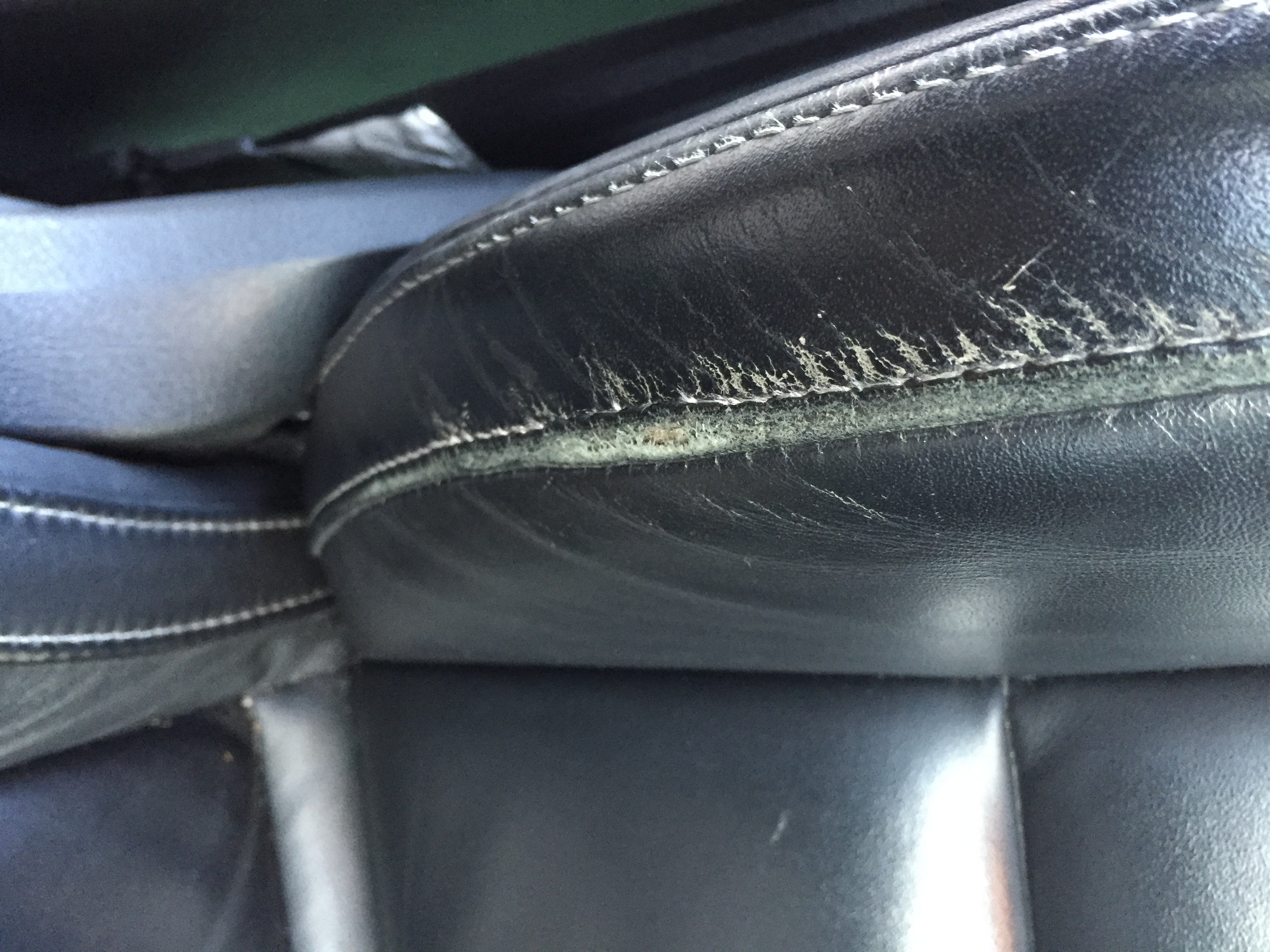

FYI when the driver's seat stitching starts to fail (see photo) you'll need to start thinking about replacing that seat panel. Its an airbag seam so will need certifying by a ....err.... certifier. Cost here in NZ was $600NZ (350 GBP) so not cheap.
Well worth factoring in if you are buying a second hand car with worn seats.
