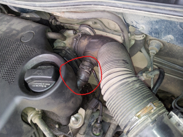

I've waited 3 hours to upload the photo off my phone but the connection is just dead tonight so that'll wait till tomorrow.
But basically should that big pipe connect directly to the engine through that little side pipe? and is this the right one and obviously do I need to buy all that?
And would that be enough to turn my oil into mayo? in passing

The offending part
I'm assuming that's some kind of crankcase breather pipe that recirculates oil vapour back into the inlet but I don't really know the 1.6 engine at all so can't be sure. You might be able to find photos of the same engine on Google to compare it to?
That's what my mechanic said but it is now appearing that little lad is part of the big pipe. The Ebay link I gave shows a picture of the original (big) pipe, and it does look like my arrangement is just a piece of rubber clipped over a broken part? That wouldn't be good, lol
The MAF is to the right end of that pipe, and the air filter to the right of that again (bottom right of the photo, top right of the car as you stand in front of it). The throttle to the left end of the pipe obviously. This model has no MAP sensor as it turns out. (and only one Lambda sensor)
Thing is the Ebay guys are very expensive and I have had no luck googling under the words "air pipe/air hose"
Is it what you also call the breather pipe then? I haven't been able to find a pic of a mk1 to go with the words "breather pipe" (let alone my model which is the rarest), but I've found a guy who sells them cheaper
Also, if all else fails, is it the sort of pipe that I could buy off the breaker secondhand?
