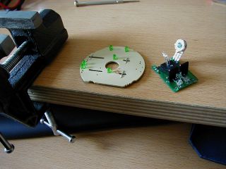

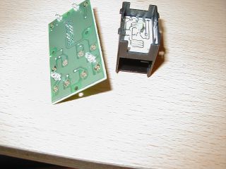

It was a sunny afternoon and I was booooored! So I decided that it's time to finally do something with that green illumination. I first started with the windows switches, then the main light switch and finally I had one LED left so I took apart the rear window heater switch (which proved to be a pain in the a**!).
The switches:
Switches meets screwdrivers :)
How it used to be - direct comparison - how it is
Let there be light! Blue light, that is :)
You can change the illumination on all switches simply by replacing the LEDs (resistors are already there). However, take care when changing the LEDs on the switches above the headunit because the original LEDs work off 12V directly (!!) and you need to add a 1K resistor in series with new LEDs so they don't blow up! This happened to me -> a nice smelly gray smoke coming out from the switch :eek: I used a total of 14 LEDs (blue, 3mm, 60mcd) and one red LED. This number can vary depending on the number of additional switches.

I got it from a croatian electronics store :)
They are from Kingbright, code L934MBTL

Would be great to source LEDs with built-in resistors though like the original ones, which would make life a lot easier :)
Most of the switches already have resistors. Exceptions are those found above headunit.
