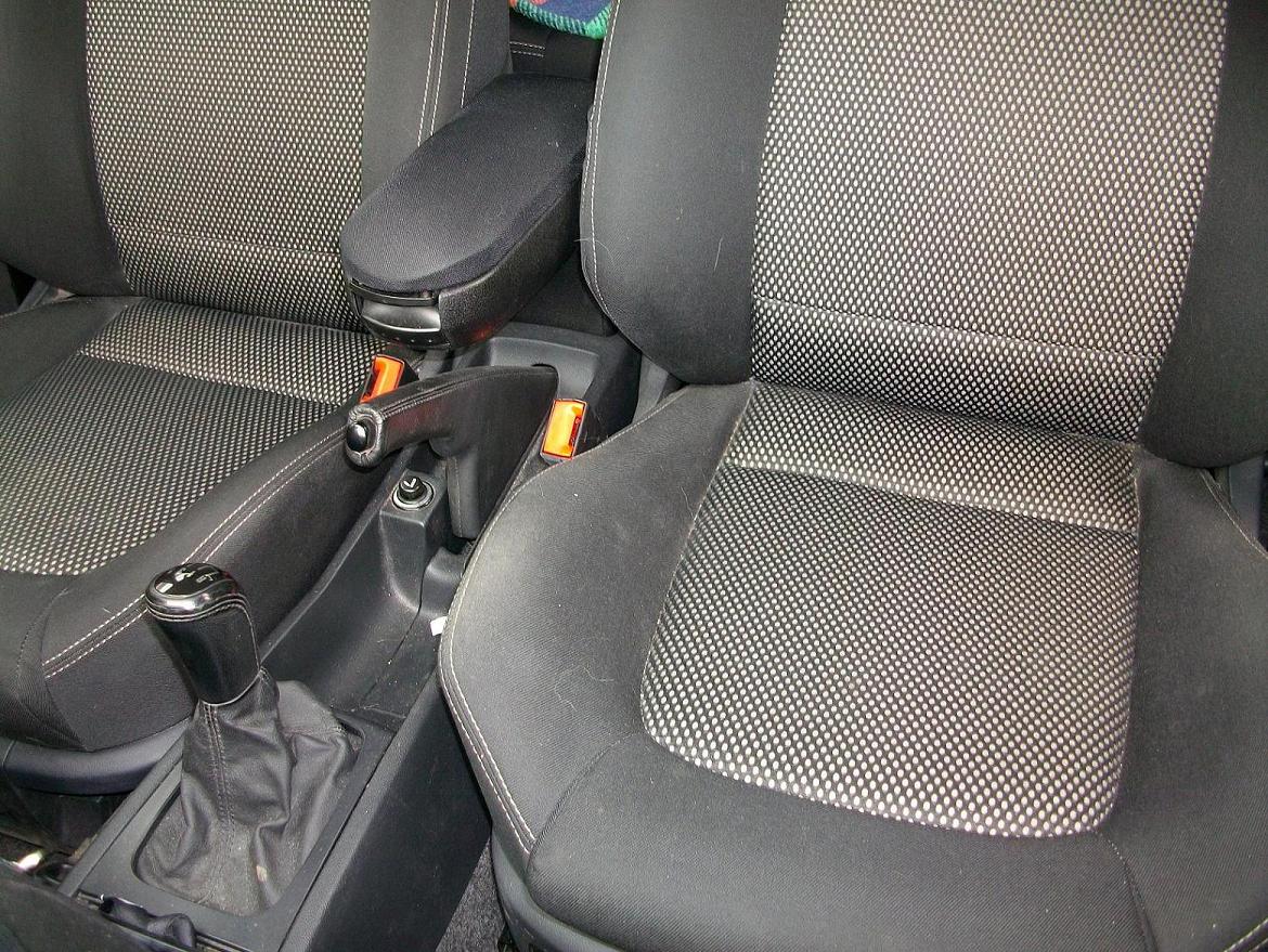

Here is my Mk 4 Golf copy armrest - cost EURO 20.10 just over 2 months ago, (probably = approx. 50 pence in £ sterling today :wall:
It is a HK copy but matches my sport interior perfectly. I won’t put the link to the bloke I got it off as it took him about 7 weeks to get it to me from Bundesbank headquarters, after I kept reminding him how much closer Germany is to the good old Emerald Isle than China. The bracket was wrong, but that didn't matter as I was going to modify it anyway, but I wouldn't have been at all pleased if I'd bought for fitting into a Golf!
Some of the lads on here have used self tappers to the front and rear in line with the centre console to attach it. What I did was modified the bracket so that 3 bolts go up from the cup holder into the base of the armrest with a metal bracket under (fabricated) and on top (supplied bracket modified) of the console, with the top bracket also extending to the hole on the side of the armrest where it would also attach as an OEM fitment. I also made the top bracket thicker so the armrest sits a bit higher up.

Thanks for the long winded about the armrest! Imgonna check the scrappies for one later!
