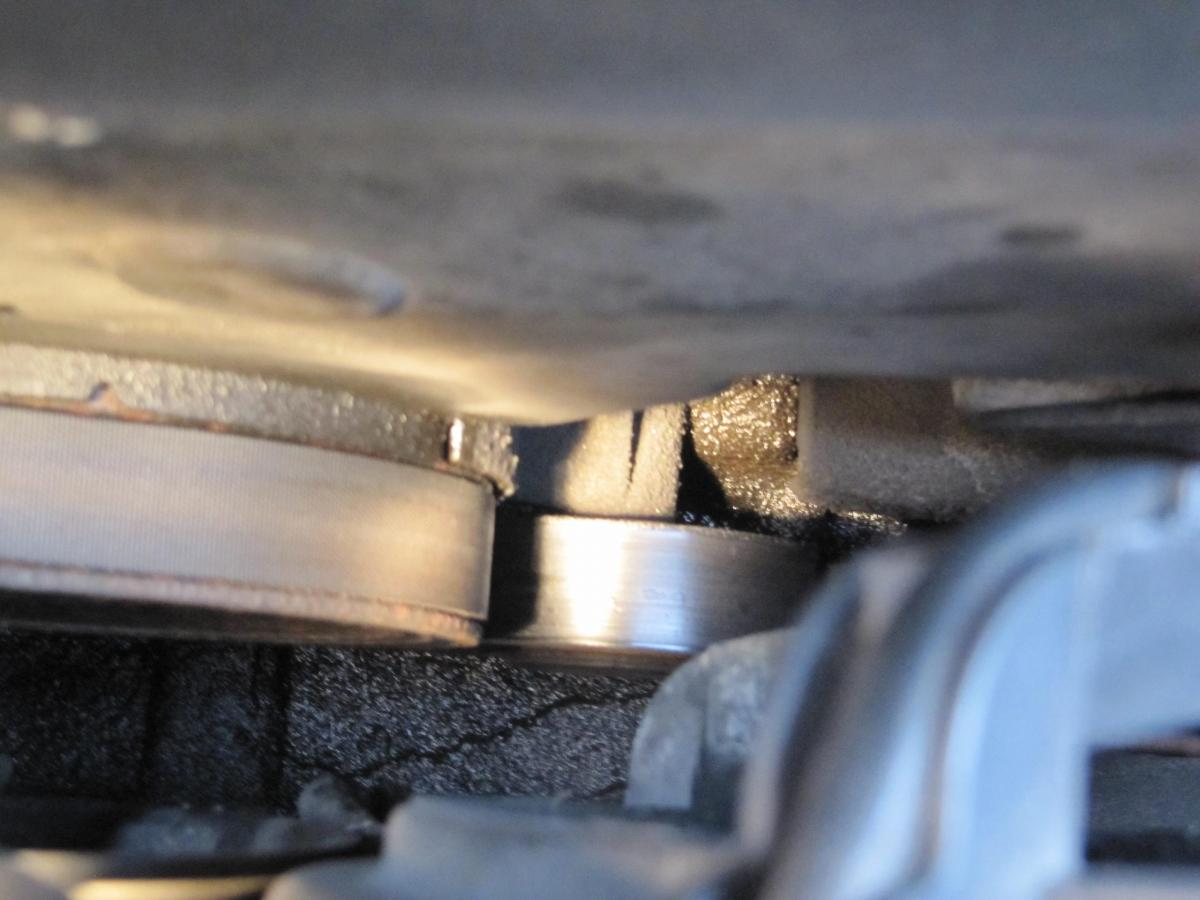

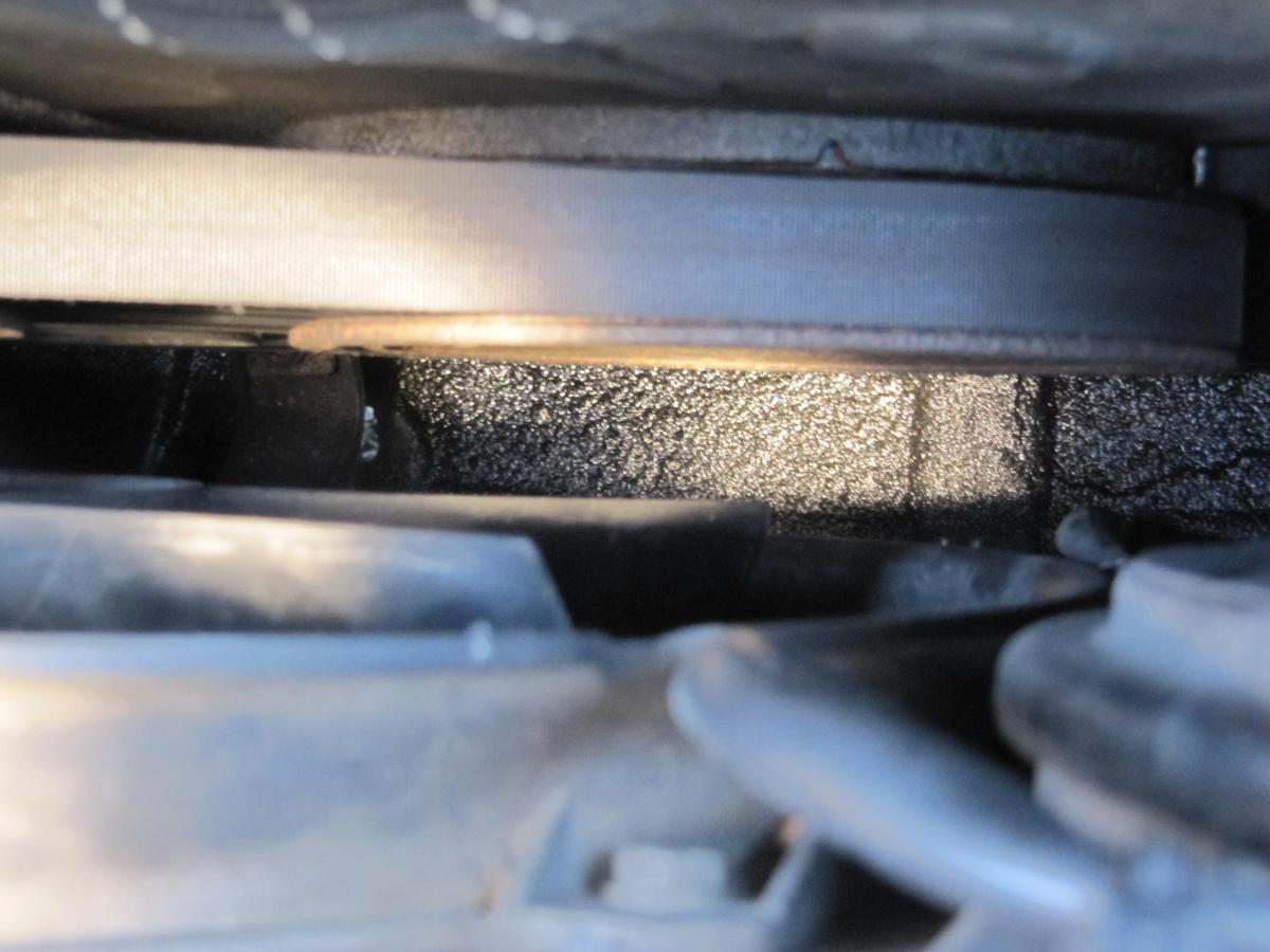

So I removed both engine covers, and grabbed a torch, and looked round trying to work out where nearly 1 litre of oil has gone in around 300 miles. Checked all the gaskets and they are all bone dry, but when I shined the torch down the front of the engine there is oil everywhere. The source is not the oil cooler as thats mounted on the opposite side of the engine to where the oil is pooling and it was replaced 30K ago anyway by a main Audi dealer.
Below are a couple of pictures, I have emailed these to a VAG specialist for an opinion but it does not look good. Could be the crankshaft oil seal I guess, and thats a mega job due to the labour involved to take it apart and re-assemble.

Right the verdict is in.
I had an ex Audi mechanic look at the car this evening, he removed the upper cambelt covers and peered down towards the crankshaft his verdict is that it is indeed the crankshaft seal that has failed. Due to the cars mileage, he has suggested not replacing it as the replacement may also leak due to the wear on the Crankshaft although I dont know if this would be the case.. So at the weekend I'll clean as much of the oil off as I can to enable me to monitor how the leak develops.
