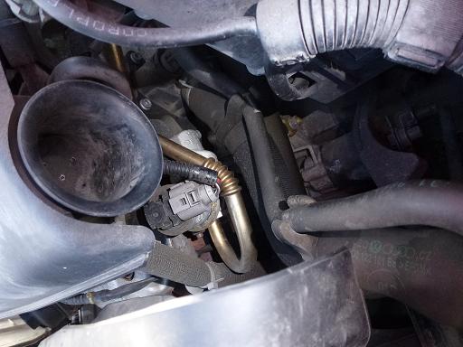

Yes, that's the right valve; it's located under the large square air filter that covers the engine, right hand side front, just behind the radiator. Look for the large round, 2" intake, black pipe on the front corner of this hood and it's just under there; it's attached to a copper coloured pipe. Now here's my problem..........I want to clean this. I have seen many youtube tutorials on how to clean a variety of egr's but none for this particular type.
Edited by tvines

Yep, I had a go a while back. There's a fair bit about it in this thread: http://www.briskoda.net/forums/topic/235977-wideband-lambda-on-12-12v-azq-egr-valve-in-the-end/
Petrol engine EGRs don't get nearly as mucky as diesel ones though, so 'cloggedupness' is unlikely to be the problem. What symptoms are you experiencing?
If you follow one of the links in that thread to a pdf that Pierburg sent round to Techs you'll see that this valve has had some problems in early revisions and/or with early ECU software versions. The very last paragraph of my thread has a couple of diagnostic tips that I believe to be valid.
