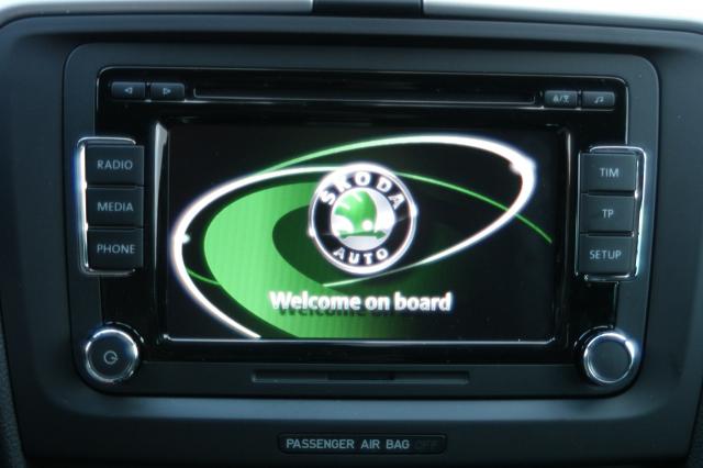

yes thats correct the one i have is the columbus / bolero one
like the bolero below but facia below is the superb i think but these stereos can fit pre face also know as rds 510's
http://img29.xooimage.com/files/f/c/0/dsc00283-193577f.jpg
