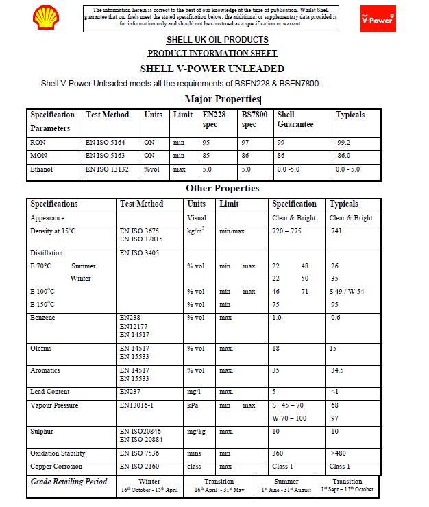

The only difference is in a few of the additives, V Power also contain Ethanol 0.00 - 5.00% to get the higher RON rating just like Tesco.
