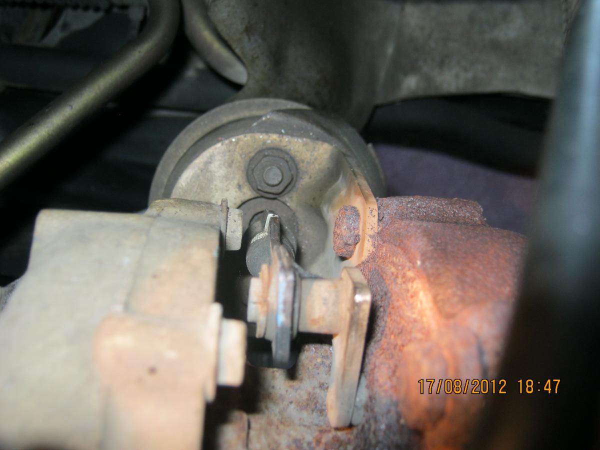

So I've dismantled it, applied Mr Muscle, thanks to Lofty, (about 20 mins ago)
I have a piece of wood to push on the actuator - now at the moment it won't move at all - am I suppose to be pushing downwards on the left or right piece - see photo?
the piece in the middle running up towards camera in line with central nut
Ok thanks Carl, so basically pushing the plunger into the vacuum unit under the turbo then?
