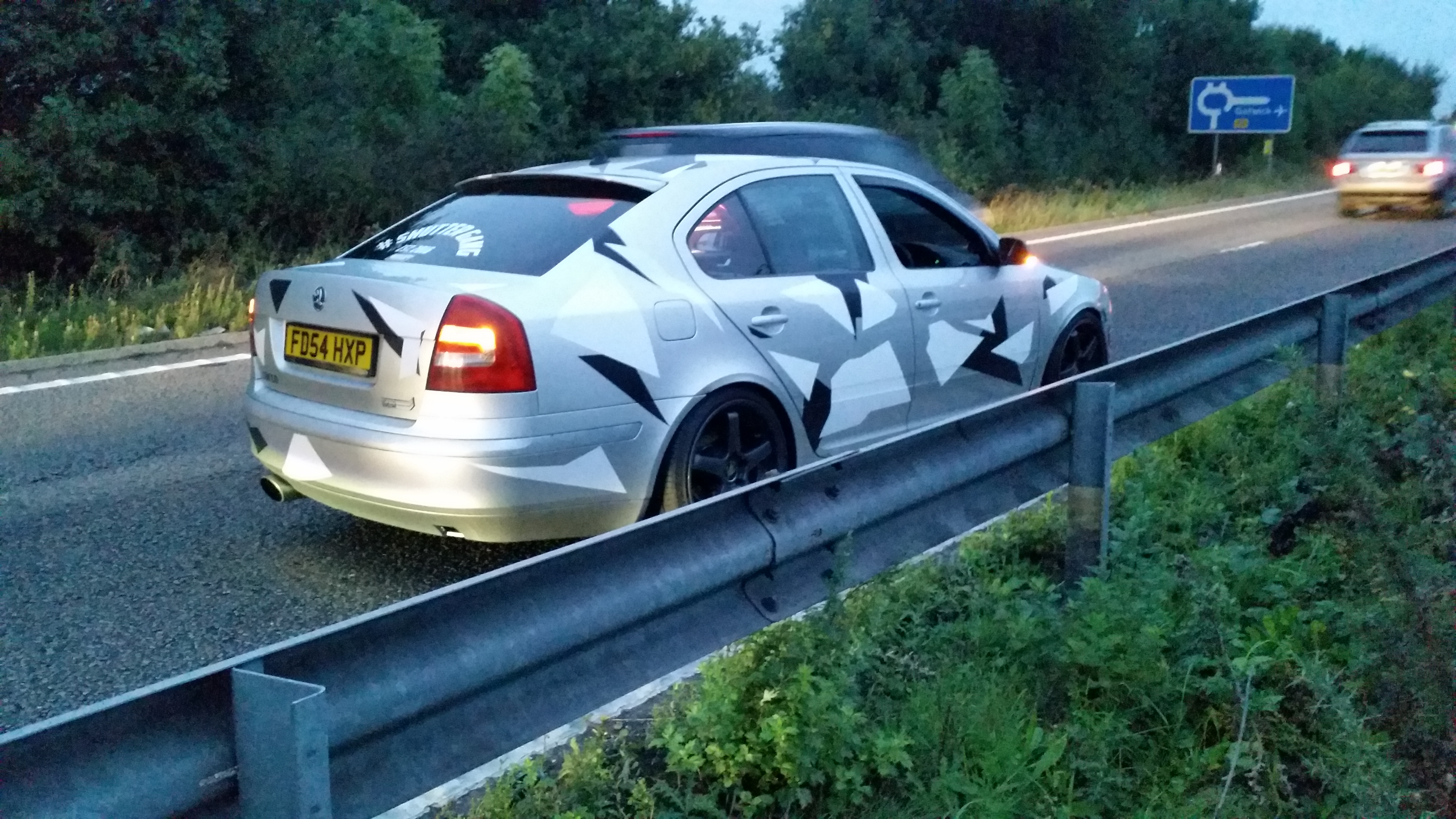

Driving to work Monday morning around 530am. Car starts to run rough. It sounds like an injector has failed. Had it before a few years ago. So I nurse it to work as that's already near enough to get to rather than turn around and head home. Just as I get to the slip road to pull to Gatwick, It dies. Just straight out dead. No warning, Just the battery warning light and nothing more. Try starting, turns and turns and turns. Try again, same thing. So I'm stuck on the slip road, with no where to go. I can't push it by myself, it's up hill and there's no hard shoulder to roll back to. Not that I could roll back anyway with all the traffic backing up. So on the phone to the RAC and about 5 mins later, Traffic officers showed up. Nicely they gave me a tow and put me on the hard shoulder just before Gatwick.

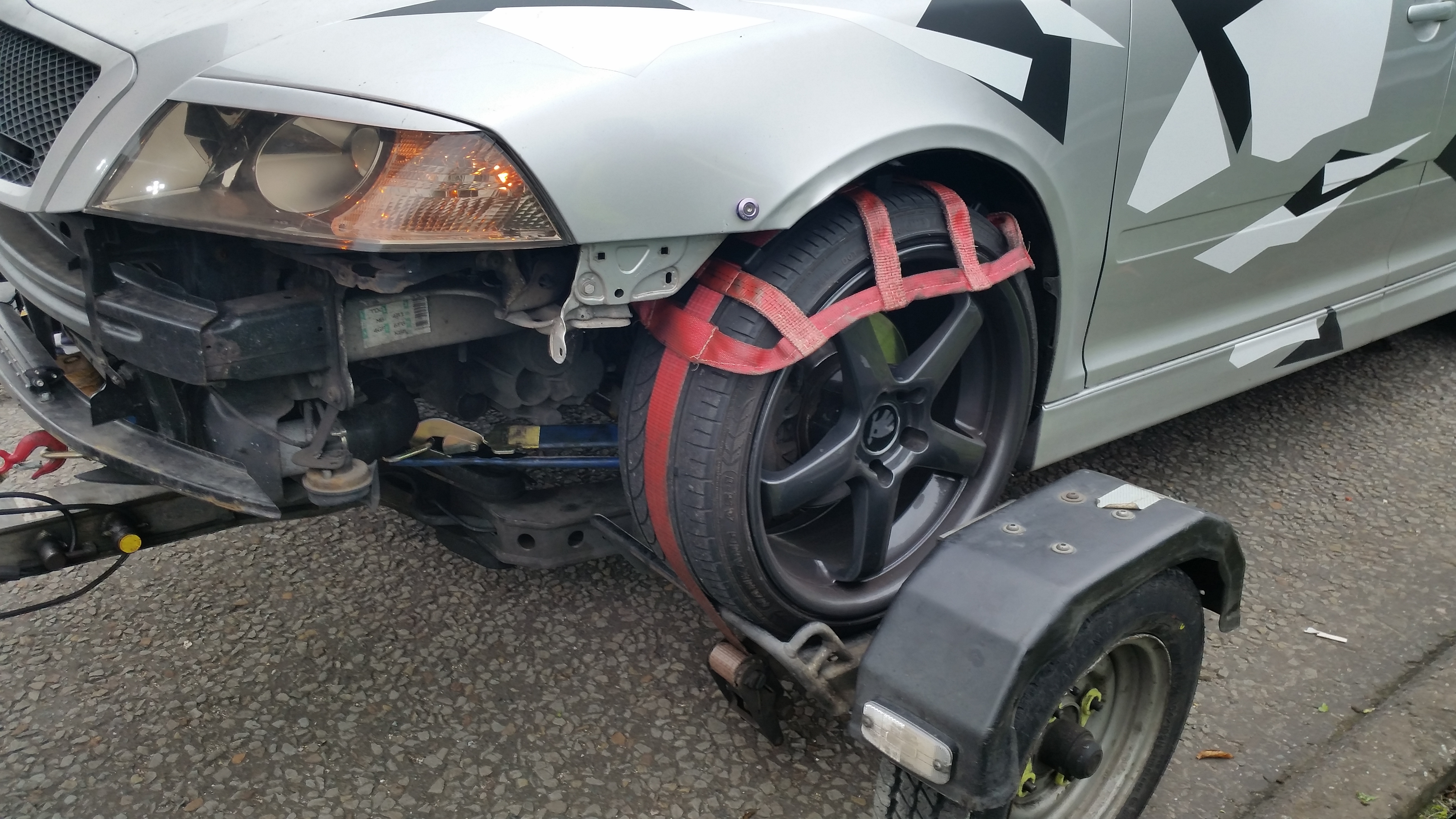

An hour later, the RAC guy came out and spent all of 5 minutes looking at it and did nothing. Then justed called for a third party tow to take me home. Thanks for the help and the positive attitude(!). So spent another hour sitting around. What was more annoying is that I was no less than two miles away from work. Could of walked it, but this is Gatwick. Police soon picked me up as well, checked things were okay and that was that, off they go. Soon, my towing party comes along, jumps out, has a quick look and spots the airlift system in the boot.
"Is that the V2 system?" He's installed a V3 system in a friends car not so long ago, it turns out the guy is quite a petrol head himself. So we're chatting away, getting on quite well. The tow home for the hour and a half blew by I didn't even notice we were talking so much. So the guy gives me a hand to get it back on the drive and then really starts to look over the engine to see whats up. Pulls his own tools out and we're both looking at it. Narrowed it down to the tandem pump. I mention I've replaced this before once a few years back, maybe it's the same thing. Unfortunately, Whilst waiting at the side of the road, I had ordered a set of used injectors and a tandem pump at the lovely cost of about £400 thinking it was that. So anyway : We chat a bit more, hops in his van and off he goes back down south towards Brighton. (Later on, he sends a friend request over on Facebook Haha)
